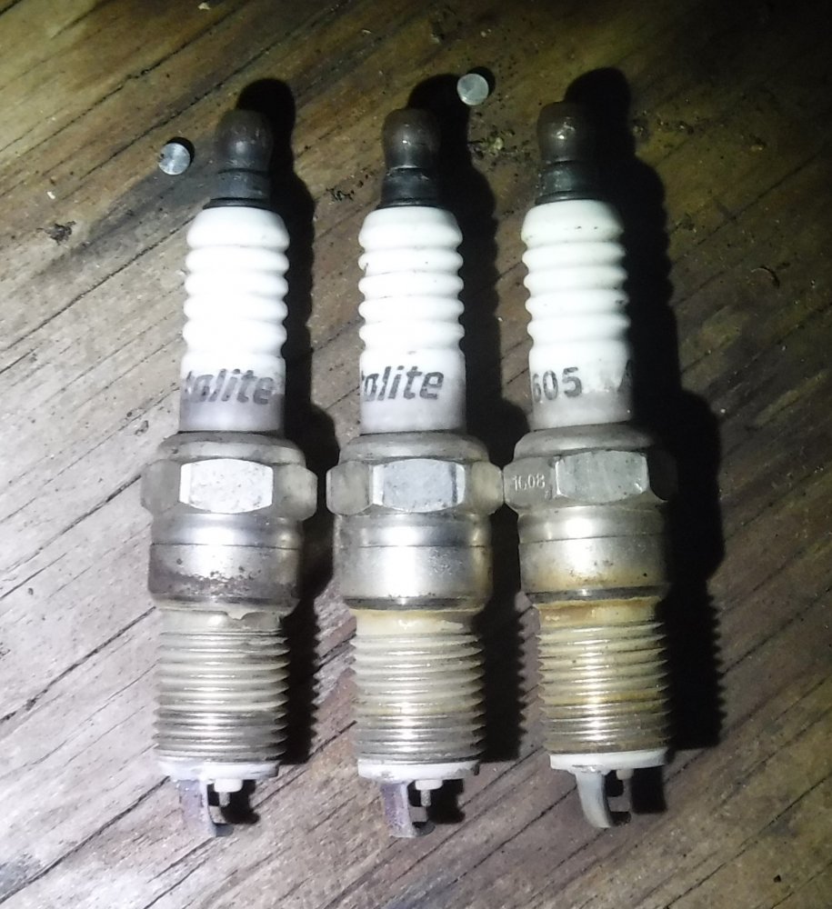

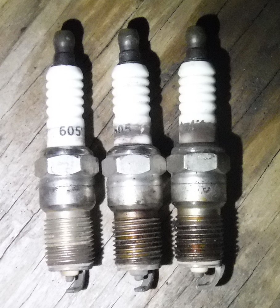

I replaced the plugs earlier but not the wires, was running out of time and wasn't sure I could get those rerouted before it got too late, and here's what I found.
There were Autolites in it, simply marked 605
Left bank back to front
33311
Right bank back to front
33313
Top pic, "drivers side" center(#5?) looks to be running Rich
And maybe #1, lower pic far right, hard to see center ceramic
But over all they look fine, I would just clean, file and re-gap them
I may well just do that then Ron. It wasn't running bad at all, I just wasn't sure what they had in it and wanted to do some preventative upkeep.

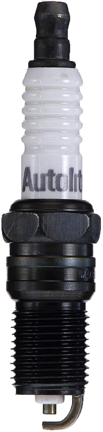

Either way, the SP500 is a nickel coated plug. Somewhere in the last 10 years or so some engineer figured out you can get similar results to a platinum, or double platinum, with nickel, and it costs a lot less to make.

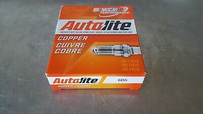

What about these saying simply Autolite 605, no suffix at all? They look almost like a 1960s plug
They are basic copper plugs. Autolites use P (platinum) PP (double platinum) XP (iridium & platinum) and ASP or no prefix for copper.
