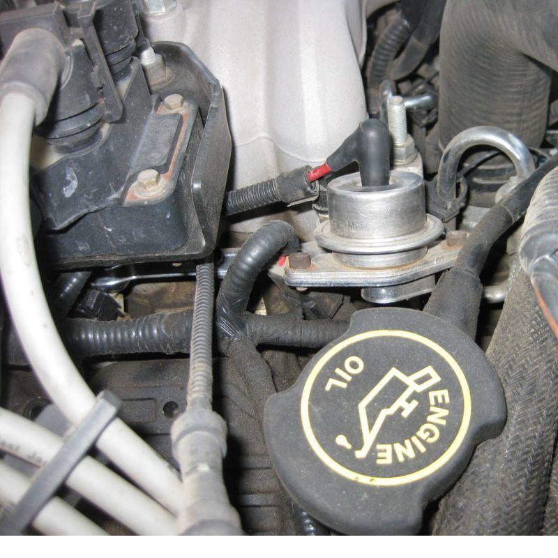

My son's Ranger has developed a problem which causes it to idle very high from a cold start, it shortly settles down, but still idles higher than normal. Also, idle sometimes slows way down and almost dies or will die completely. After that, it occasionally does not want to start. I have read similar posts that discuss cleaning the IAC, so we'll try that. Through trial and error, he found that disconnecting the vacuum line from a component (don't know what it's called) on the passenger side of the motor, on top of the intake manifold, next to the oil fill tube and plugging the vacuum line by hand returns engine to normal idle. I have uploaded a photo. Thanks!

That part is your EGR valve (exhaust gas recirculation valve). I'm guessing it's most likely bad. I would wait until some other people chime in though seeing as that's one thing i have not replaced on my 97 nor had issues out of so i don't know if your symptoms are sign of the valve it's self being bad or if it's something else within that system. Hopefully some more people will chime in here but thought i would atleast tell you what it is to maybe help your research along.
On other vehicles I have owned the EGR could be removed and cleaned. They are usually robust valves as they see exhaust gases. An open EGR will stall the engine at idle and if partially open will induce a vacuum leak into the engine.
You should research the EGR control system for your 95 as it may not be the valve itself, but the system that opens and closes it.
I did some searching around for images of EGRs and Fuel Pressure Regulators (FPR) and I think it looks most like an FPR:

Raw fuel may be leaking through the regulator to that vac line and into the intake. That will give you rich/flooding, stall, no start, poor idle, etc.
We put a code reader on it and got a P1443, EVAP system. That involves a lot of parts. He bought an Evaporative Canister Purge Valve, $72. We installed it, no help. He had to push start the truck. There is another EVAP component in-line with the Purge Valve, a few inches closer to the intake, don't know what it's called. Don't know if replacing that would help? I suppose it could be the computer code is independent of the rough idle/won't start problem. Do we go back to the Fuel Pressure Regulator? If only money were no object, we'd just start replacin' all kinds of parts!......
No, no fuel comes out of the FPR. None from within the vac line either, but I think you're asking about the FPR itself.
