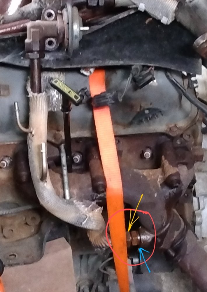

I noticed the egr line has a female end and the manifold has a female hole which came with a plug in it. It seems there would be a double male end connection but when I find a “egr tube connector” and enter my vehicle info, it says not comparable. Also I can’t find new hardware for the exhaust manifold. Any help appreciated
You need the male fitting that screws into the exhaust manifold which also has the a female fitting for the EGR tubing's male fitting.
In the picture, the blue arrow points to the fitting and the yellow arrow points to the EGR tube.
