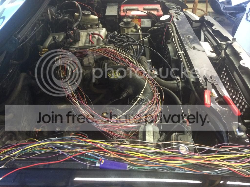

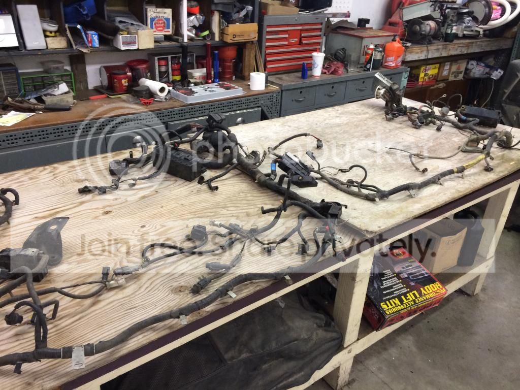

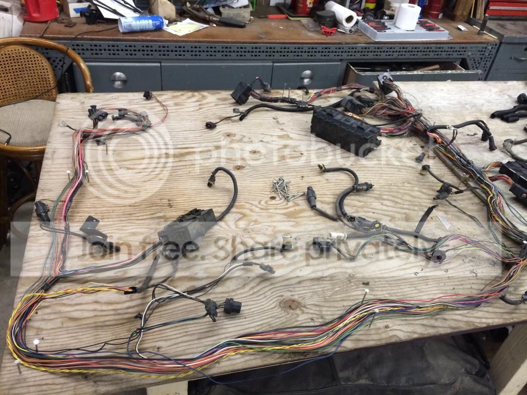

The wiring harnesses were much easier than it appears to be. Once you're in there and cutting it's fairly easy
Then I spent probably 12 hours splicing and adding 3 feet of correct color-coded wire to the engine harness in order to relocate the computer to where the 94 Ranger computer is.
I found out, after cutting the insulation off almost 250 butt connectors, that you can buy just bare butt connectors. I used marine/sealed shrink wrap instead, to keep the bundle smaller

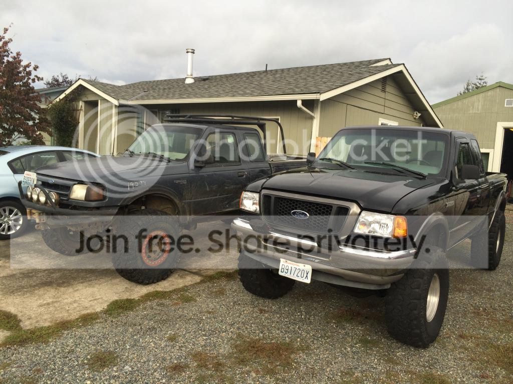

After the body lift, it needed some 35's to look right.
Here's my two Rangers together.
Looking real good man! That front end looks awesome!
