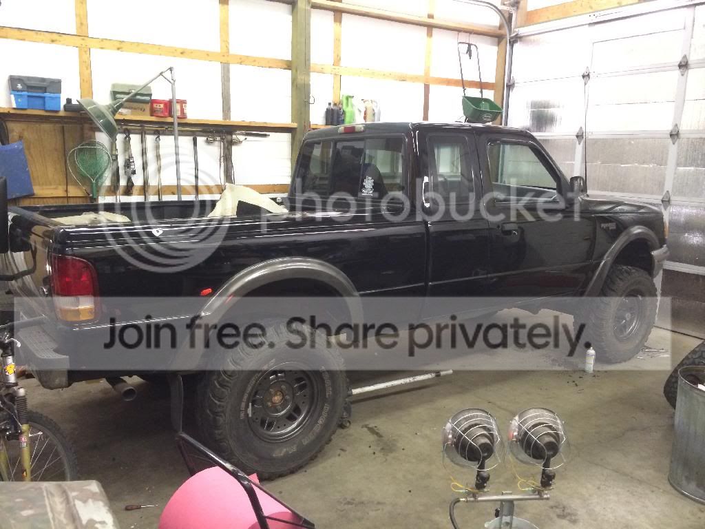

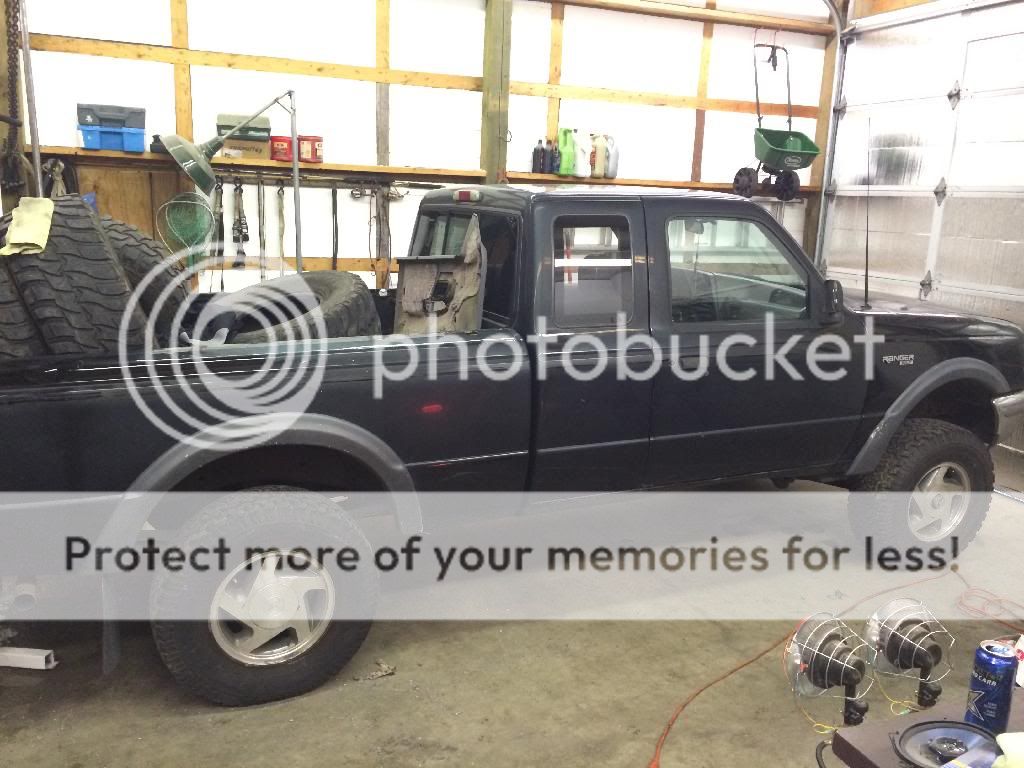

I figure I'll start a thread for this truck, instead of having three build threads in one, in my crew can thread.
It's a 94 4.0l 5spd 4wd with a 4" lift that I picked up for $500.
It started out as an ugly truck, that I was just going to throw a clutch at, clean it up, and sell it.
94 Ranger- 2005+ nose swap, and 5.0l swap

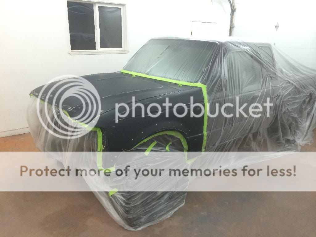

After cleaning it up, I decided it needed the nose painted due to so many rock chips. I also started to like it, and decided to keep this Ranger, and sell my daily driver 3.0l swapped Contour SVT

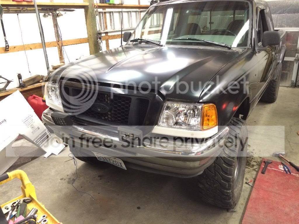

Instead of repairing the sheet metal that was on the truck, which had been painted a few times, I decided to just get new 2005+ sheet metal (it's an 05 grille), and 2006+ tail lights.

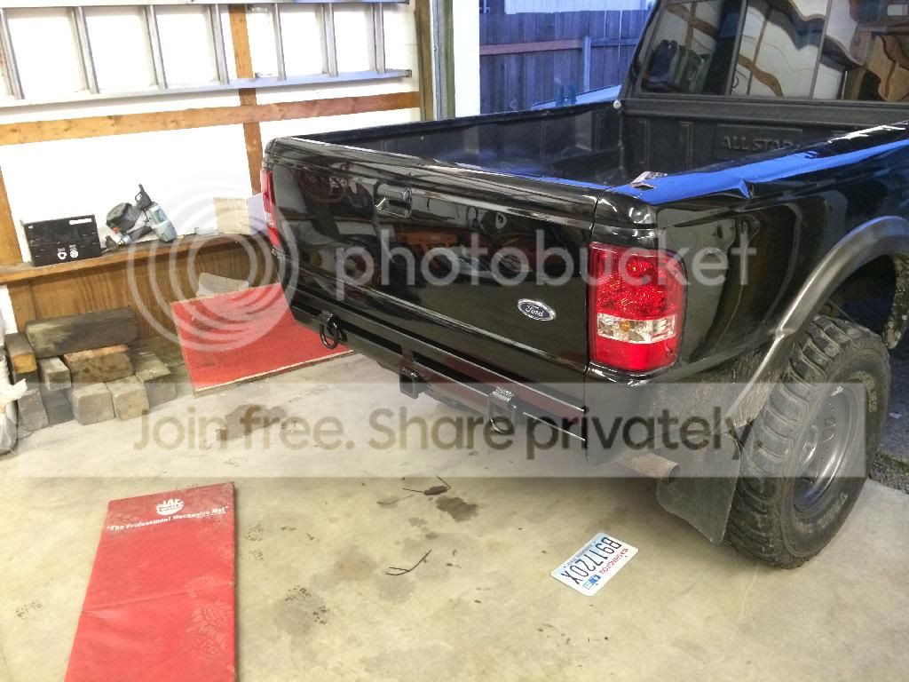

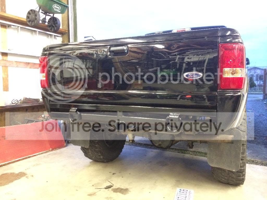

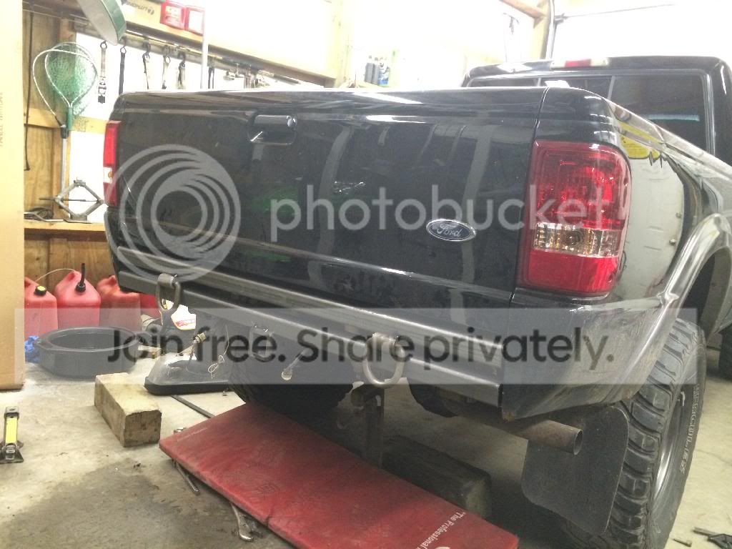

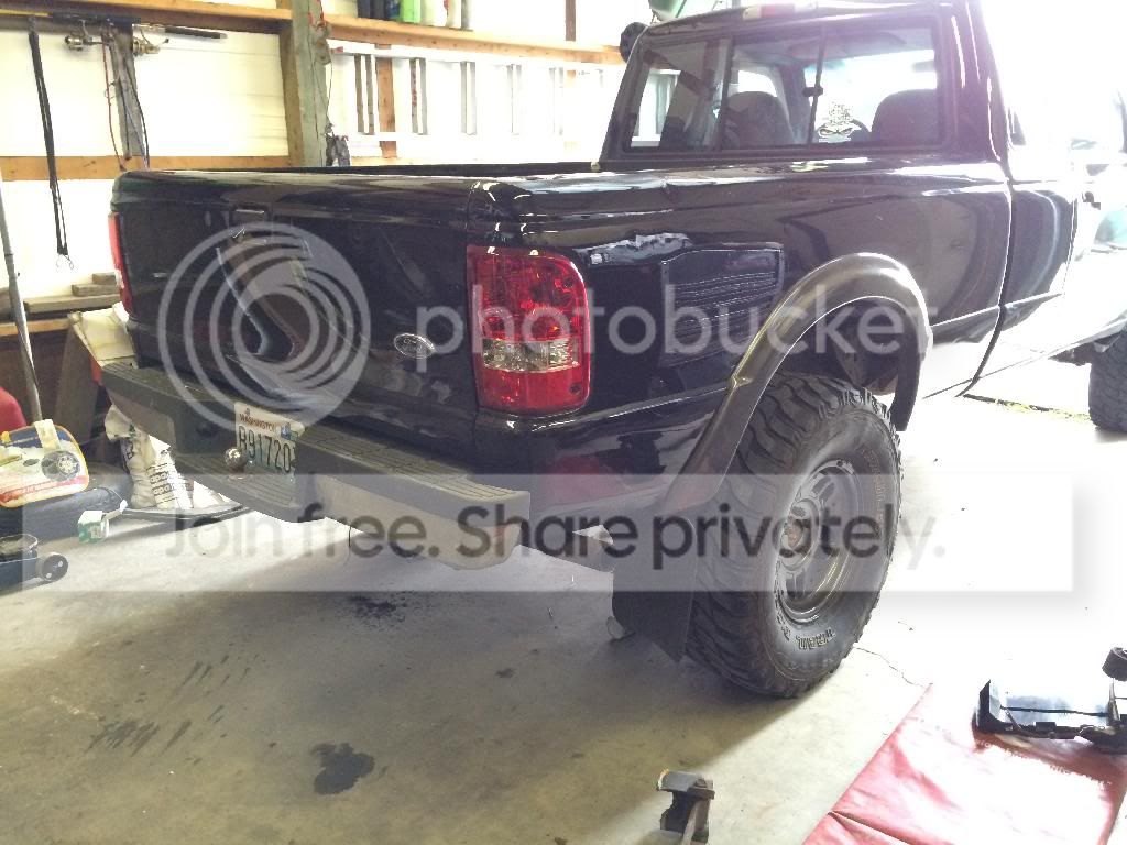

Next came a rear bumper, to help clean up the back of the truck.
I built it to be PLENTY strong as a bumper as well as a hitch. 2 pieces of 1/4" 2" box, and a bunch gussets for the hitch.

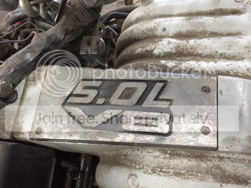

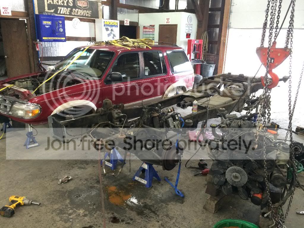

5.0l!!

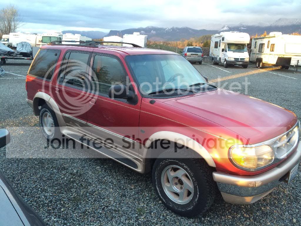

I'm doing the complete explorer running gear for the time being, but I'll be swapping the awd case for a normal case in the future.
I'll also be using all of the Explorer's wiring, and dash. In other words, it will have the newer style dash as well.

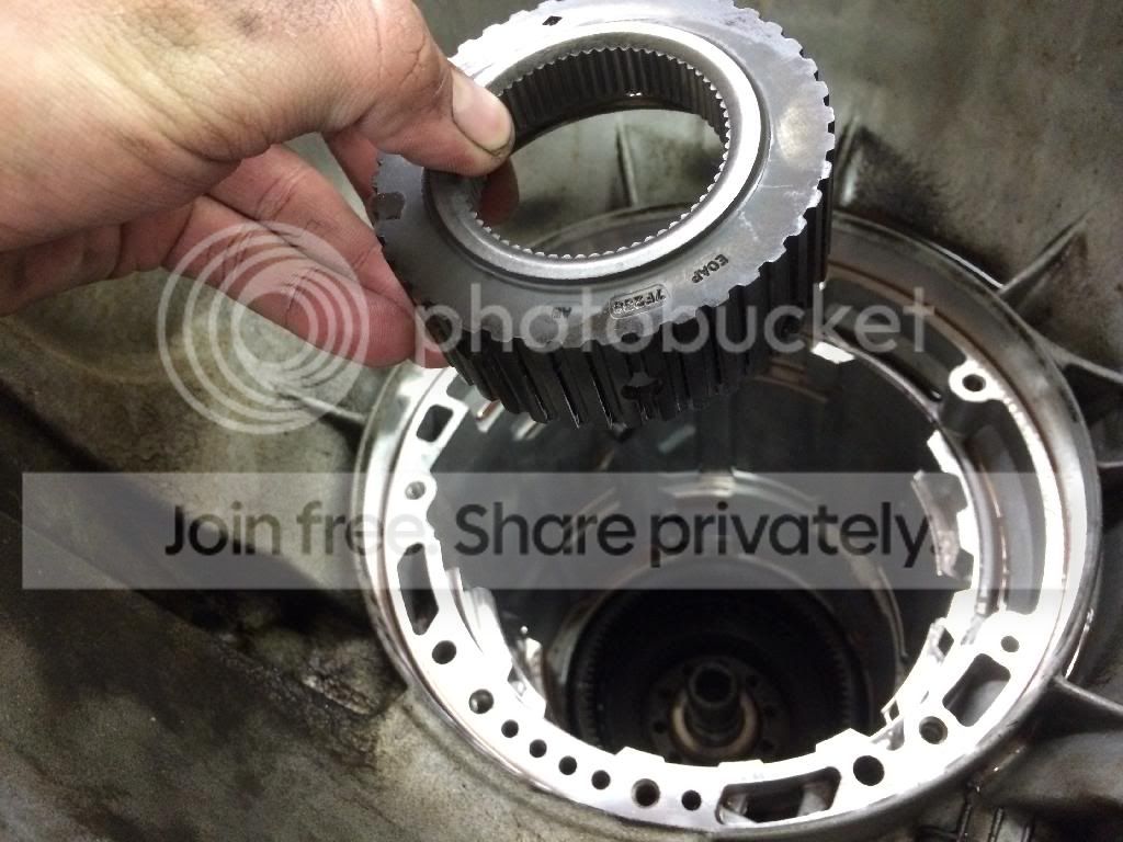

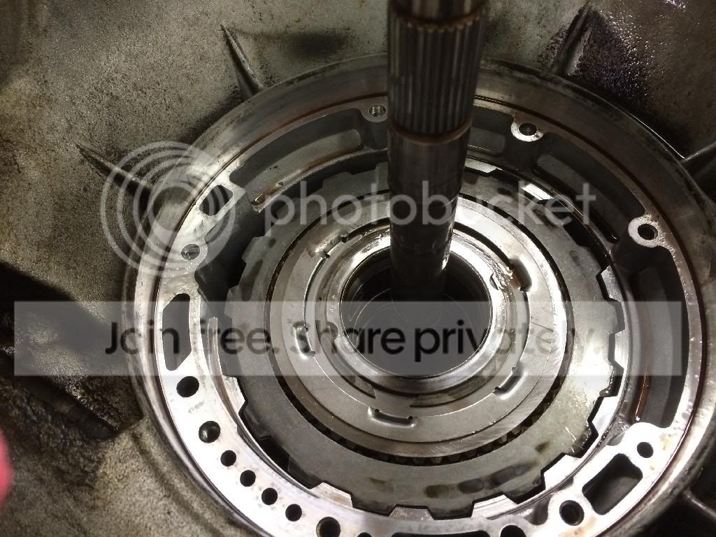

The Explorer's transmission had lost 3rd and 4th, so I'll be rebuilding that myself as well.
It'll be the 5th RBV transmission I've rebuilt, and they're all still going strong, so I'm not worried about attempting a v8 tranny.

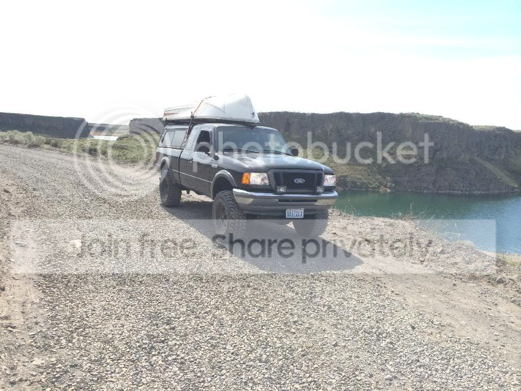

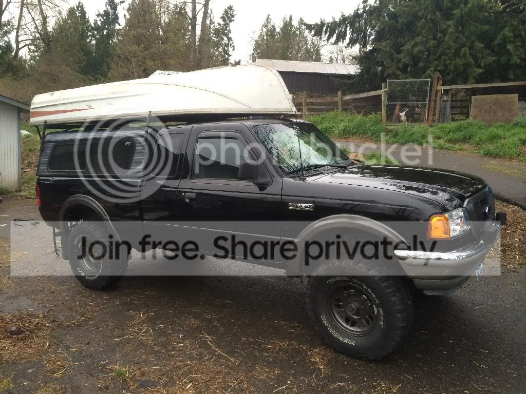

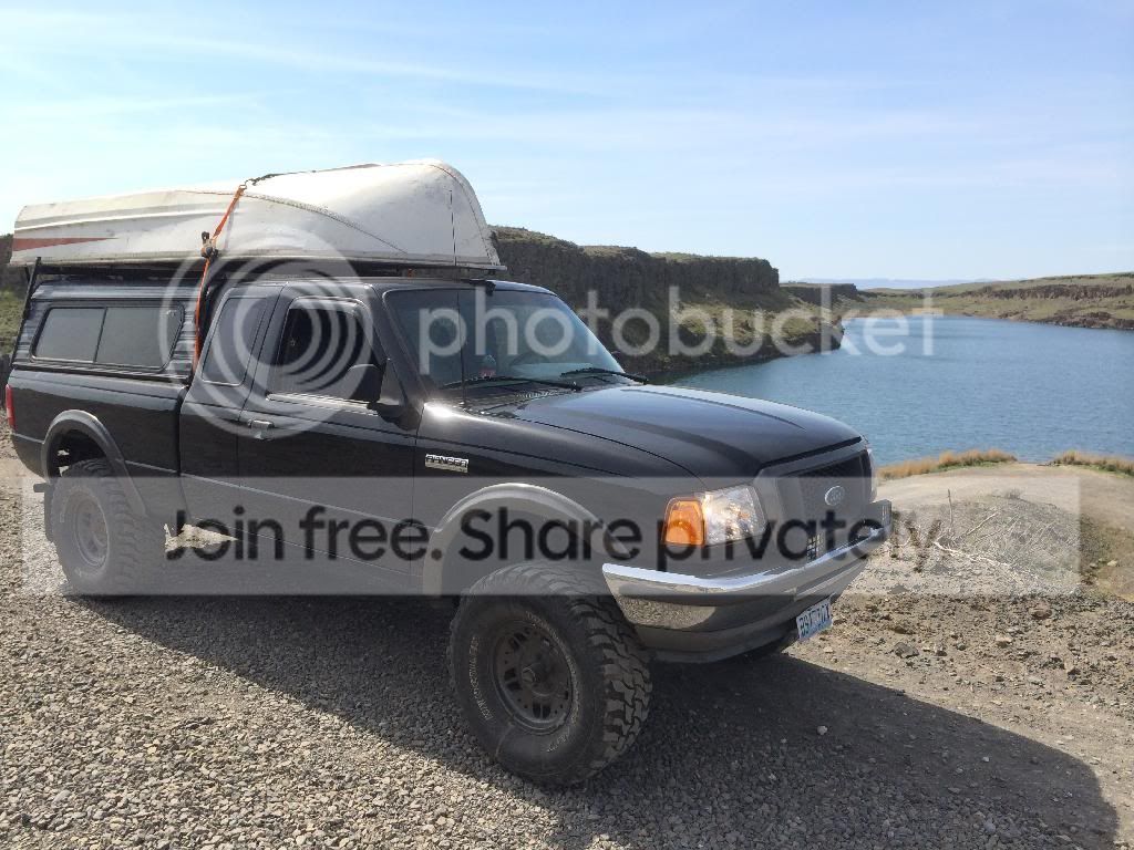

After borrowing a buddy's canopy this past weekend for a camping trip, I've decided the truck would look even better with a fiberglass conopy.
Now the search is on for a cheap, or free canopy, probably a high top, for camping.
nice truck. i like my fiberglass cap. but its only on maybe 2-3 weeks a year
That's how it'll be if I get one. Just throw it on for camping trips and things.
It almost makes me lean towards just snagging the first canopy I can find for free, whether it's fiberglass, or aluminum.

Is that trans a 4R70 or a 5R series?
The tranny is a 4r70w.

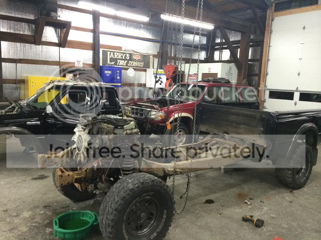

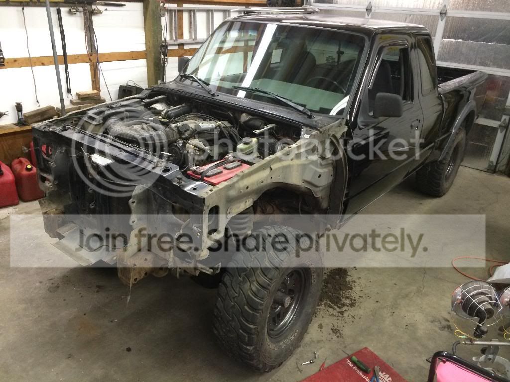

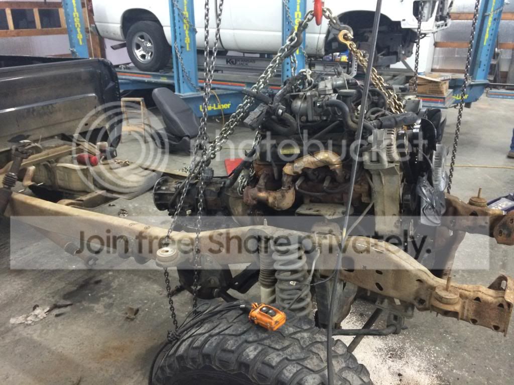

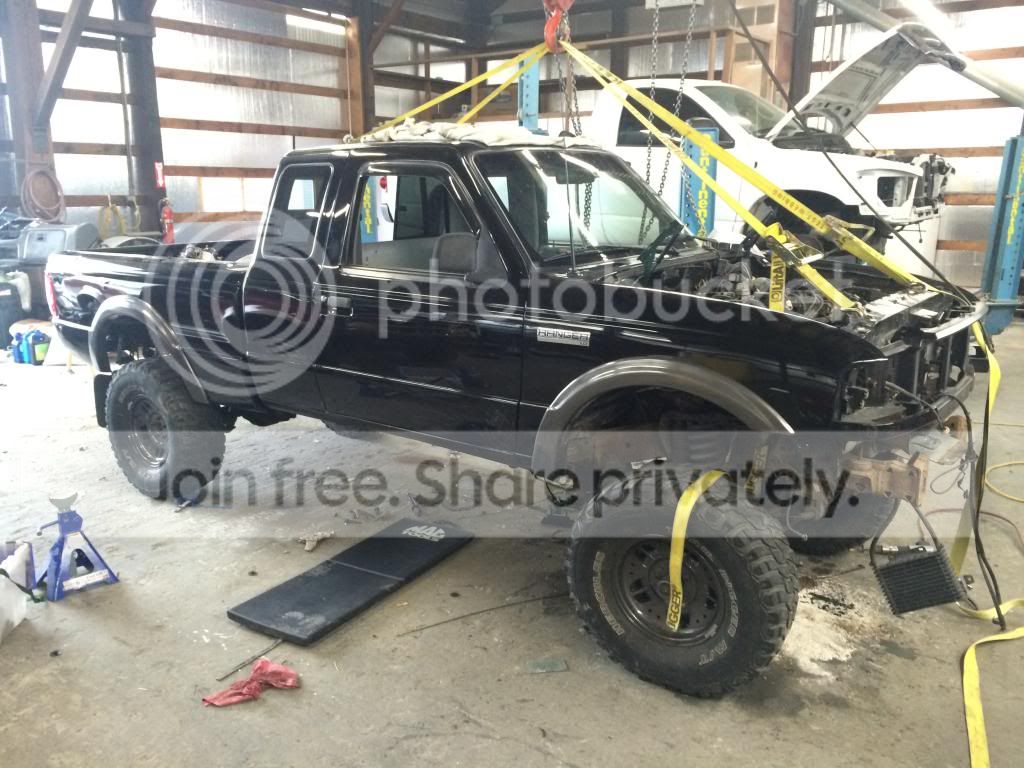

The tranny is now all rebuilt and back together, and the cab is off the Ranger, dash is pulled out, and motor and tranny are out. Tomorrow the 5.0l and tranny should be in the frame, and if I'm lucky, the dash will be swapped, but my hopes aren't too high for the dash going smooth.
I've done a good job of learning how NOT to do a 5.0l swap.
1) get the right oil filter relocation kit.
2) a 70's f150 rear sump pan won't work without being heavily modified. I should have listened and used a dual sump pan.
3) Never again attempt a dash conversion from 95-present into a pre 95. The firewalls are no where near the same in how the dash mounts. No, this is not my first dash conversion, either.
4) don't do a v8 swap without a body lift.
I'm now stuck, with a dash that won't bolt up, a mass of wiring to make work with the fuel pump/ rear lights, and a body that is hitting the motor, tranny, and transfer case, and a bunch of under good wiring brackets without homes.

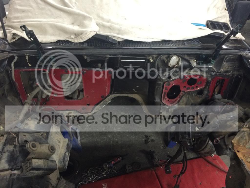

It looks like I'll be cutting into the ranger underwood harness and the explorer underhood harness, and making the 5.0l harness essentially stand alone.
That will allow me to use the old style dash, which frankly I like better than the 95+ dash anyway! That will be a learning experience in itself, I might do a write up on that, we'll see.
Anyway, here's some pictures
5.0l sitting in the frame, one of the dozen times it was set down.

The firewall modifications for the heater core and everything that passes through the firewall. I now get to reverse all that.
Setting the body back on. I need to do at least a 1" body lift, but I'll probably do a 2" just to be safe. It's a street truck after all, an extra inch won't hurt anything (I would have rather not lifted more at all)

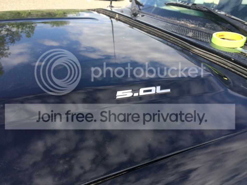

I found some emblems on Amazon.
That emblem looks damn good! That's a bummer you have to do all that wiring mess. Are you going to clean and paint your frame since you have the cab off?
