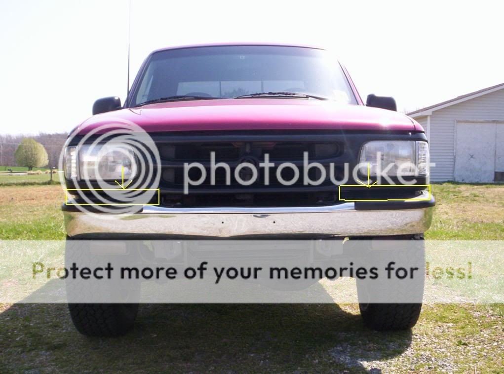

as far as i remember you dont have to remove the bumper.the only thing you have to remove is the corner lights because there are a few screws behind them. and there is also a screw behind the little plastic trim pieces between the grille and the bumper(circled in yellow in the pic)
OK thanks, I tried taking it off yesterday. I couldn't get to those screws under the black plastic corner pieces though. It looks like those corner pieces are for style and the bumper continues underneath. I might be wrong, and that would be great news if I could access those screws. But how do you take off the plastic molding without snapping the clips? I tried popping one off and only resulted in snapping a few clips and so I gave up.
theres really no way of getting it off without breaking those clips. you can go to advance or any parts store and get the clips for a few bucks.
there only there to really hide the gap between the bumper and the grille. if u take them off you can see a little bit of the painted part of the fenders.
OK I guess I'll be snapping em to pieces tomorrow. I tried getting my mits in there to push out from inside the bumper, but all I ended up doing was turnng my forearms into ground beef. Thanks, I'll let you know how it goes.
