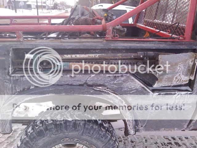

Hope Krous' doesnt mind, but here's a quick pic i snapped of his bedside mount. I thought it was so damn cool, i had to get a pic when I was at carquest...
wonder if you could use the skin you cut off for the hole and hinge it and make a locking door for it? kinda like the new dodge ram does in the top of the bed, but just for a hilift in the side. that way it can be functional storage but hidden????
GGGRRRRR...... that pic does make me mad.

Here are the pictures i do have from the construction of it.
the box tacked together
the hole cut in the boxside. here you can kinda see why the box couldnt be recessed that far without inner modification as well (but that is a possiability)
now here is the first test fit and for the long description. as you can see in the picture the box if welded all the way around this was done with countless welds that were slightly more than tack welds. (I spent a small amount of time playing bodyman in school) the two main bolts that the hightligt rides on are 1/2 allthread it runs thru the cutout box and thru the inner bedside it is bolted on the inner bedside and as soon as it comes out the cutout box. since there was a gap inbetween the cutout box and the inner bedside i had to measure (by poking the allthread thru making it and figuring for metal thickness) and cut two dowel spacers that fit over the 1/2 allthread. i used 1/2 "black pipe" "black iron" "gaspipe". then i put everything together samwiching the dowel spacer inbetween the cutout box and the bedside and cranked down on the nut in the bed and in the cutout box. i did this for both pieces of all thread (the spacers were different lengths) there are also 8 -3/8 bolts thru in the same fasion. i then cut off all the excess threads (in the bed) with a cutoff wheel. I didnt want the weight of anything riding on these welds as any flexing in this area over time would distort the metal and most likely crack the welds. they are purely for look's but they have held up for over a year now to some serious trail use and the highlift has been up against a couple tree's and drug across some smaller tree's. not even the slightest damage so i'm happy.
