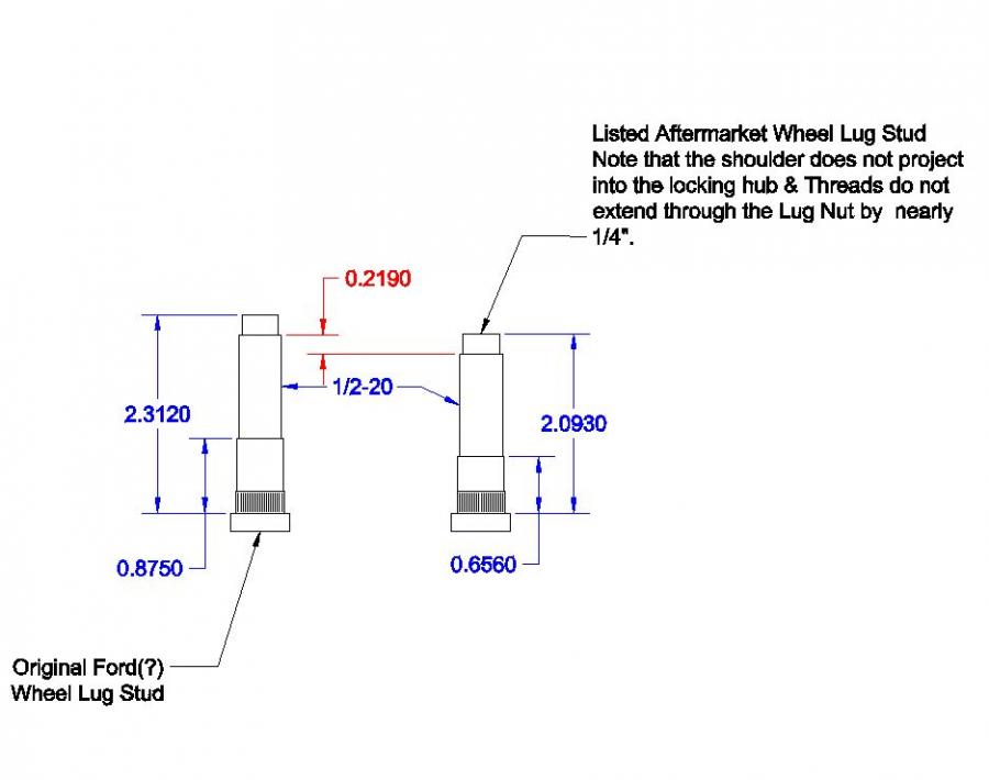

They are all spec’d at 2 3/32” long.
The stud that I knocked out is 2 5/16” long.
IF I use any of the above it will be 0.219” to short and I’ll end up with about half the threads in the lug nut hanging in space with the Factory Aluminum Wheels.

For the record: The stud must have a 7/8” long Shoulder and be not less then 2 5/16” long. The rest of the dimensions for the studs listed above will work.

Figure I'll add a thousand words before I let this go.
I've attached a quick drawing with dimensions of what I've been talking about.
C
