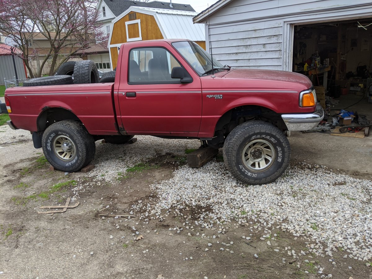

seems to set about the same height as the 2.3. I took the tires and rims off the front so it was lower, set 4x4's on the ground and that worked. That made it easier, the hoist would not roll very well. I still have to attach the tranny crossmember and install the headers. I noticed it's tight on the passenger side but I think it will work. The crossmember on the driver side is right where the bracket for the emergency brake goes.

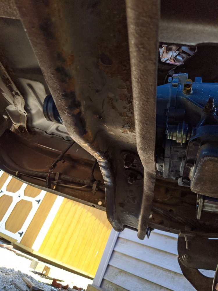

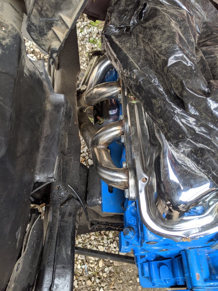

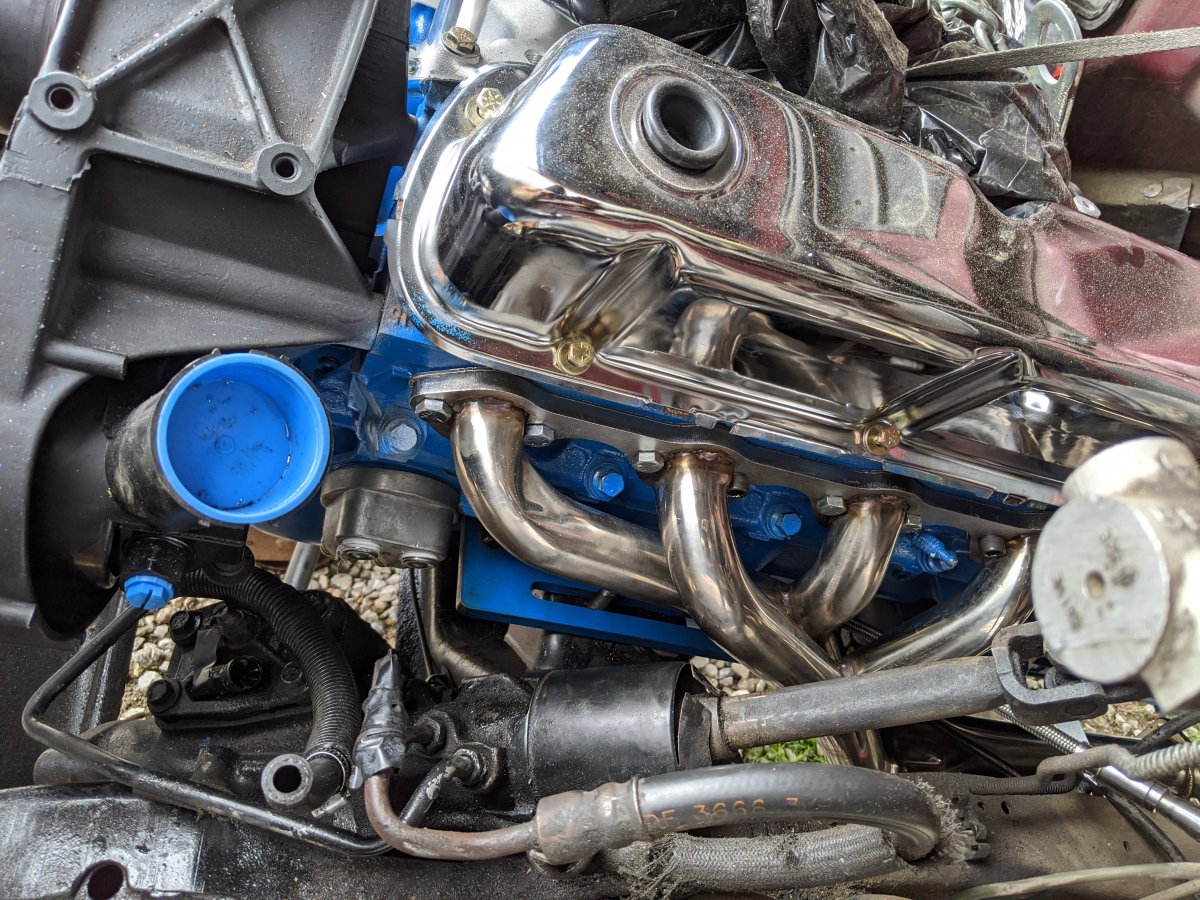

I got the headers bolted on and the oil filter relocation adapter bolted on. I had to take the hose fittings off to install it and remove the engine plate. The engine isn't bolted down completely yet got to install tranny crossmember. I did cut a small amount of the frame. It really wasn't very much I had to remove to get it to fit.

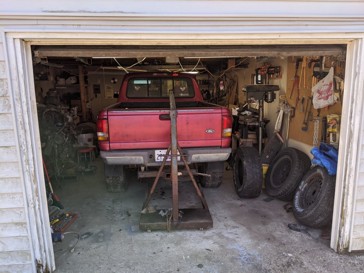

Well , I got the transmission crossmember mounted. Cleared out the garage enough to get the truck inside so the city can't say anything, only had 2 days on the permit. does everything look straight and correct? Going to take a couple of days off from it, then I'm just going to install the wiring harness I bought and deal with the fuel lines.
