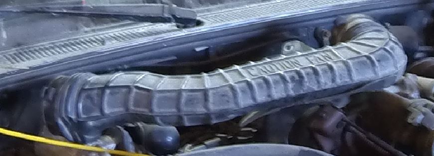

I have one I picked up at the pull yard if you're interested...
This is it sitting on top of my 4.0
