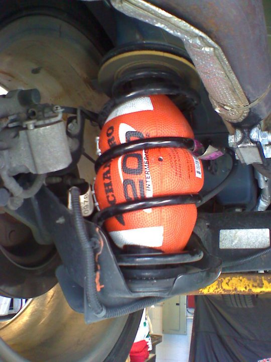

You can just stick a football inside the springs...
36974
:icon_rofl:
