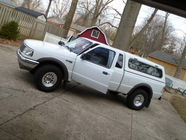

Hello all,
I am the owner of a 93 Ranger with 285, 000 miles on it. I do almost all the work on this stock daily driver truck, of which I am the 2nd owner... recently the drivers side window will bounce briskly up and down, about 1/2 inch, as it moves slowly downward, when I push the window up button. If I fuss with it long enough, through multiply tries, I can get the window to go all the way up. Also when the window is up, it will inadvertently drop down 1/2 to 1 inch and stop while I am driving or sitting.
I have replaced the window control switch.
I am suspecting the window motor: I do not see in the service manual, a relay for this circuit in line to make it work, and service manual does not mention one either..............ideas?
Thanks Wacorider in Indy!!
