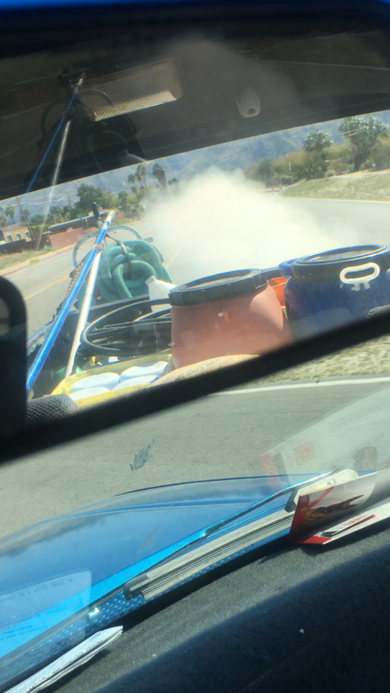

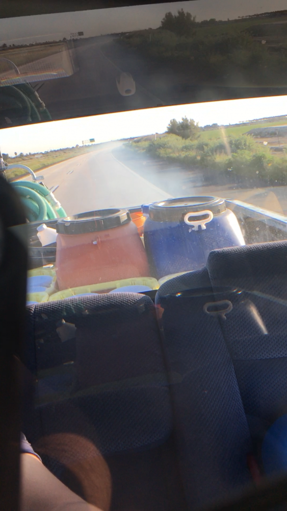

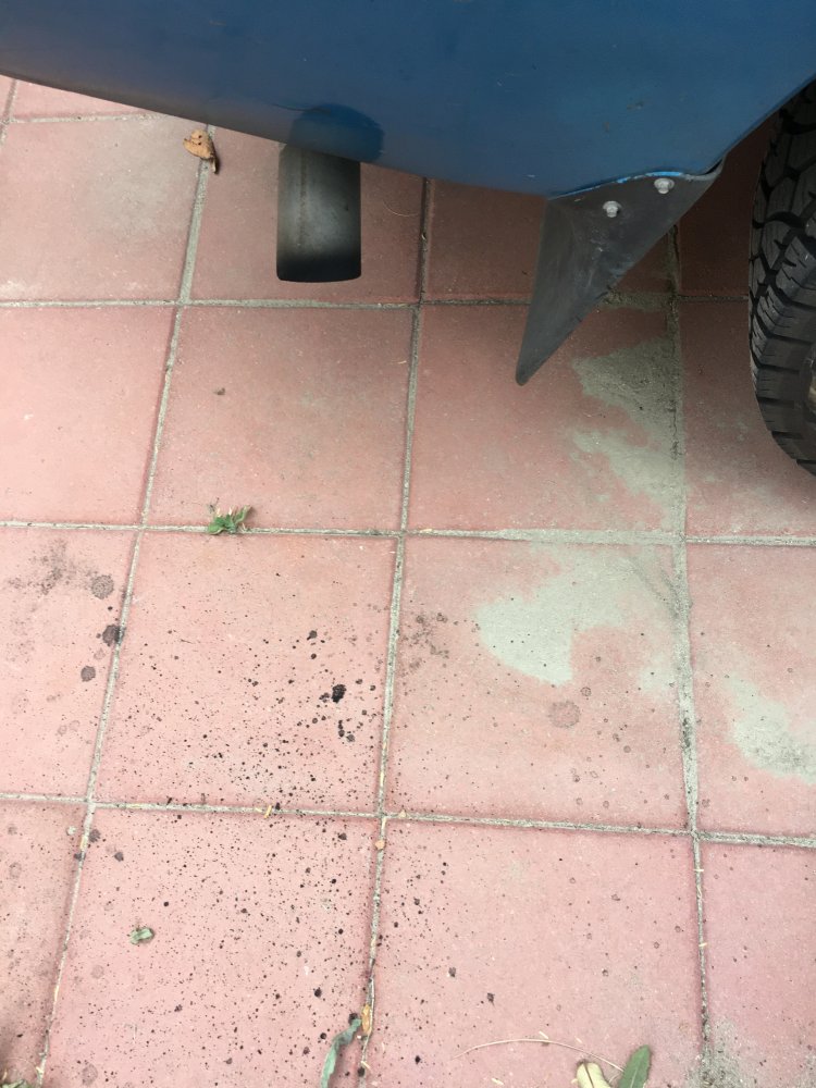

I currently have a 93 ranger 4cyl 2wd, i use it for work every day for pool service, this past two weeks the truck has been blowing white smoke on several occasions, and when it does it the truck becomes sluggish and i can hear a rattle coming from the engine. It shoots out black stuff out the tail pipe when i start her up in the morning. Also it eats up a lot of oil like 2 quarts a week. I would like to know if its possible to fix this or if its better for me to put another engine in... any advice is apreciated
Have you been losing any coolant? White smoke is a sign of water getting in the cylinders. Blue smoke is a sign of oil being burnt. It could be that your burning the oil that is disappearing. That would mean rings or valve seals.
