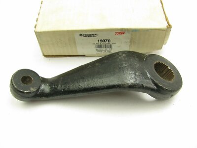

This is another option that could work:
^ that is the exact replacement for the High Rider truck (1.5" factory lift.) It is also identical to pitman arms that come with most 4" lifts. IMO it's too much drop for a 1.5" lift, the steering linkage ends up slightly lower than where it should be. But it's perfect for up to about 4" of lift.
