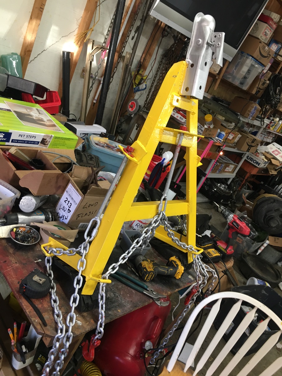

Having said all of that, I’ve towed a bunch of vehicles with tow bars over the years. I made a universal tow bar out of some angle iron and threaded rod in the early 80s, and I still have it. I have towed cars with automatic transmissions, fortunately without damage, but I didn’t know any better when I was doing it. I wouldn’t do it again without dropping the driveshaft.

I also always tie my steering wheel off to the frame of the seat or something like that so it can only move a certain distance. If something goes wrong, it’s much more likely it will track behind the Towing vehicle instead of cutting off to the left or the right suddenly. If it suddenly cuts to the left or right because something goes wrong with the suspension or the tow bar, remember it’s tied to the back end of your vehicle with a chain, and it’s going to pull that left or right.
