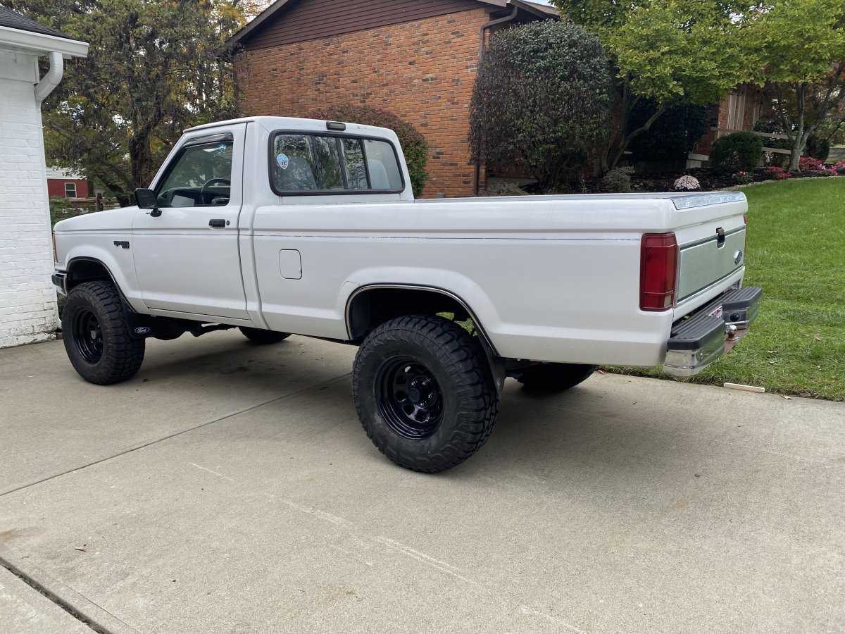

I have a 1992 Ranger XLT Single Cab LB 2.9L 5 Speed Dana 35 Front and 8.8 Rear Open Diff with 3.55 Gears 31 x 10.5 r15 Wheels and Tires and a 4" Lift. It takes a lot of clutch work to get it moving and getting it up to speed on the highway takes a bit. This is my first truck and my dad and I are planning to do so some work on it this summer. Right now, it is my daily driver back and forth to school and work. The area that I live in is hilly. I don't take it off road (yet :)) and the 4-wheel drive mainly gets used when it snows. Though currently the automatic hubs are acting up and won't engage (we are planning on replacing them with manual ones). My question is what gear ratio do you think would be best for the combination I have described? My dad and I looked at the charts and it seems something around a 4.10 would be good? Are those readily available? Any recommendations on brands to use? Any advice would be great!

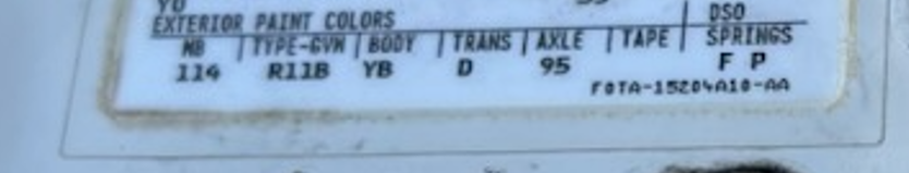

Thanks Eric. I believe the 3.55 axle did come with my truck strangely. My dad thought it was strange too from what he read on the forum We looked up the axle code on the VIN door sticker and it said 95. Which decoded as an 8.8 with 3.55. Any recommendations on parts suppliers or brands?

Hmm...according to the TRS chart 95 is infact an 8.8 with 3.55's. If you for sure have a 2.9 you have a rare bird there. But it was 92 and nearing the end of the 2.9's run so who knows what ford did.

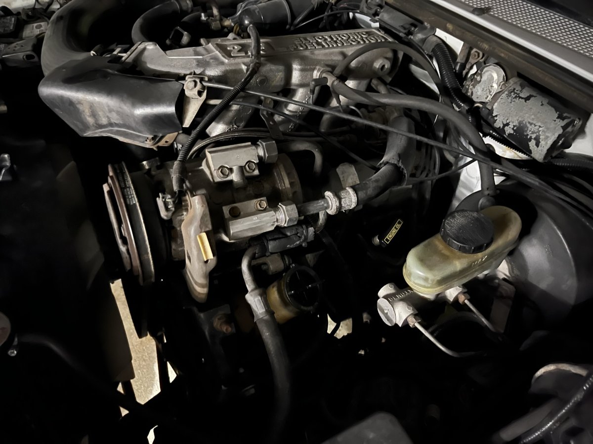

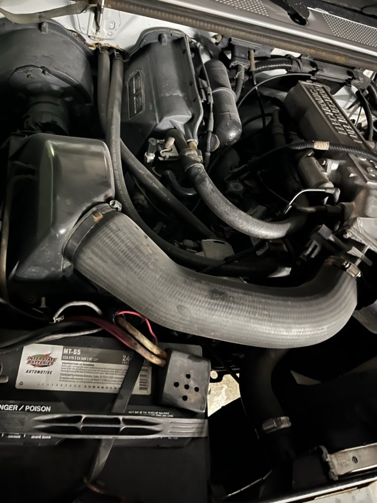

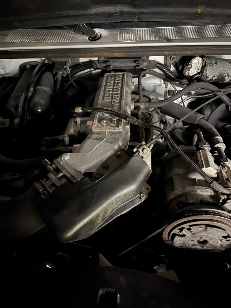

100% sure it is a 2.9L. I'll take a picture of the engine and post. Can you buy the 4.10's new or do you have to find used? I see places like Summit Racing advertising new?
This is the VIN Tag. I blocked out the VIN but you see in the axle code.

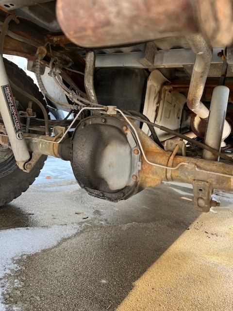

I would compare the vin on the door to the one on the cab and make sure they match. Or better yet crawl under and see if your axle tag is attached.
You can buy 4.10's yes, but they are expensive and setting them up takes some skill. Youre better off swapping axles.

Yep, original door. My dad and I double checked It, matches tag under windshield on the cab. 2.9L looks like it is all original. We have replaced the radiator, fan, fan clutch and alternator. Axle tag is in the first post. Says 3.55 88 which matches the door sticker.
