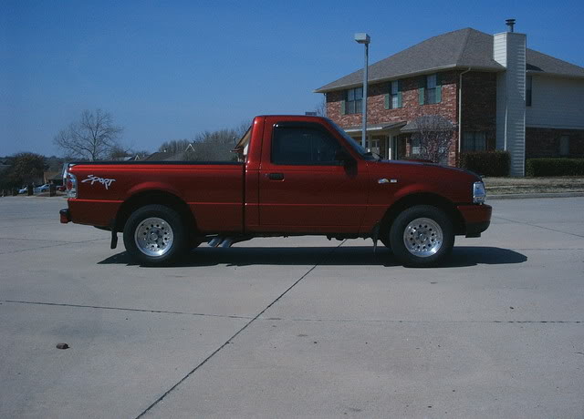

92 Ranger rear wheel spin.
My Ranger is a SPORT model. The door label alpha numeric code says it's a 7.5 open differential. I don't know if maybe SPORT models had something different done to the axle that the label doesn't speak to? When it spins on wet pavement, it moves sideways, so both wheels must be turning, not just one. On dry pavement, yes it will leave two streaks. Don't ask me, I can only report what it does. I have no idea if the original owner did something to it before I bought it.

I don't think your front axle is putting power to the wheels.
Some serious misunderstanding of how shit works here.
Any chance you can further educate me about this and possibly have a way to test this?
Do you have lockout hubs?
Likely they are broke .
Put it in 2wd and spin the front drive shaft with the wheels on the ground
Heck, put it in 2wd and spin the front drive shaft with the wheels ON the ground. With the transfer case disengaged and an open front diff whichever side has the blown hub will keep spinning.
One time I got stuck in about 2 feet of snow with auto hubs. The wheels were slipping so badly I was able to leave it in 1st gear 4-hi, get out of the truck, and look under to see which axle shaft was spinning, and which one was locked to the wheel.
