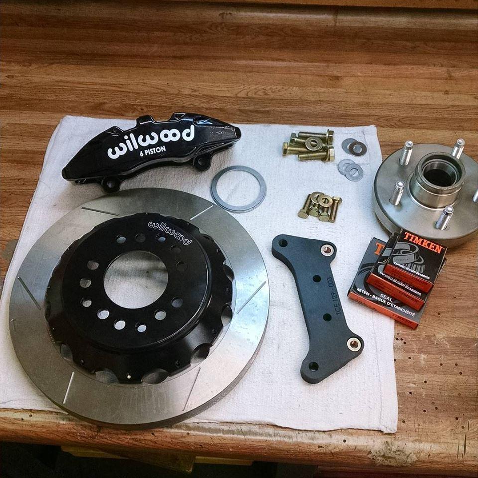

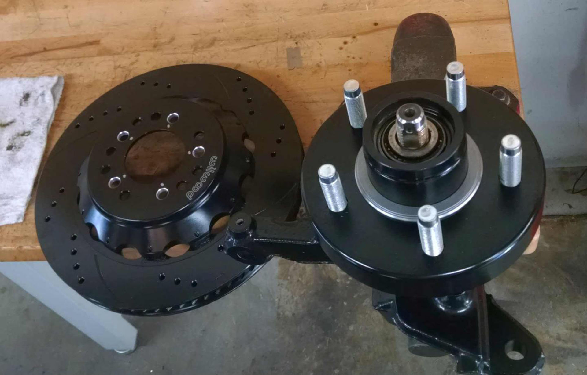

lol What? The 95-97 spindle swap is a common swap for people wanting to go with bigger brake systems. I'm currently swapping 97 beams on to my 87 to gain the larger twin piston Ford calipers, and making brackets to use Sport Trac rotors. That'll be enough of an upgrade for me.
But that kit would be VERY nice as well. Just too expensive for my taste.. If my factory hadn't closed up shop, I would've already bought this kit.

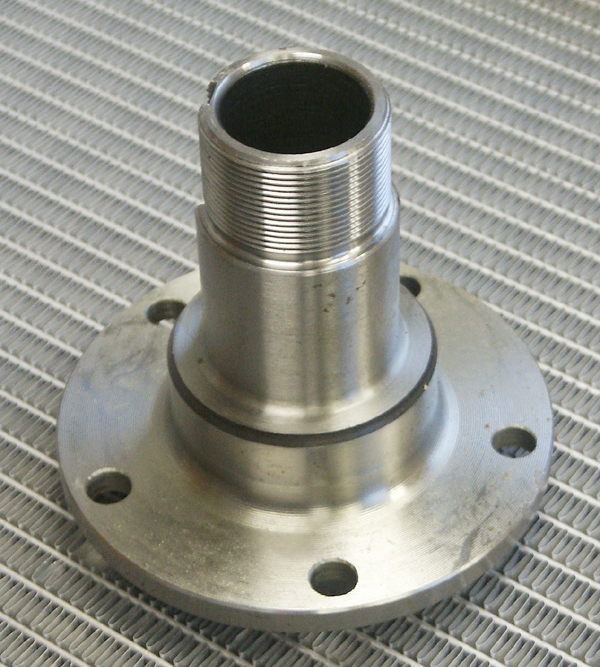

I though about using parts of these spindles in the front to get heavy duty bearings for the 315 slicks i will be putting on the front .

We run 245s on 17s on our truck (track only so lots of heat and abuse). The bearings have held up fine.

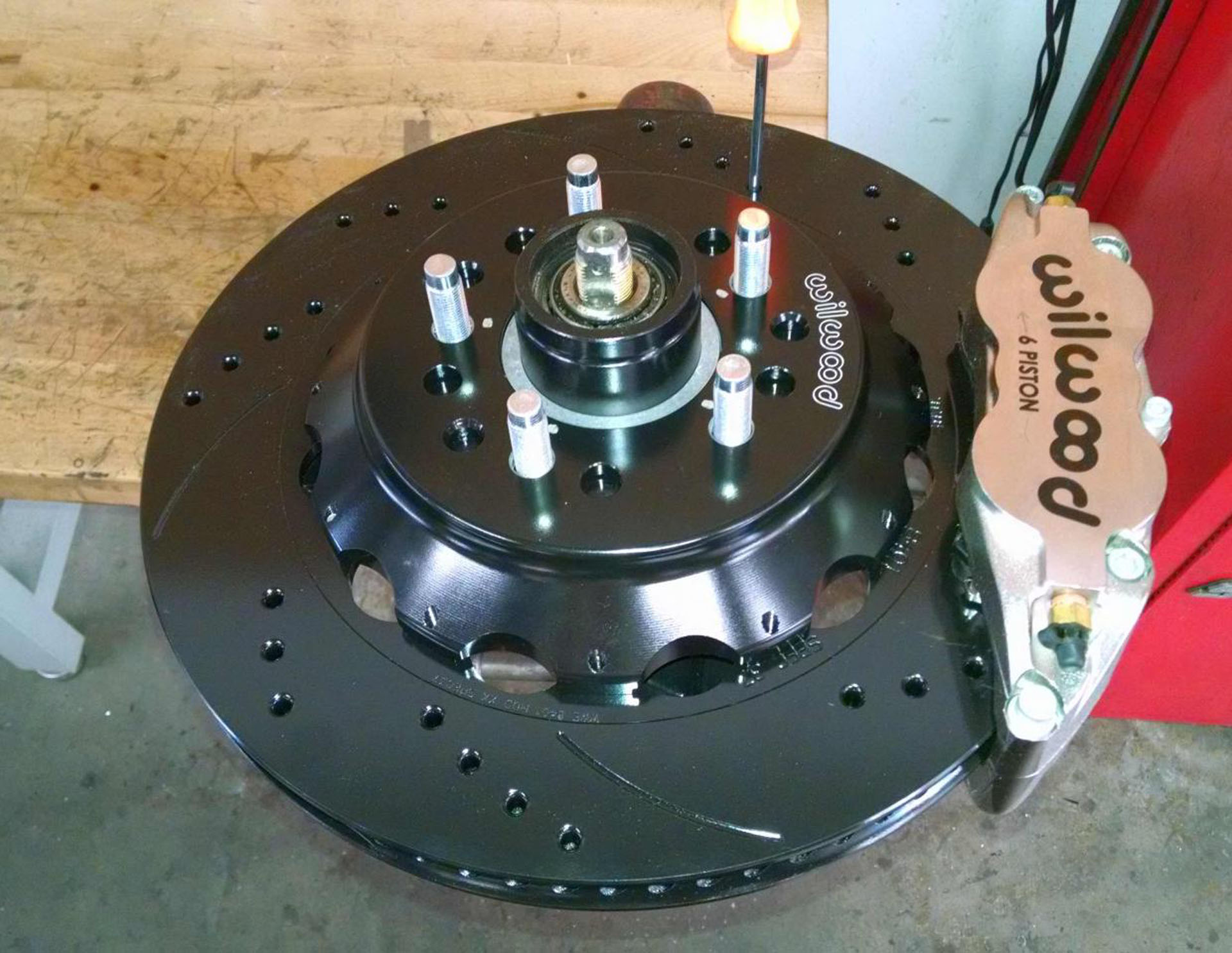

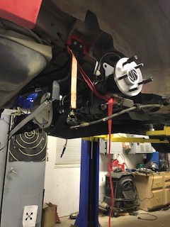

Were you able to get your hubs machined? I have ordered WilWood 4 piston (they use the same pad as the 6) and am still looking for measurements for the Hub.

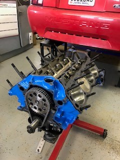

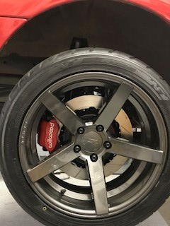

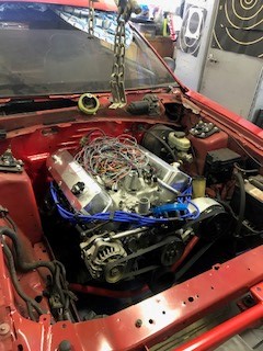

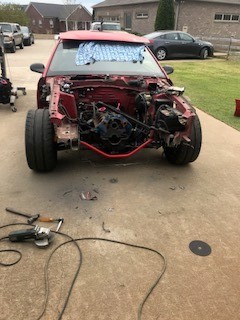

Looking to start back on the PTR project. Got side tracked from a D vorce and finished up the Mustang so much of it. Got to put Roll cage in it and fix wind splitter and a different rear wing.
73285
73286
73287

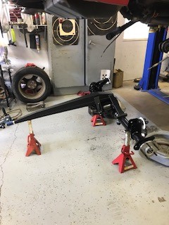

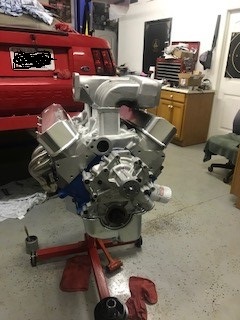

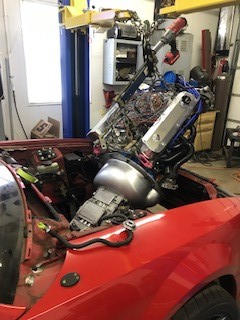

Well the engine hoist wont work for the long front end on the mustang. so New idea.
73296
73297
