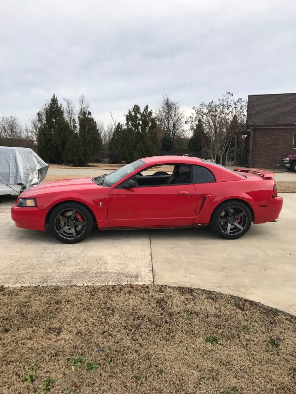

Yes and no. Got the front end sold and got the new frame started. So found a 02 mustang and put the ranger on the back burner. Got rid of the wife and getting things back running correctly.

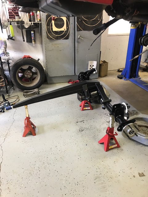

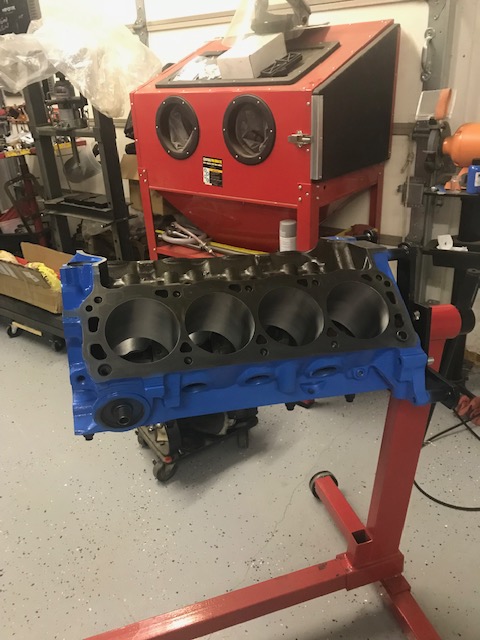

The truck will be getting a 351W stroked out to 427 and will have to get the T56 Magnum. to hold the Torque. Didn't wont to mess up the cab on the truck trying to remove it so here's some more money went to a 2 post lift.

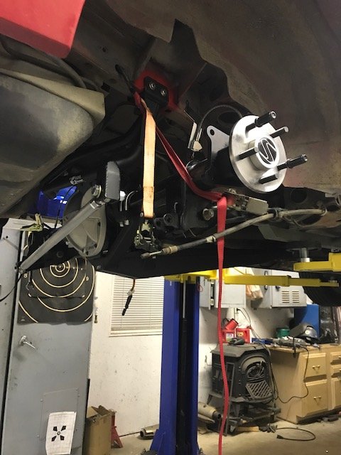

Info: i am going to use some 99-04 mustang spindles and make adapters for this truck and my 05 ranger so i can put better bearings and brakes.
The mustang has got some major components under it and should have it finished this year then start on the Beast . Wont to get some seat time on a smaller motor 450 ho in the mustang before building the Beast and wading it up right off the bat with a 700hp motor. Hope to get the frame done so i can roll it around.

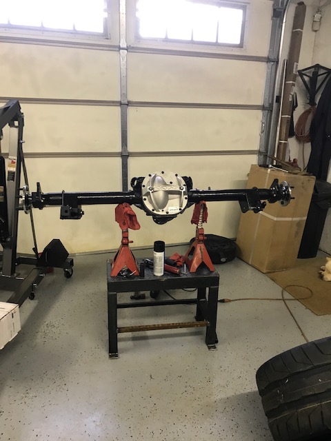

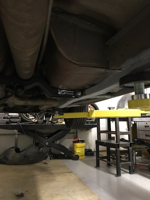

So working on the mustang any ranger could have a torque arm with a 8.8 mustang rear end and have a hell of a suspension set up . Once i get the front spindles so they will fit any body will be able to put 14" wilwood 6piston calpers on. Major up grade for a V8 Ranger. The Torque are will use less room so you can keep your bed looking stock.

The 4X4 spindles are better but if you have a 2 wheel drive the mustang spindles have bigger bearings inner and outer than the ranger and will allow wider slicks on the front for autocross and track days.
