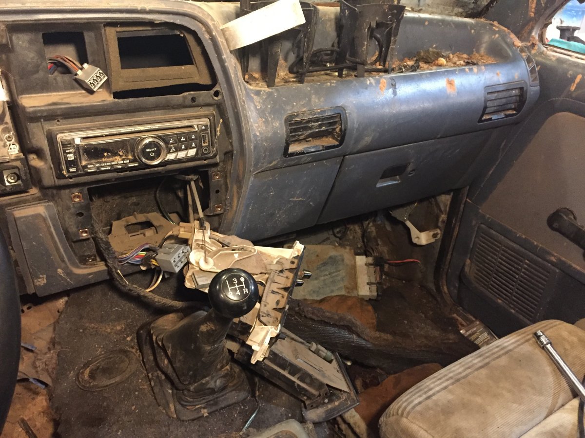

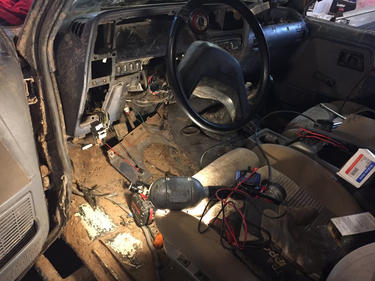

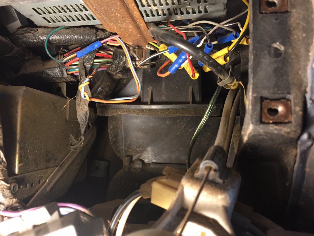

Getting it all ripped apart. Found wiring previous owner did(aaahhhh) cut off wires and taped up ends, sigh.
According to the diagram, light blue with red tracer goes from the light switch to the dash lights, gave it 12v and... high beam indicator comes on.( not even in the same circuit) Put power to the black/orange which should be power to the radio, nothing. Radio works if you turn on the key though. (Or the headlights...)

Thanks bill, that ground wire was tore off but I twisted it back together and even ran a jumper cable from the negative post to the wire/bolt and nothing.
HOWEVER, I found the blue wire with white tracer on the heater switch was supposed to be a ground. Continuity test, nope. Ran a jumper from the wire to the ign switch and VOILA!!!!!!!
Dash lights worked normal and the radio didn’t come on. Plugged in the heater switch and blower motor worked! YAY!!!!!
Now that I know that black wire on the kick panel is supposed to be it, I’ll look again closer tomorrow.
