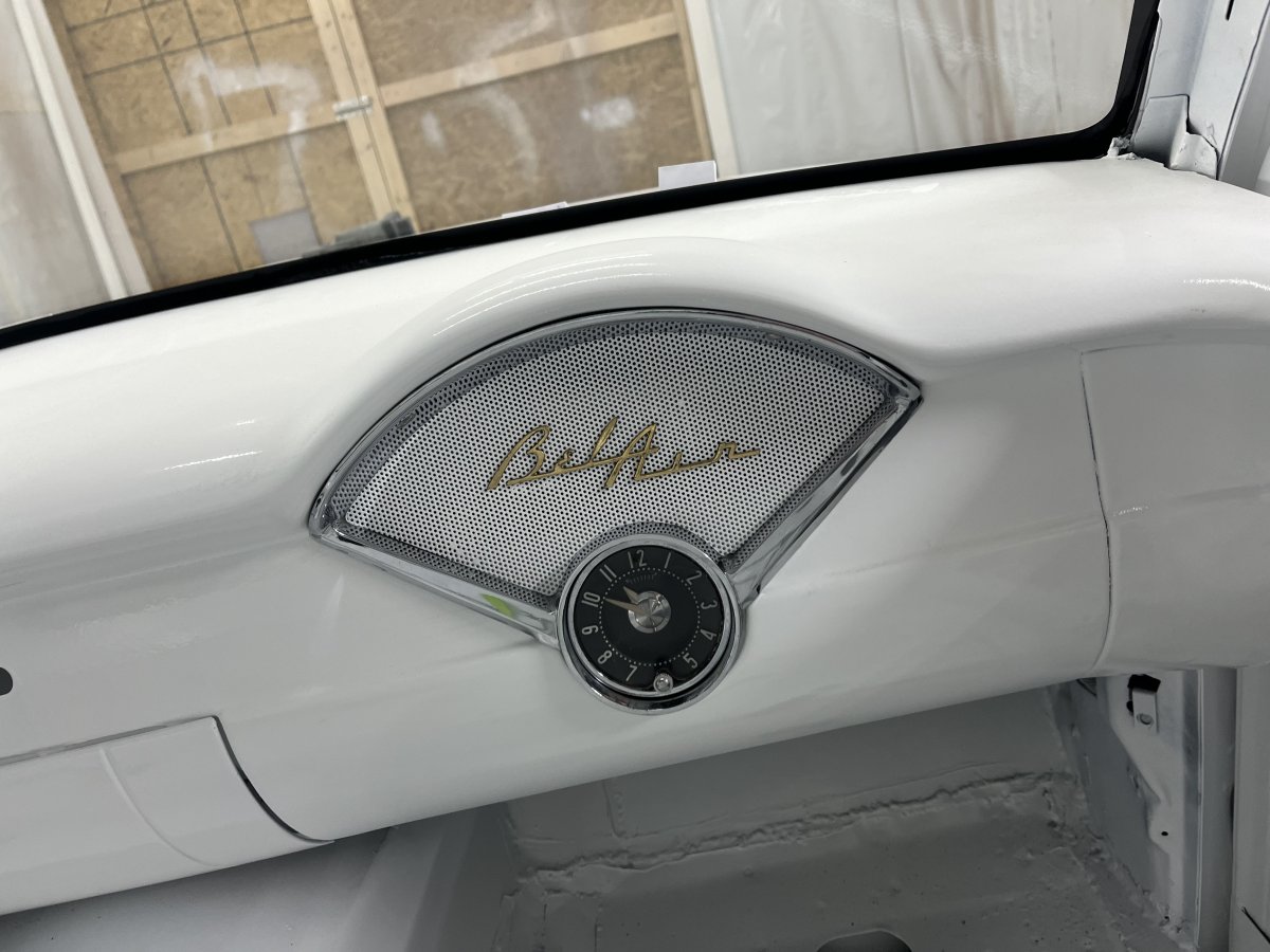

honestly I am not sure what possessed me to do the Belair dash, I knew I wanted to do a dash swap, so while at Carlisle swap meet I was looking and all I could find was an old desoto dash and this Belair dash. so I brought this one home and it fit pretty damn good.
i was skeptical when i saw your first post, but you blended it in really nicely

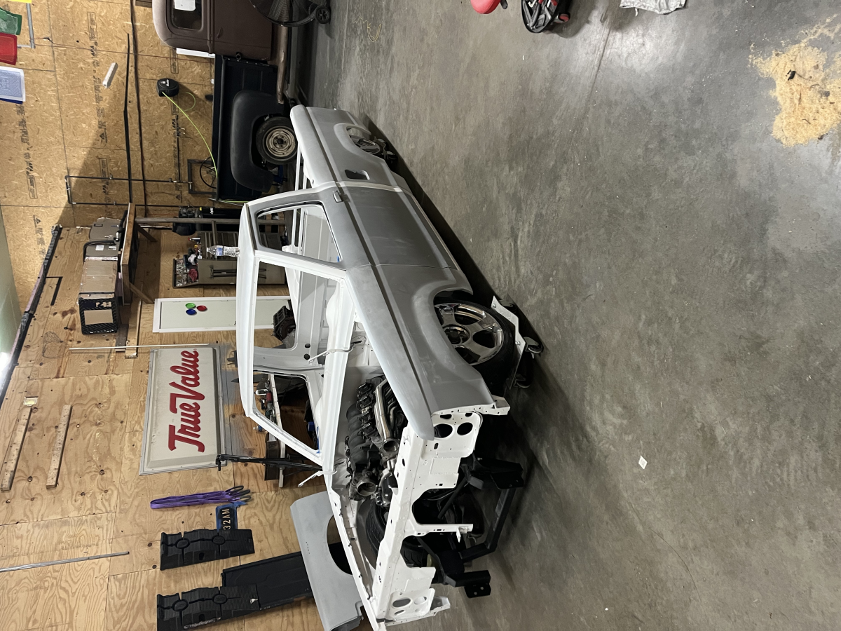

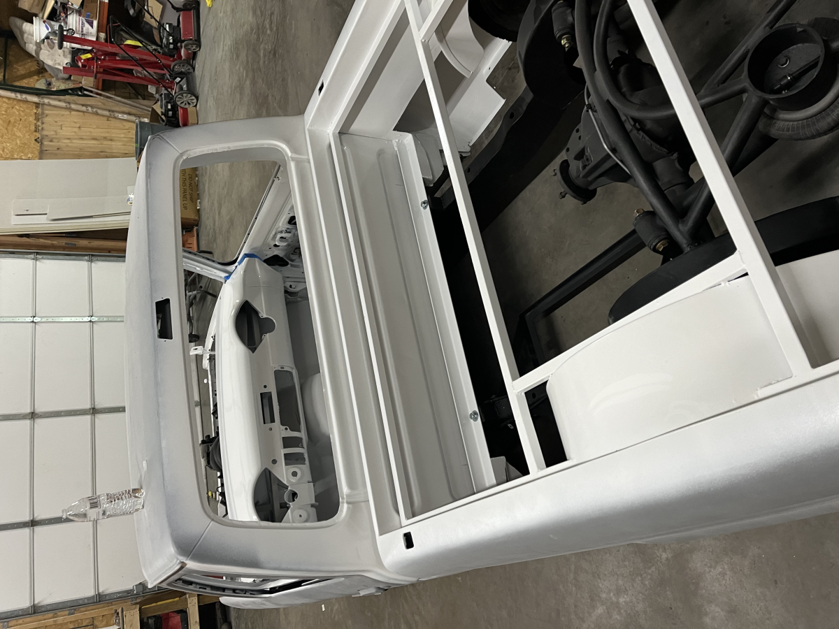

Ok so what am I doing wrong guys with uploading my photos on here? I've never had an issue with it before coming up sideways..
anyway. got the truck put back together somewhat tonight. windows are going in this weekend. then its final blocking, tape up and paint. really excited to see it all painted.
driveshaft is being made as well this week. feeling really good to get over the hump
and yes that's a 1946 ford truck in the back and you ford guys will be pleased to know that she is getting a coyote engine swap. not doing another gm swap into a ford.

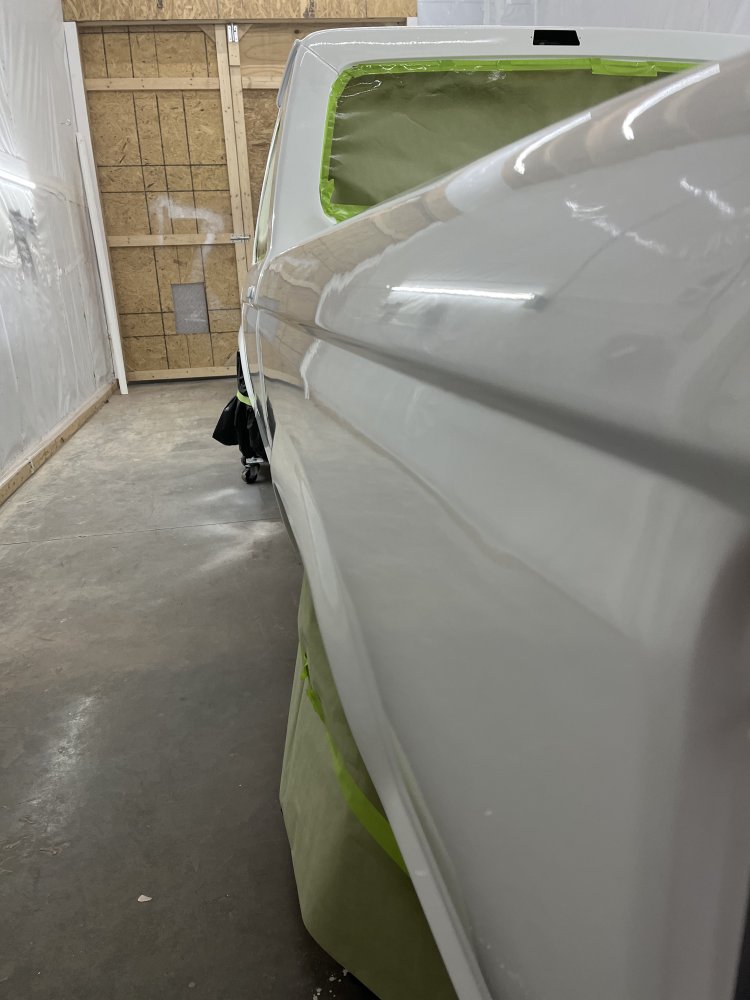

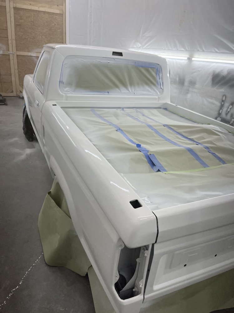

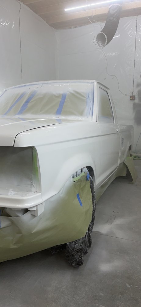

got the truck painted today. five coats of base. three coats of clear.. planning to let it cure. wet sand and shoot three more then after that wetland and buff.. my painting environment isn't five star....more like 3 1/2 stars haha. so wet sanding is going to be a must.

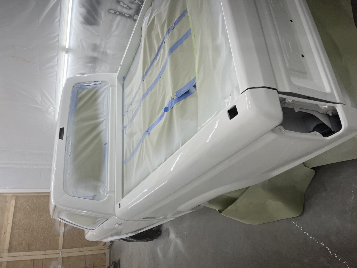

So after the first round of clear I wasn't happy. Went ahead and wet sanded the entire truck with 600 grit and re shot the entire truck with three more heavy coats. I changed my gun settings up a bit to drop more material during spray. Needless to say I am VERY happy with the results on second time around. Truck was shot using Eastwood Pure White base coat x5 coats. followed up with Eastwood 4:1 Premuim show clear x6 coats. I am planning to start installing windows and interior this week. once its finished a good curing I will wetland with Merka Abralon foam pads starting with spot sanding 1500 on the dust nibs only. Followed up with 2500 then 3000. Then will use 3m cut and buffing products. Thanks for following along with me on this project and I am glad to say its going to start looking like something more and more here weekly from here on out!!!

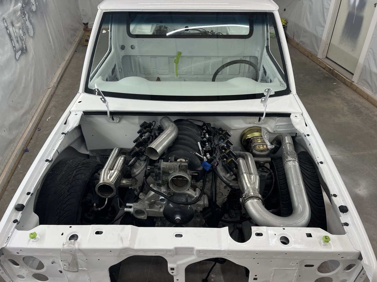

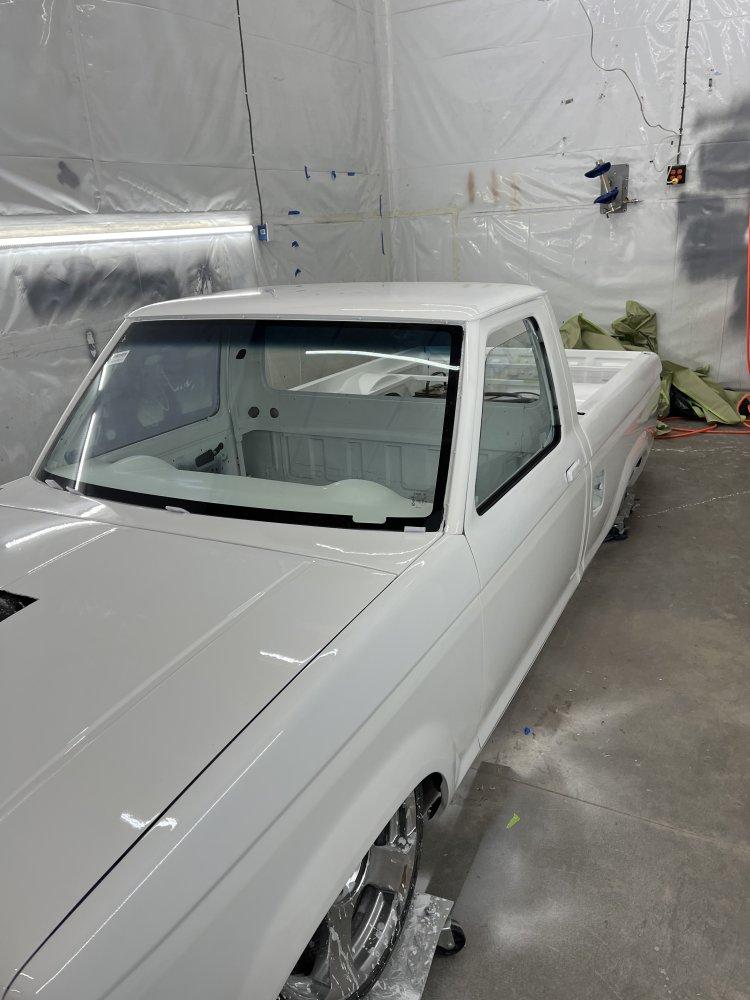

got windshield in this morning as well as back window.. I am having a hard time finding new windshield molding for this thing other then on eBay. which I try to avoid. anyone have any other sources. lmc truck doesn't have molding for earlier rangers only 93- up. anyone with any info let me know. thanks

did some smalls tonight. started putting the dash together.. my 4 year old son said he wanted the back drop of the Belair logo to match the color of the dash, so we mixed up a little single stage and shot some white on it...boy was he right. with that gold Belair logo and the clock it looks great

got some time this evening to work on the exhaust. really wanted to get three inch all the way back but lack of space didn't allow it with enough clearance after heat wrap. reduced it to 2 1/2 inches before the drop down. hoping to get the passenger side welded up tomorrow night, then install alternator fuel rails vintage air heater/heater core and radiator over the weekend and hopefully hear this thing run finally. going to have to heat wrap every inch of headers and exhaust in the bay. just another step in the road.
