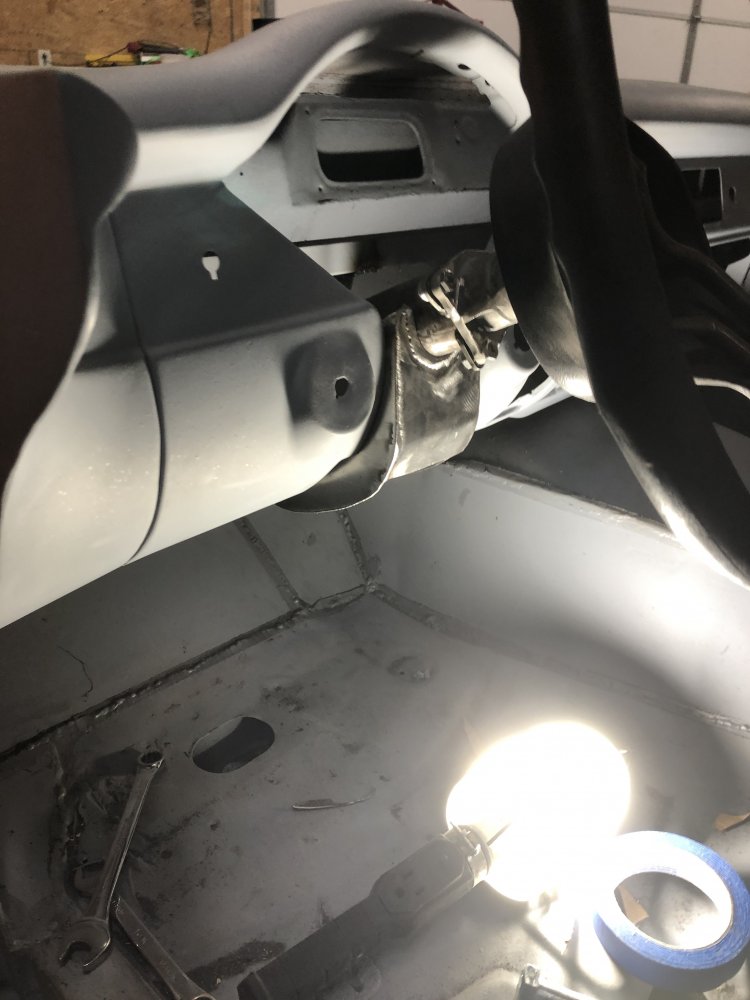

so the Belair dash we cut the space below the column out when we originally worked it into the ranger. so this open space needed to have something in there that would hold the column so this is what I came up with. there will be a top clamp that bolts down from the top to hold the column in place. pulling the cab back off next week to finish weld it then the blocking and painting comes next. figured I would share this before bed. doesn't look like much now but will look like it belongs on the dash when its done. good night everyone

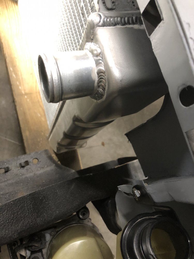

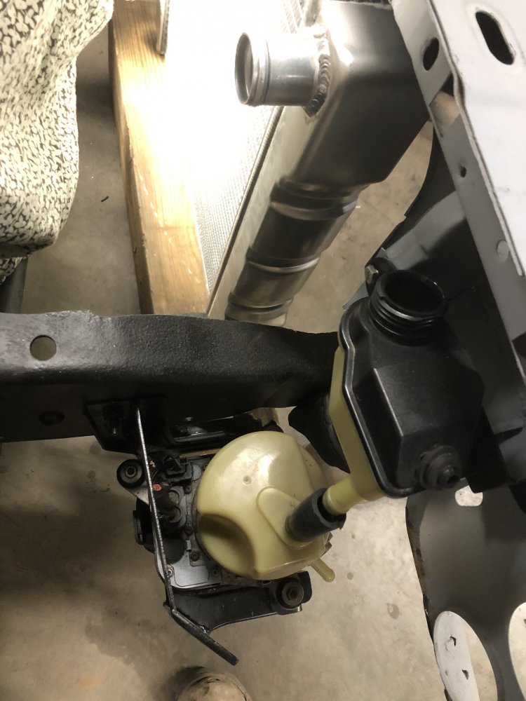

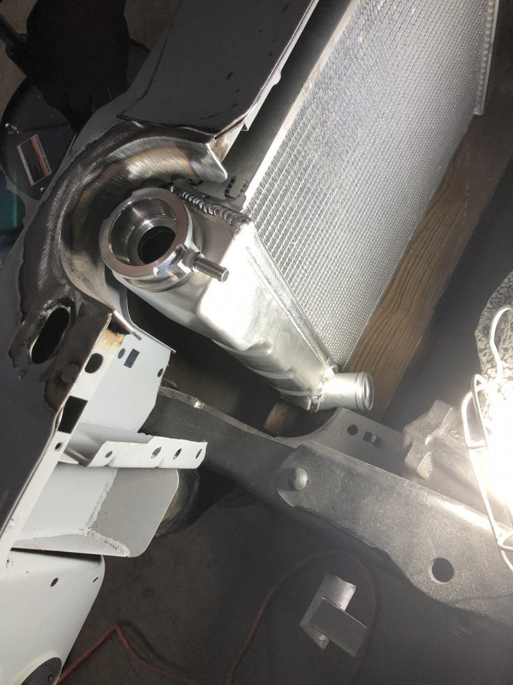

Working on mounting the radiator and the Volvo power steering unit tonight. Notched the top of the core support to push it forward. Looking for ideas from you guys on mounting it?

That's always the million dollar question. That one seems to offer a pretty decent challenge for secure mounting.
There is a bunch of mounting do dads and thing-a-ma-jigs available to make this happen. I'm sure a google search will let you start to visualize a final solution.
Maybe a lower crossmember with a couple rubber mounts across the bottom to do the lions share of the work. Then a couple custom brackets on the top with saddle rubbers to keep it in place.
JEGS 52077: Universal Urethane Radiator Mounting Pads | JEGS
Aluminum Radiator Mounting Bracket With Pads Kit (speedwaymotors.com)

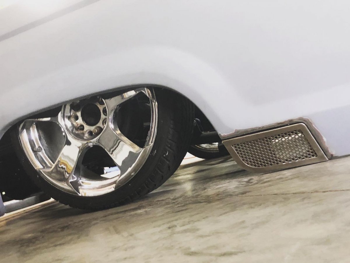

got exhaust tips fabbed and installed today. drivers side matches the passenger. plan on running 3" used four inch pipe on inside of tip so the three inch sits just inside to prevent any rattle. feeling good about them

Can't wait to see this done.
