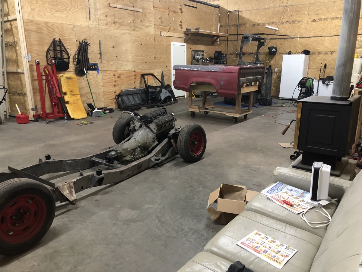

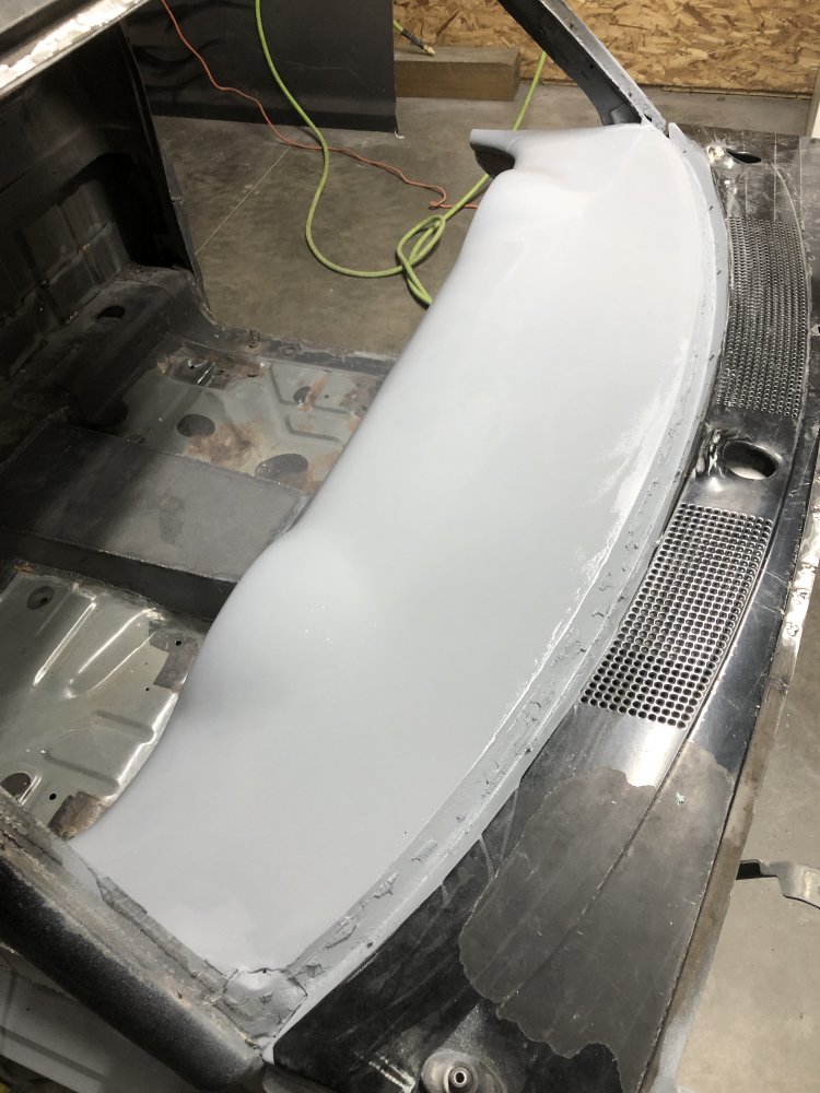

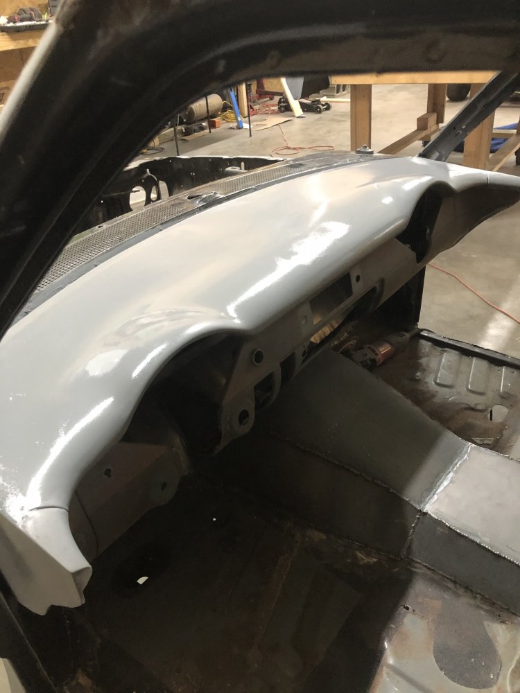

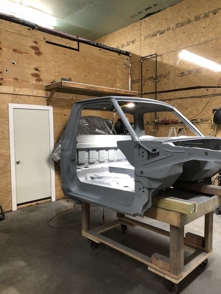

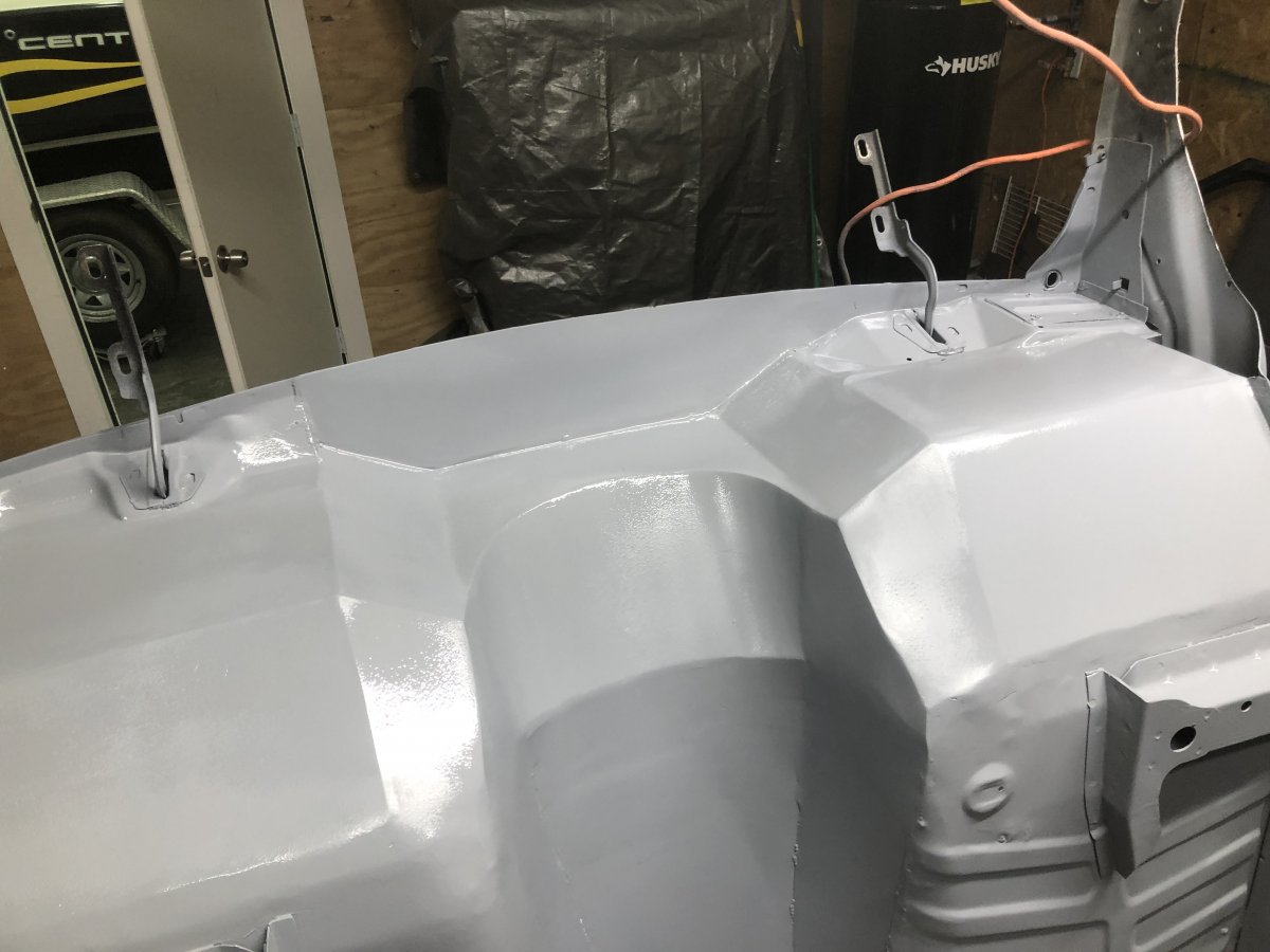

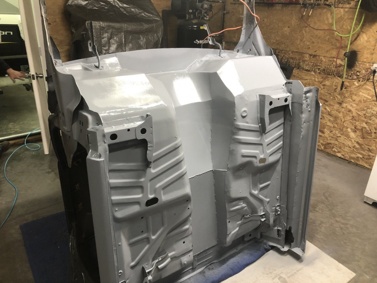

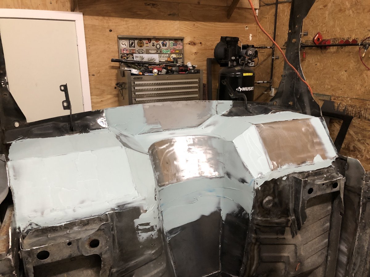

Pretty big step tonight, onto phase two, bodywork....its been months worth of nights on the welder doing all this fab and man am I happy to be able to put that welder down.

my plan is to go two tone paint outside, preferably a stock blue and white scheme that ford offered in the early 90s. carry the white and blue inside the cab on dash and lower doors. white leather on Bench with blue piping. really want to try and make the whole truck look as stock as possible. going to run door handles, fuel door, third brake light, tailgate with handle, rear bumper etc.

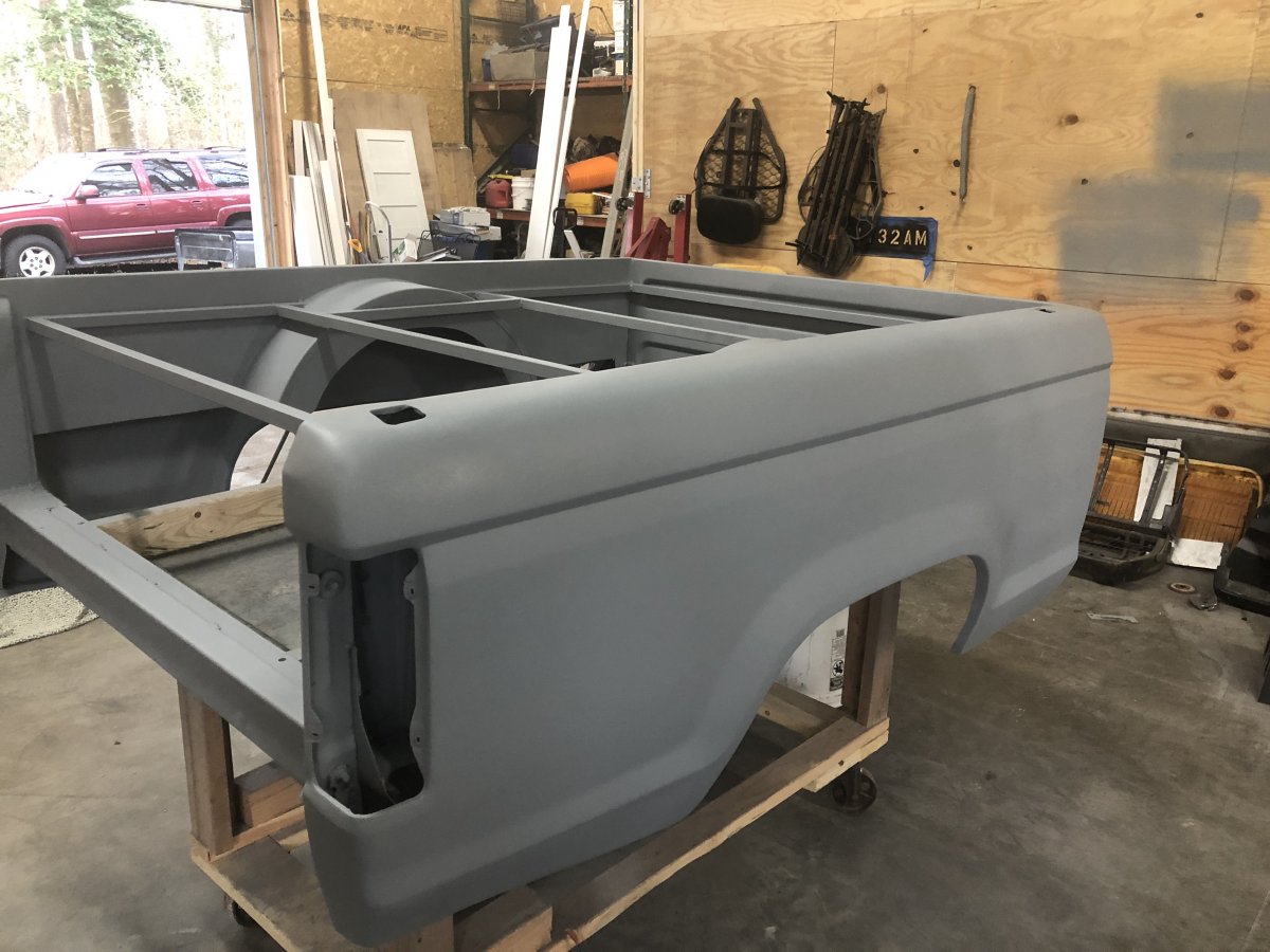

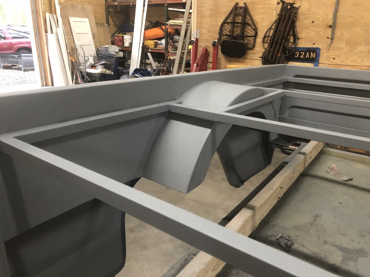

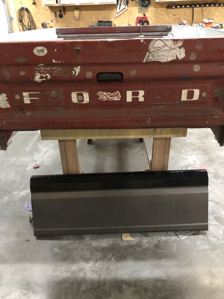

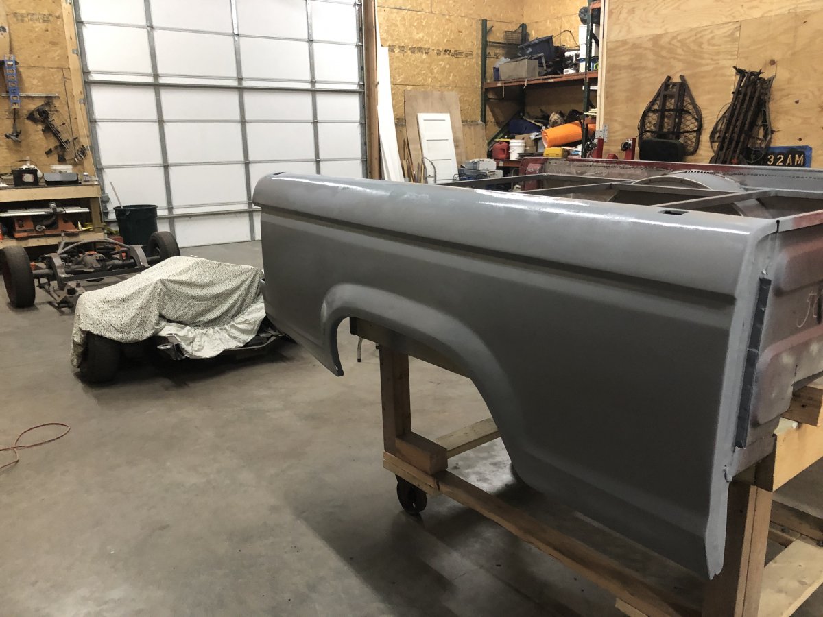

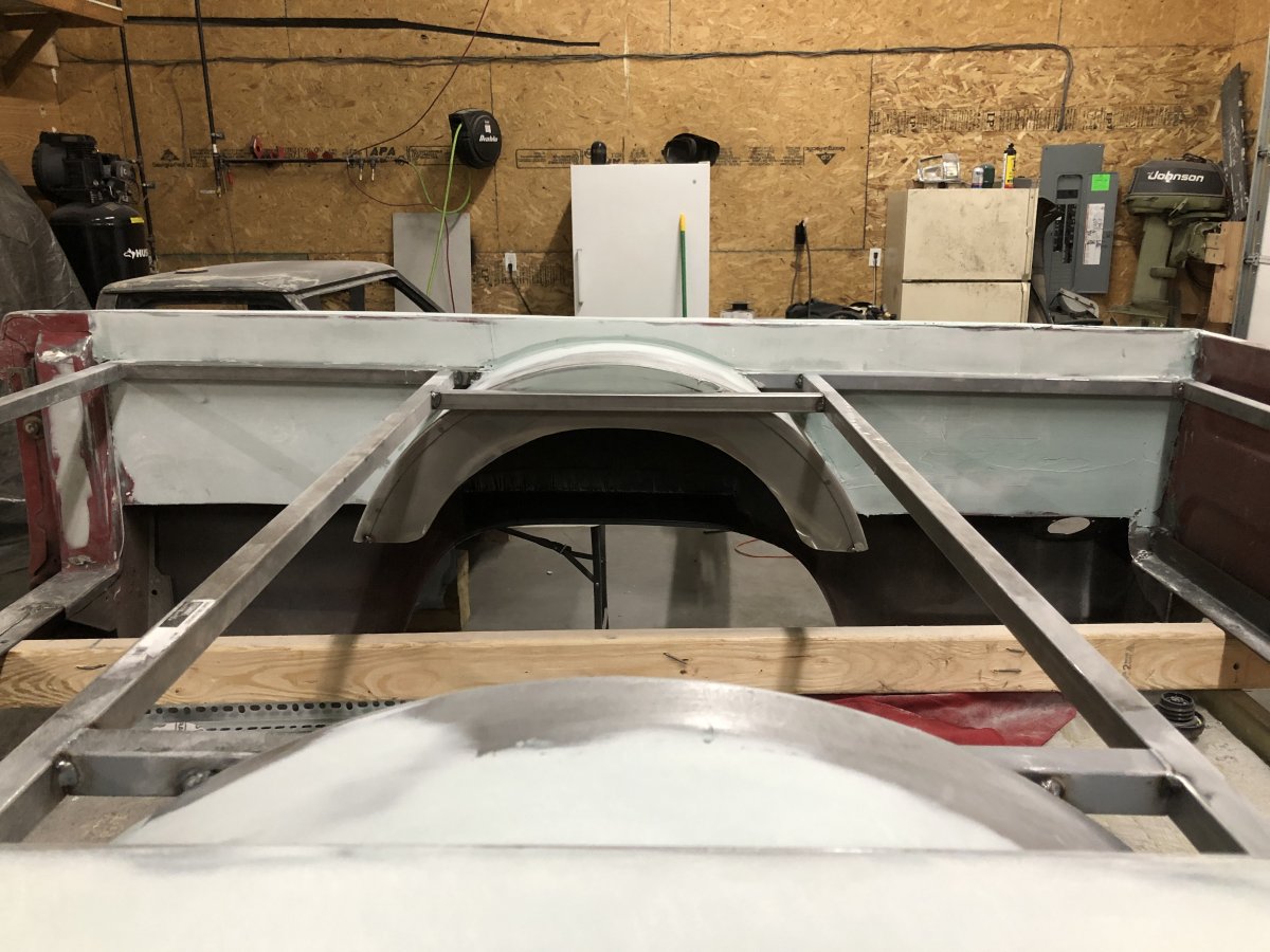

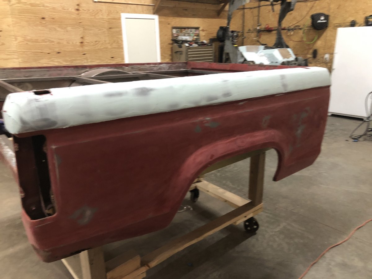

getting the bed situated, upper bed rails were pretty rough. had a lot of metal straightening and body work to do. I am going to run rough cut cherry planks ten inches wide in the bed floor on top of the metal framing. bed mounts in front and all the way in rear. have to make fender quarter supports still. going to spray line x everywhere under the bed floor. custom built aluminum gas tank will sit in near stock location and hang from floor framing also. everything above the floor will be color match sprayed to truck color with wood floor installed over. Had some metal repair behind rear passenger wheel and had to replace some of the fender well on drivers side. truck came with a shaved tailgate from previous owner, and my red gate is trashed, so I think im going to cut the OG ford logo out of the red one and fab into the shaved one.

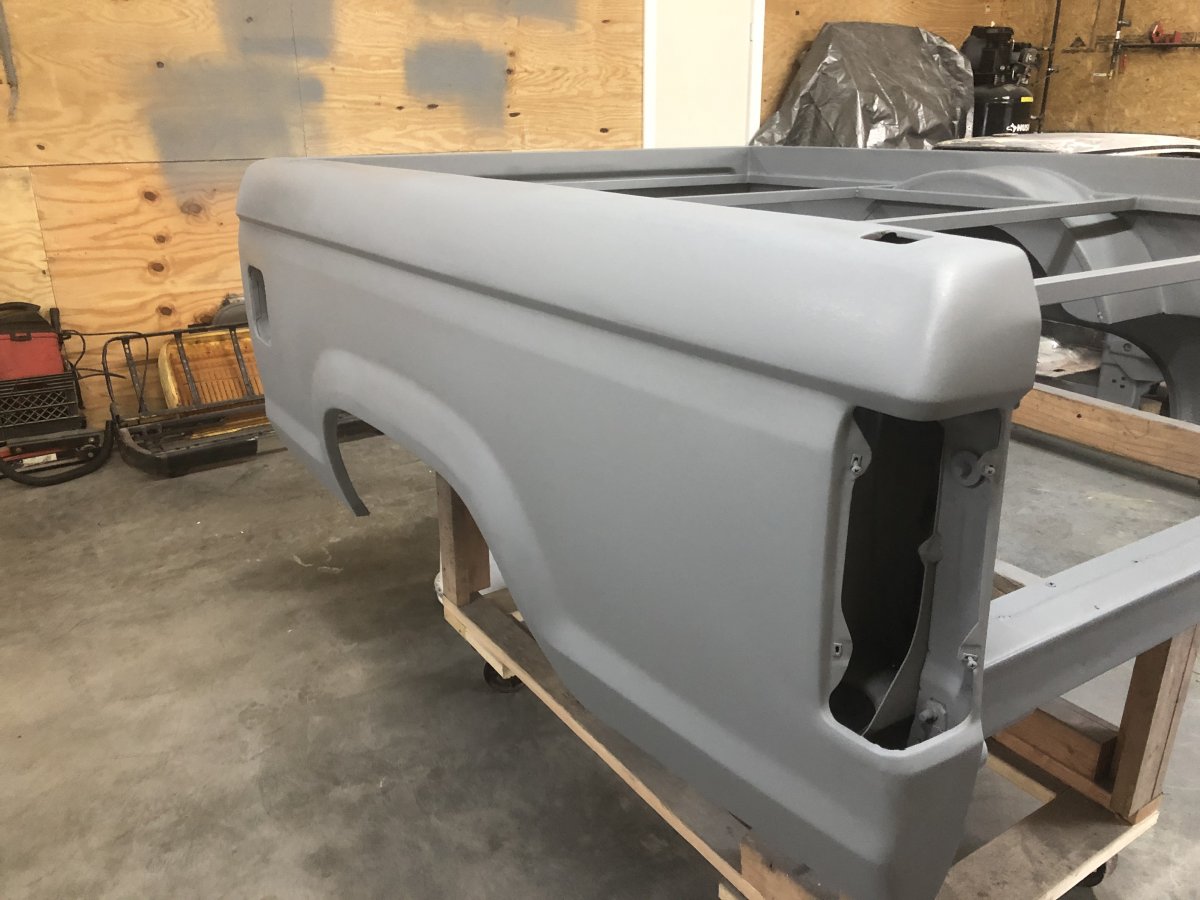

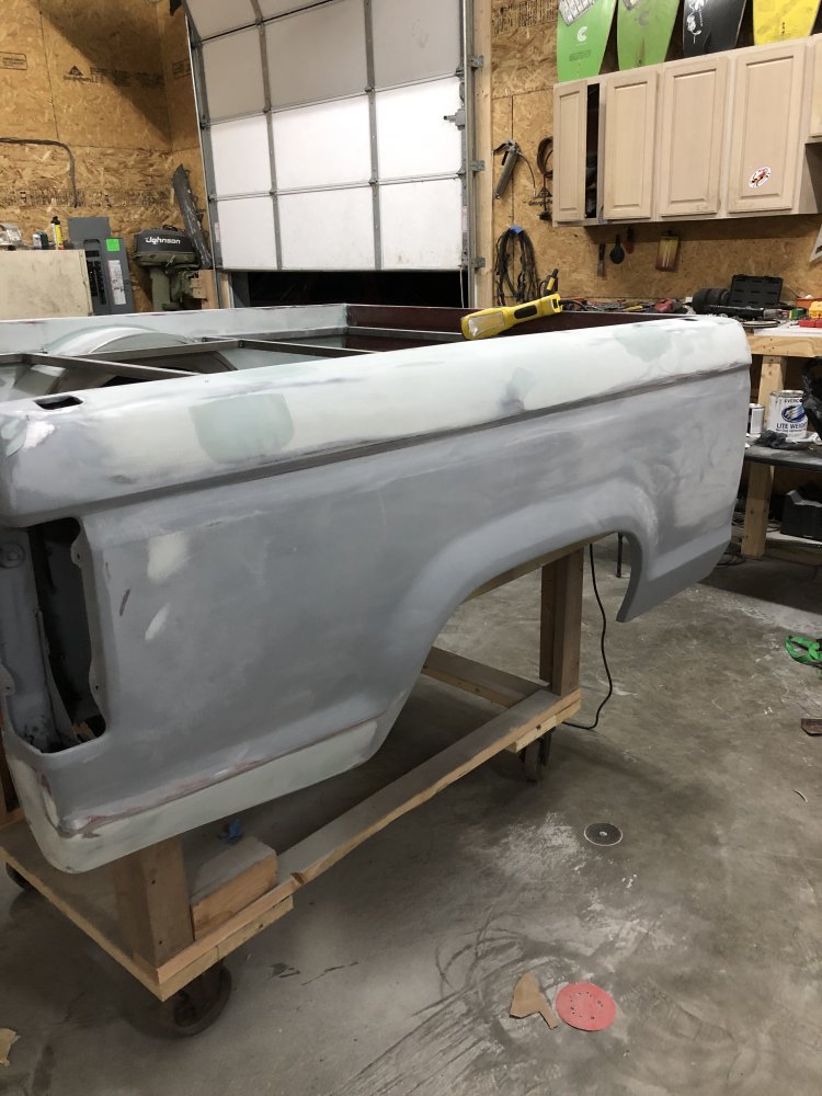

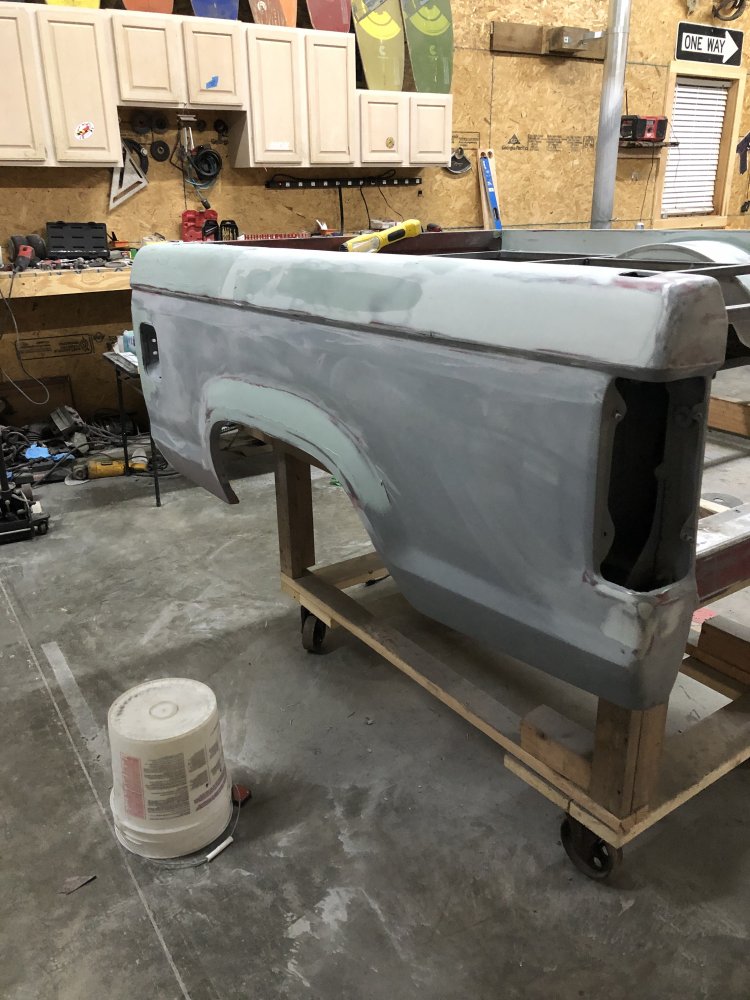

got bed 90% done on bodywork, laid a coat of hi build down on it tonight, setting it to the side for now, next thing on the agenda is stripping the chassis and spraying that. should start the reassembly process in the next few weeks.

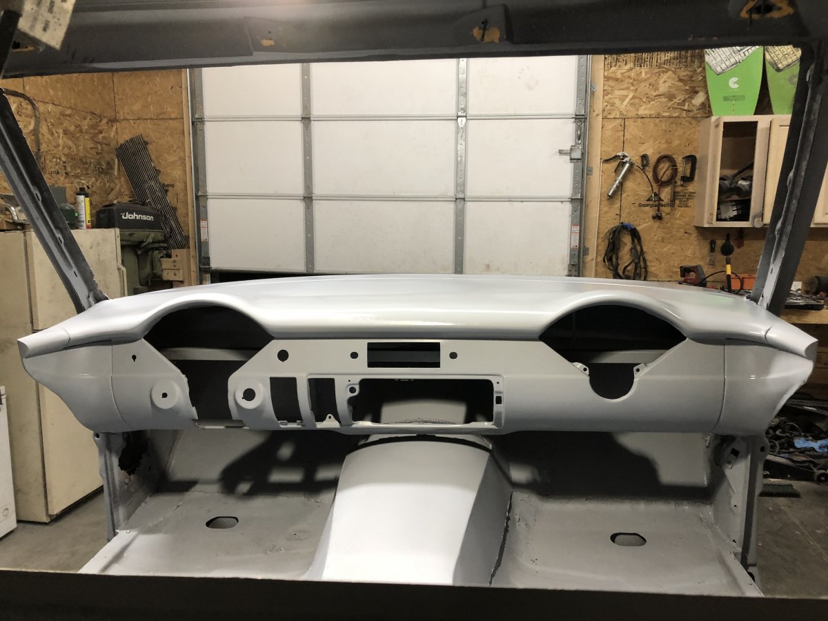

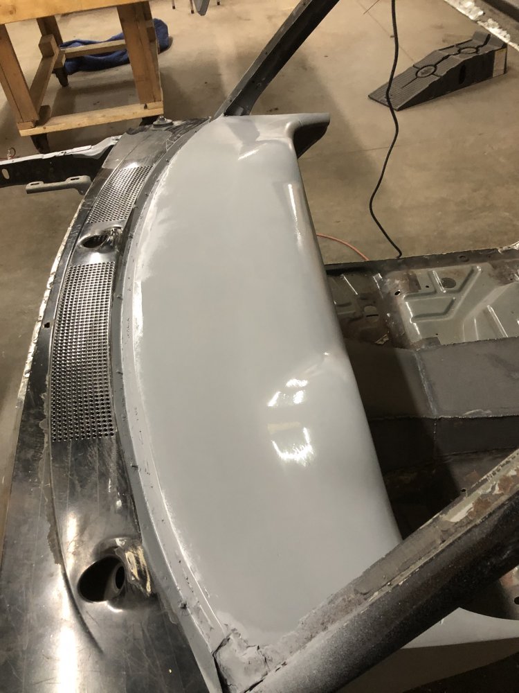

got the cab all finished up and laid a coat of primer on it tonight. doors and fenders are also in primer. time to switch gears and get the frame painted. Then motor tear down, rebuild, big cam, hi flow oil pump, intake etc..
