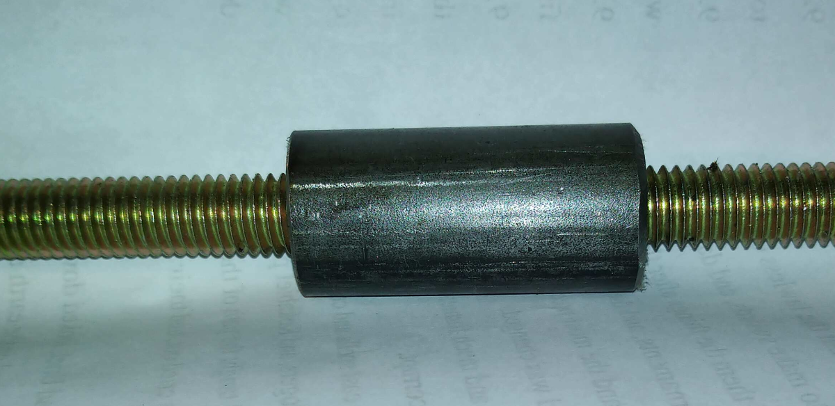

What I did to make replacement hardware for my body mounts you can do with the rubber rollers too, so the tap bolts threads (I use 1/2 coarse x 8" grade 8) do not eat up the rubber. Get 1" tubing, 1/4" wall, drill the center out to true 1/2, drill the bushing-roller out to 1", and cut the tubing to length. Attached is what I did to use my new James Duff poly body mounts with a ghetto fab 3" body lift. I drilled out all but the two radiator mounts, out to 1" and inserted these bushings into them. I chamfered the edges to ease assembly. So, they would not fall out while assembling I used a squirt of hot glue while twisting them into the poly mounts.
