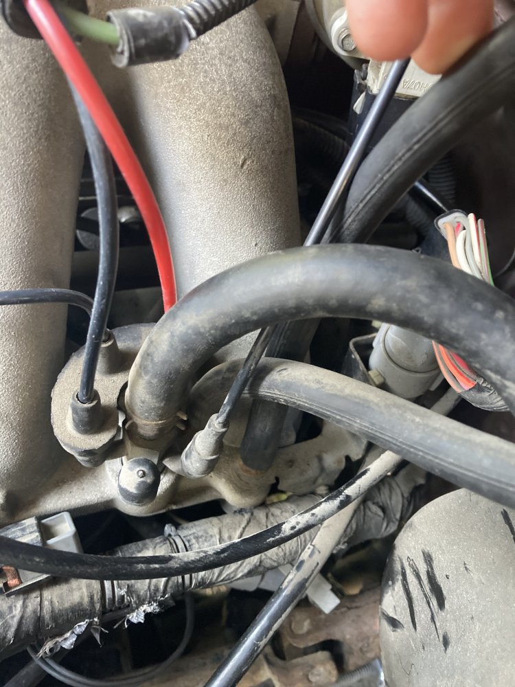

Okay I’ll look into that, thank you. I was wondering if this might be causing some problems. Basically, there was a vacuum line that used to go to cruise control or something and I just have it capped off on a bolt sticking out there. It’s hard to tell but it’s the one on the right side.
