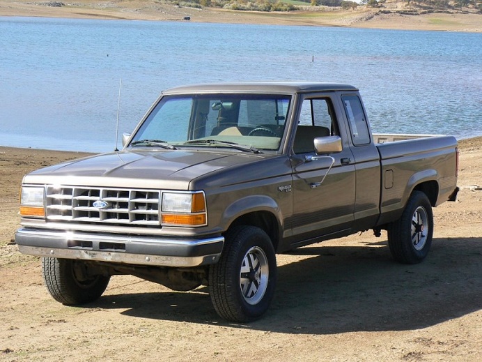

I just got a killer deal on a 1990 ford ranger pickup 4x4 for 1000's bucks and it the cleanest ranger I've seen to date... but the only thing is that its an auto! Ive heard that they are not that big of a swap but what am I really looking at getting my self into... My best friends who both have rangers said I could use their brothers bronco 2 for anything I wanted and Its a stick and still runs and drives.... If I have the doner car beside me how big of a deal is it? thanks
