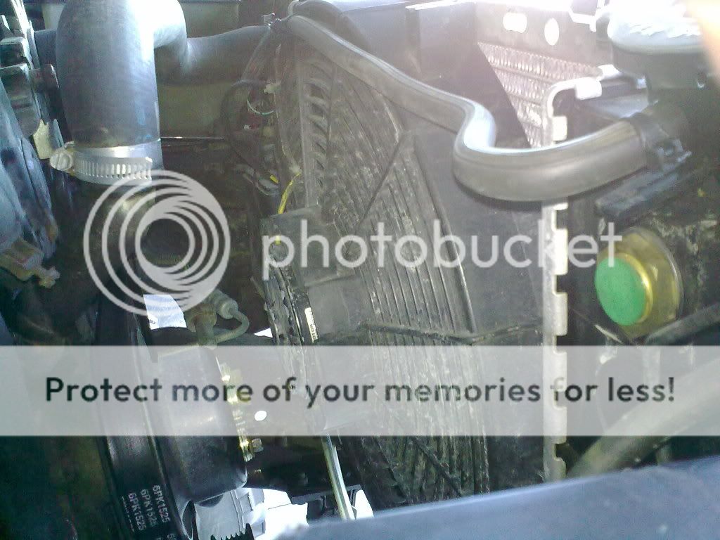

Besides all the what's been going on, I have replaced the oxygen sensor that I got cheap off ebay, and finally got the electric fan installed.
89 ranger SAS build
The fan off a 90's camaro $5 from my brother

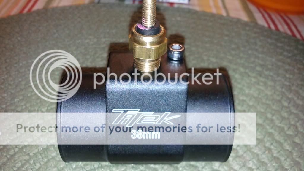

Fan temp switch in an adapter in lower radiator hose. Temp switch got from AutoZone for $3 and the adapter off ebay $12.

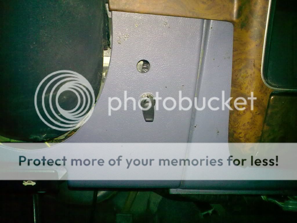

A three way switch. Auto/Off/On $free
Works pretty good for less than $21. The new oxygen sensor should help on the gas mileage and make run a little better.
