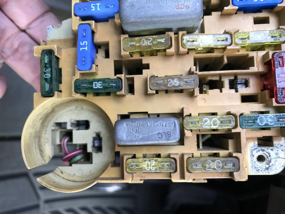

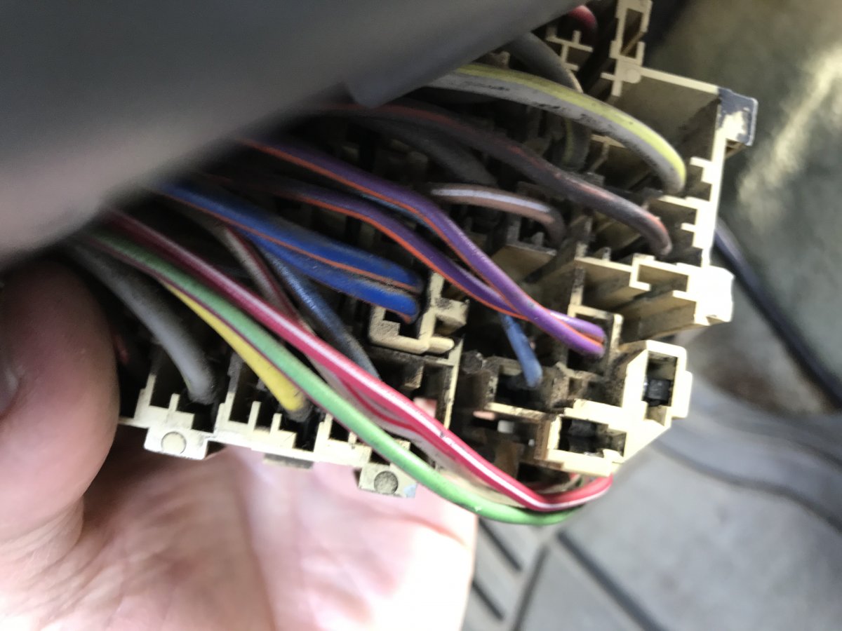

A new heavy duty flasher did not fix the problem. So I am trying to figure out the 12v flow through the fuse panel. On the back side of the fuse panel where all the wires come in I get a good solid 12v reading on the metal contact behind where the green with red stripe wire and the red with white stripe come in. No 12v on other side where flasher plugs in. Interesting I get 12v reading on the green with red stripe at the brake pedal switch. No 12v to flasher. Shouldn't 12v be present where the flasher plugs in??????? Niether of the wiring diagrams I have are correct, the both show 2 flashers this truck has only one. PS I checked for continuity rear lights to ground both sockets good. The attached photos are the fuse panel. IMG-0062 bottom left is where flasher plugs in. IMG-0066 back side of fuse panel. where the 3 wires wrap around that is the flasher corner. I can probe for 12v and get a good reading metal contact between the blue wire and the wires that wrap around the corner. It is just a metal contact on back side no wires where I get 12v. Voltage is not passing to the flasher plug in side.

Your fusebox doesn't have a second flasher on the backside, just opposite of the turn flasher? Is there a spot for it? That would be why they don't work.

The Hazard flasher plugs in here:
:)SOOOO I will try plugging a flasher in the back side. I will give it a try
All works now. So I am new at this site. How do I give you points for your expert advice? Thanks

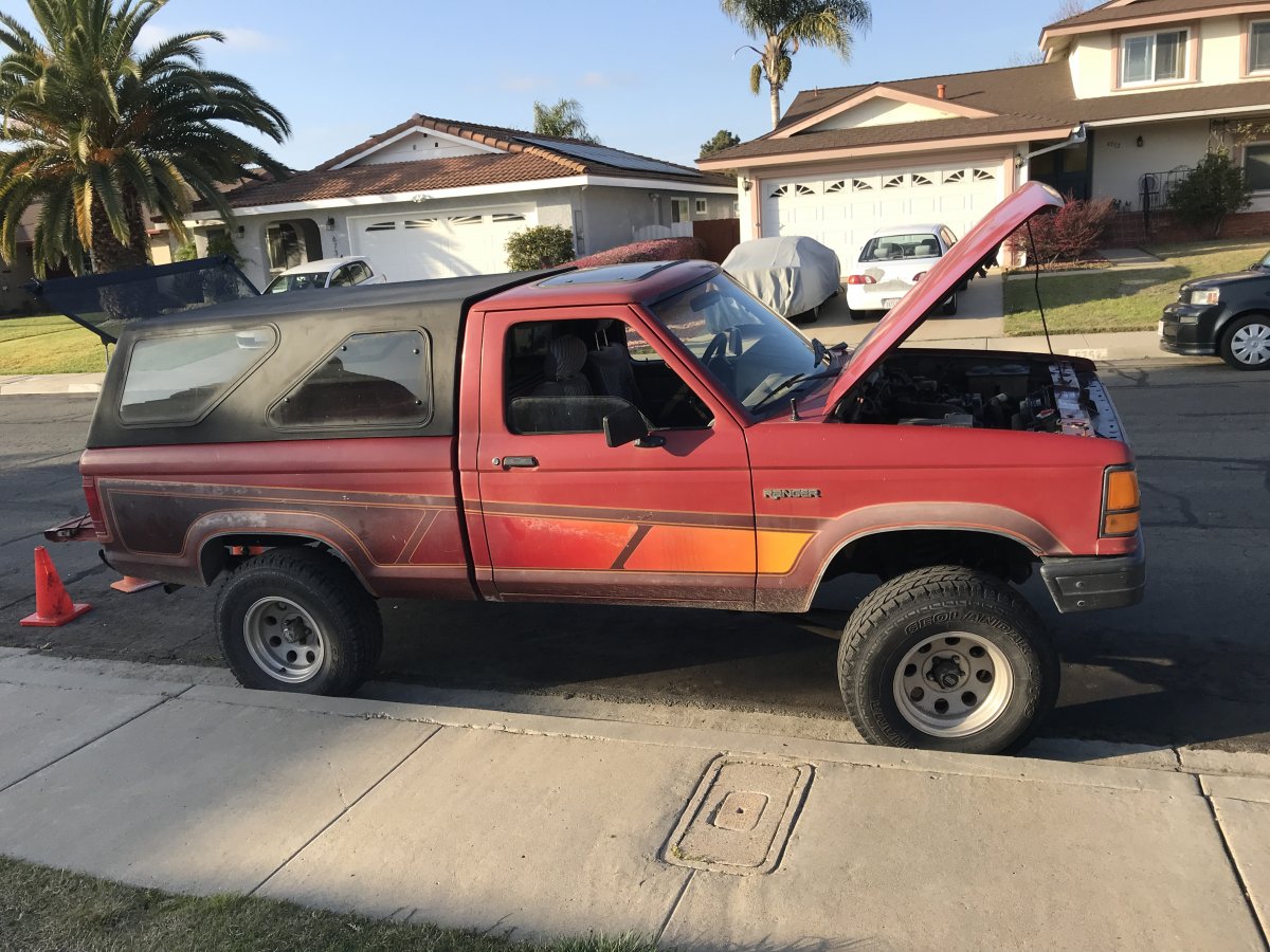

Here is a photo of the old Ranger you helped today. THANKS The photo is of the good side other side has some door jam damage no easy fix. My son bought this truck maybe 20 years ago. He lets me use it every once in a while.
Lots and lots of miles on the original 2.3. Tranny is a little newer, nice shifter.
