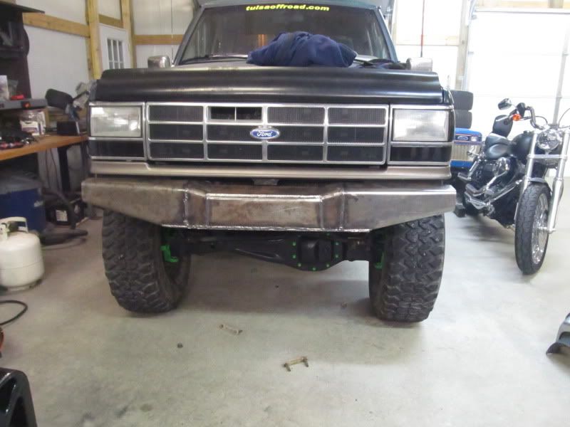

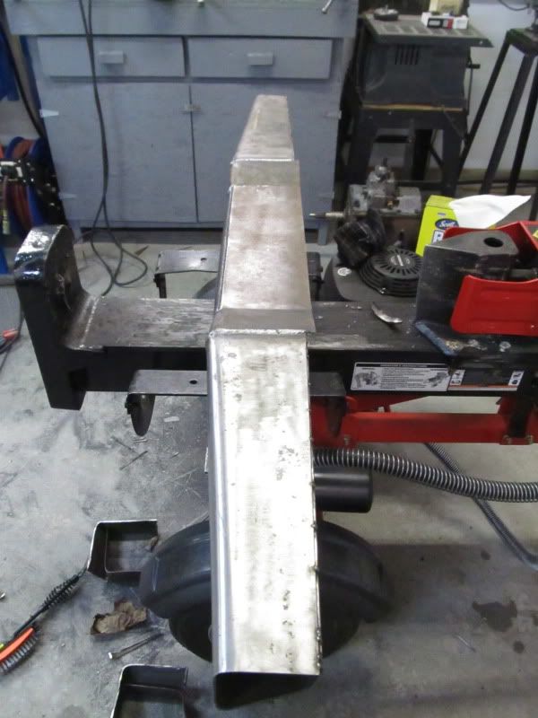

Well It was work on the truck sunday again after I got the rest of my stuff done. I got back to my front bumper, I didn't like part of the one I started. Out came the grinder and cutting wheel. I hacked some parts out and bent up some new. Then burnt some rods ! here it is again not much different then before but looks better to me. I still have to finish the ends going to turn them around the corner a lil bit to finish out the fender.
kinda cool shot this was done with a stick welder .
The grinder didn't wanna play nice and jumped out and bit me glad I had gloves on but it was one of those I should have known better things:nono:

the cut/turn not ideal.
but none the less livable.

Got the bumper almost done still going to add some tube and lights here is a pic I will add some more of the build but im to tired right now!
The truck also got some new shocks and cab mounts over the last few days
I must say new cab mounts and the new shocks. Its almost like a new truck from how it rattled and rode before. So here is the bumper painted I still need to get it pushed up and in the right place but thats hard todo with out an extra hand.
