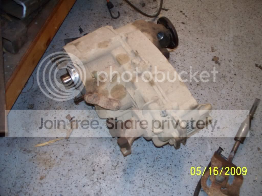

Bought 1354 Manual t-case with lever $150

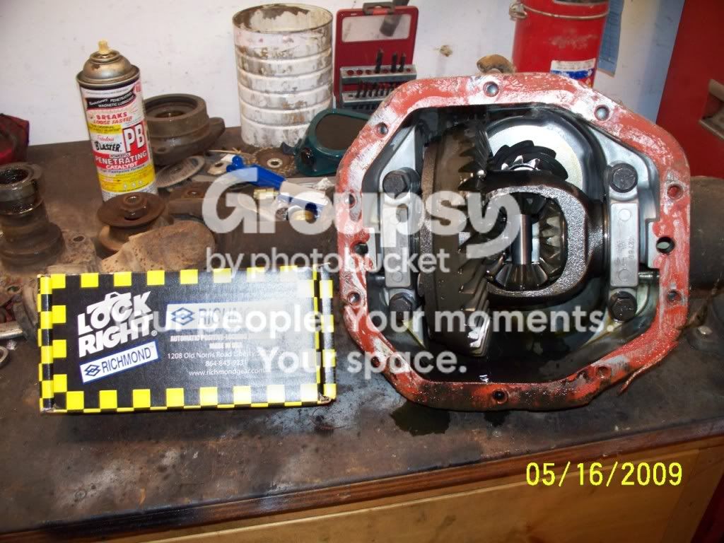

also installing disc brake 8.8 rear, with 4.10s I have allready, welding rear end.

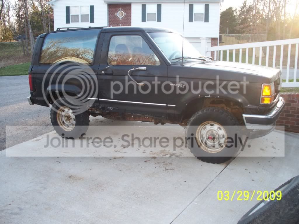

Current state until this weekend.
Lol little while back will never look the same.

rear end is almost done other than finishing brakes, and make sure shock im gonna use arent to long, has 8.8 now with disk brakes , 4.10s, welded
