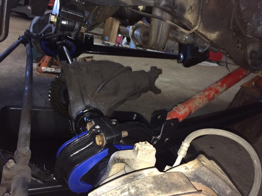

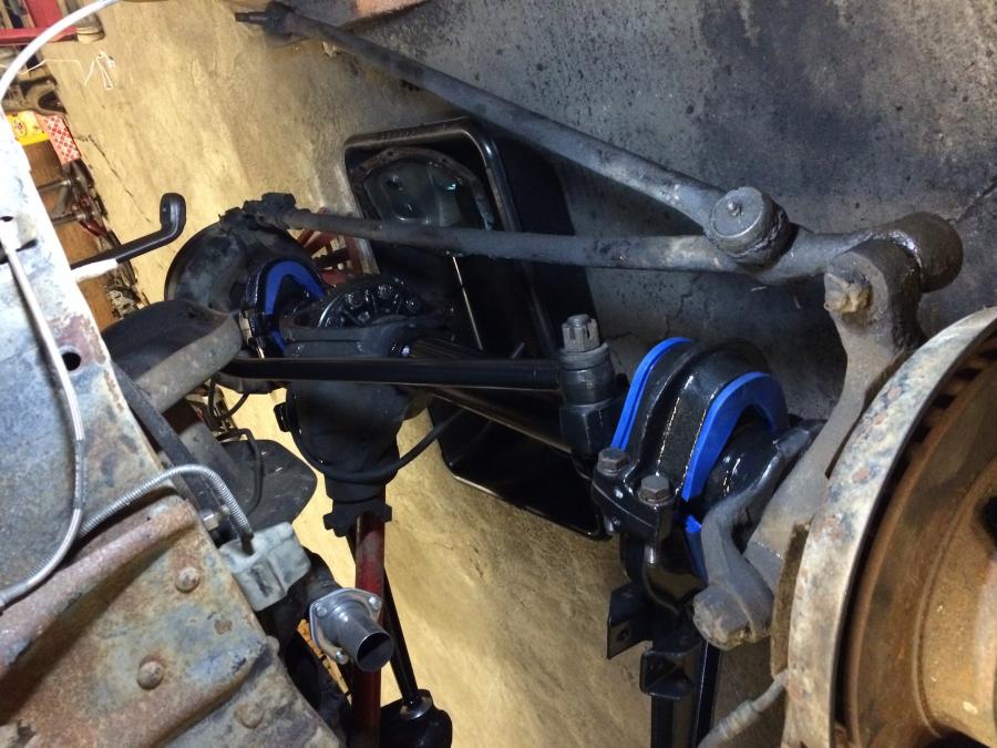

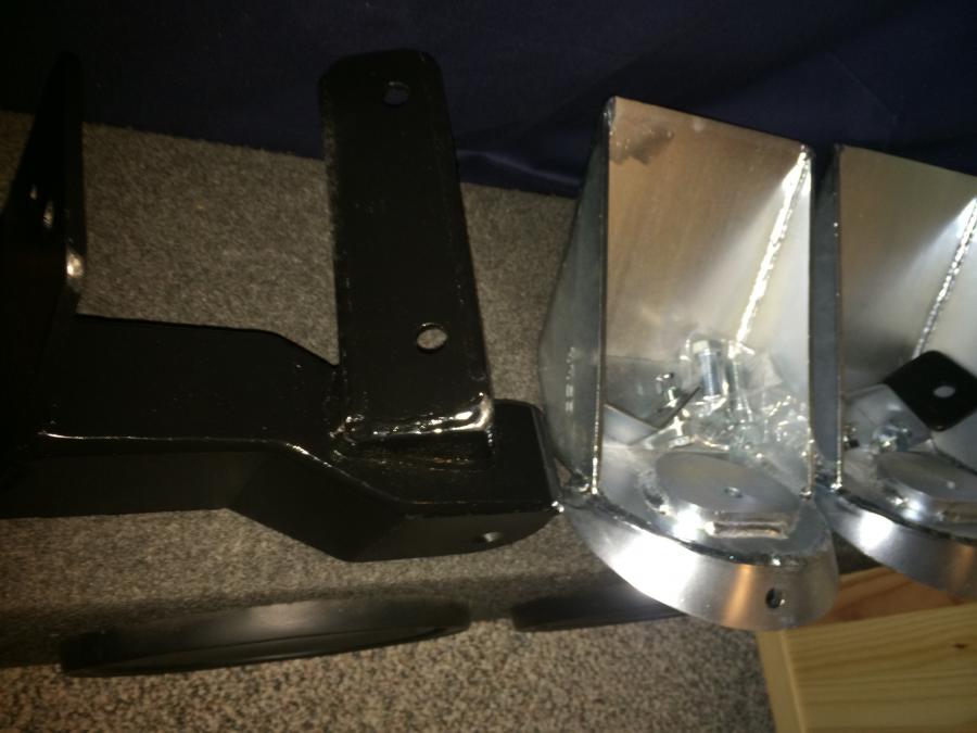

Okay so I've been working on my SAS swap for a little while now and I've hit a bump. I'm not really sure what to do so I wanted some advice or opinions on what to do. I've got the axle under the truck, radius arms bolted on, duff 7 degree bushings, and all new radius arm bushings. I installed the duff tuff track bar mount to the frame and crossmember. Here comes the tricky part. I managed to put the track bar in but had to use a ratchet strap to pull it toward the axle to bolt it up. The frame mount where the track bar is... The track bar is twisted, not looking good. Should I buy an adjustable track bar to help with this?
Also I noticed with it installed is the axle is not equal under the truck. Sticks out further on the passenger side. This is another reason I think I need an adjustable one. Anyone got any help or ideas?

Your Radius arms are mounted too high for that track arm. A adjustable track arm will fix that but you need to get the truck on level ground if it isn't already. Take a angle finder and set it on the machined area on top of the knuckle. You want it to be about 7+- a deg to the rear of the truck for optimal steering. Where the radius arms set when the camber is set is where the radius arms will need to be mounted.
If the axel is shifted to the passenger side it means you need to lift the truck higher or shorten the track arm and a adjustable track arm will work fine..
