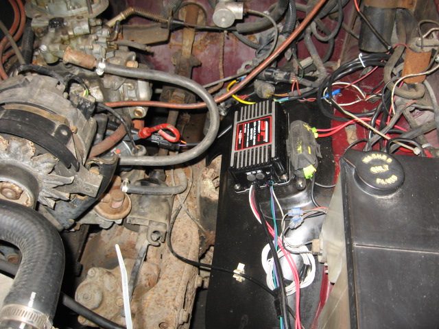

Got spark now. Have to finish up the wiring routing remove the Duraspark stuff and bolt the MSD down.
Next issue is I dont think its getting fuel

Hmmmm...that looks vaguely familiar...not the MSD box but the tangle of wires...lol

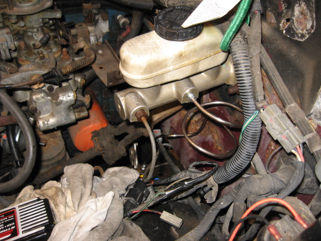

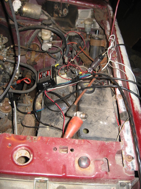

Ignition now hooked up and working. Checked fuel pump for flow. Hope to fire it up tomrrow

Looks like the nexrt issue is the brakes. The front brake line from the master cyl to the Tee at the frame is shot. But upon removing the line found the threads in the master cylinder to be screwed up. Guess I have to go with a reman cylinder.
That looks much cleaner...and I'd imagine you got it running if you are tackling the brakes...:icon_thumby:
Had similar issues with my first Ranger...one project leads to another...to another...took me about a year to actually get everything working as I wanted it...and then started over...
Anyway...replacing the master and running new brake lines is actually quite easy on these trucks...but if you have the time and resources I'd highly recommend changing the flex lines...soon...my front brakes kept binding after a hard stop (which was quite frequent in my commute) and finally figured out the flex lines had collapsed causing the brakes to lock up and not release...common issue, even with some of the newer trucks.

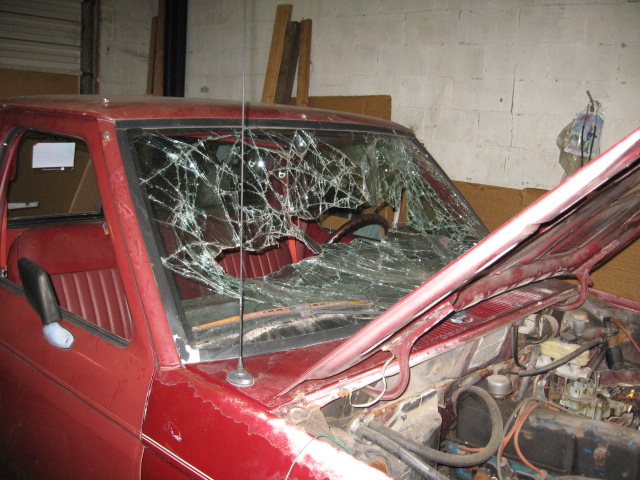

Check into a windshield. Cost for one of those shops that come to your place and install a new one 200.00. I could do it myself but for them or myself to do it has to be a lot warmer. Lucky to get my shop up to 50* for a couple hrs a day and wood supply is getting low. With the low temps lately lucky to hit 40*.

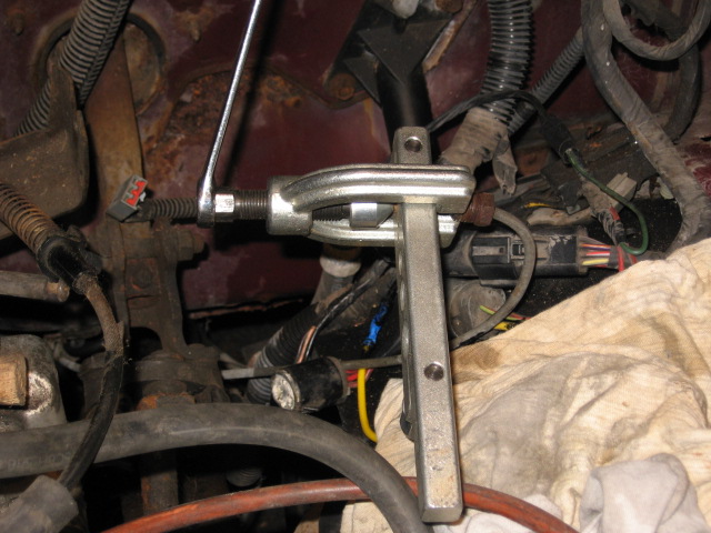

Upon removing the master cyl found the front (rear brake) line has be replaced before. They didnt flare the tube though. Now it is.
Had to make up a new line for the rear port (front brakes).
Dont know how many of you know about the copper nickle brake lines. They are easy to form and dont croade anothe pluss they pollish up nice.
I now wounder were the new rear brake line splices into the old and how it was done. Know one line to the passenger side of the rear axle is broken too. So guess thats next things to do.

I replaced them all at once many years ago. It was a learning experience but they are still working after all these years and still in pretty good shape.
Hardest part of the rear line is to get around the gas tank, but I found that if I split the line and used a joint connector I didn't have to use a single line. Much easier to do it that way except it's one more possible leak.
Like I'd said before, the flex lines on the front are worth doing now while you have everything apart...unless you are pressed for time or financial reasons. The flex line on the rear where the brake line feeds to is also an area of concern for rust...I've seen a few people take the bracket right out and replace it, but also cleaned up the frame in that area...
Removing the box makes it all so much easier...
