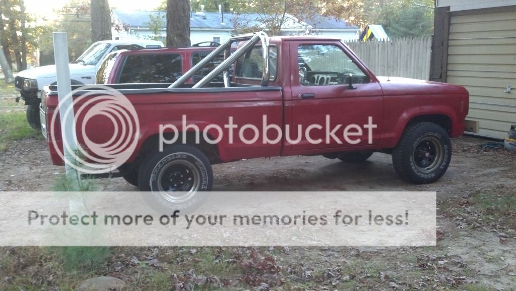

Another project for the trails no doubt. We've got an 88 2.3 4x4 manual trans. Here is how it sits at the moment. We've already installed bucket seats with a center console. Focused on body work firstly and cleaning up the rust on the frame.

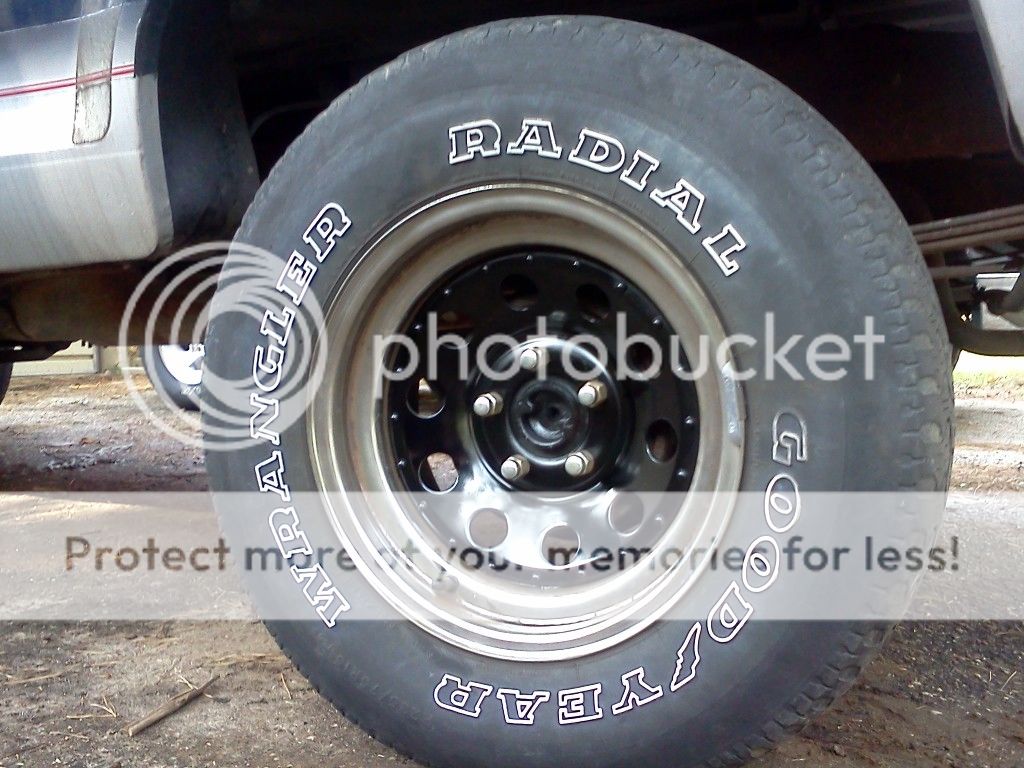

annnnddd... Heres the wheels painted.
Looks like a fun little project truck!! Your white ranger looks really good!!! Any pics of the white one.
Looking forward to this...Those wheels came out great! Gives me an option since mine are looking pretty rough. Damn road salt...

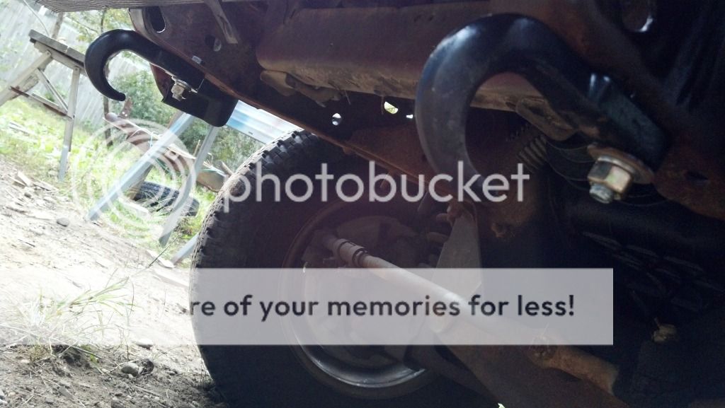

We now have front tow hooks!!!
P.S. - will drill and run a 2nd bolt on each hook when its not raining.
We're rebuilding the entire front end from scratch like I did with my truck. Not really a fan of what the aftermarket choices are. The custom grill should be cool and the bumper may take some time but will be unique!

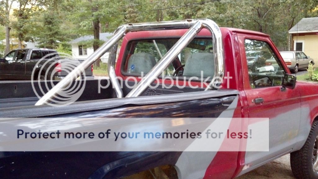

Roll bar is in place!

So since, have somewhat finished the bodywork. Roll bar is on. and we've layed down some paint. Need to get a good wetsand in and second layer it once we get the spray gun setup.

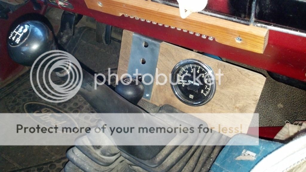

On the interior, started to install a tach and toggle switch board to control the lighting. Heres a pic of it tacked in.

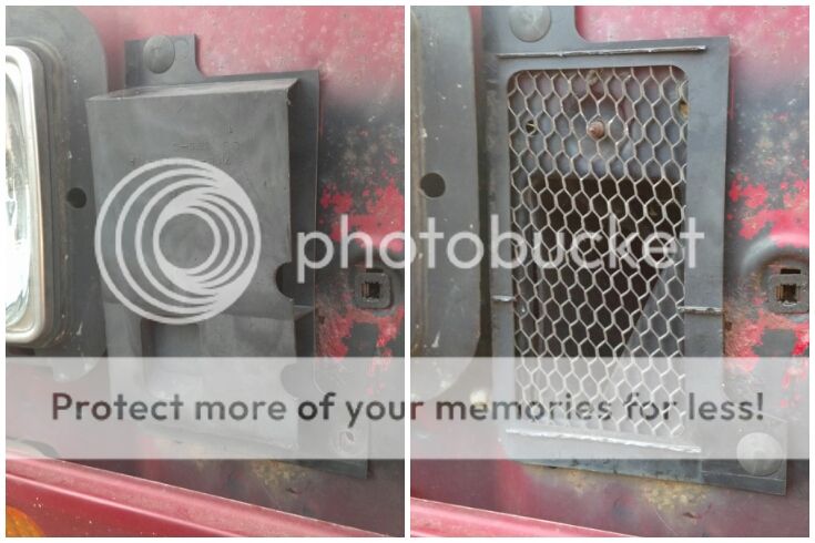

Air flow
Will add mesh screening to keep the bugs and crud out. Should definetley give more air flow.
