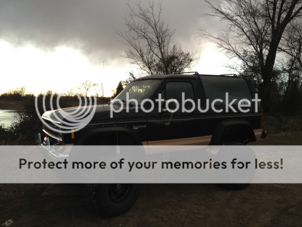

I realized I haven't updated in a while. I finally got the truck to a point where it is driveable.

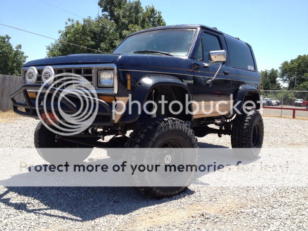

Here are some pictures of how its setting

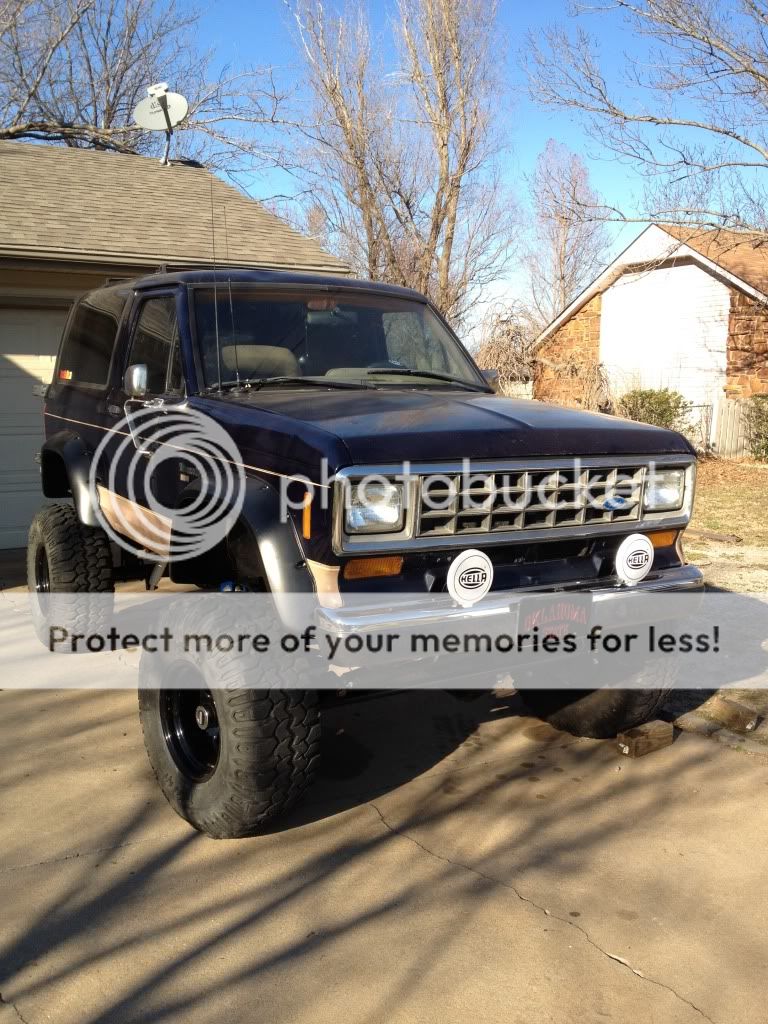

I added the Hella lights to the front
Moved the cheap fogs to the rear.

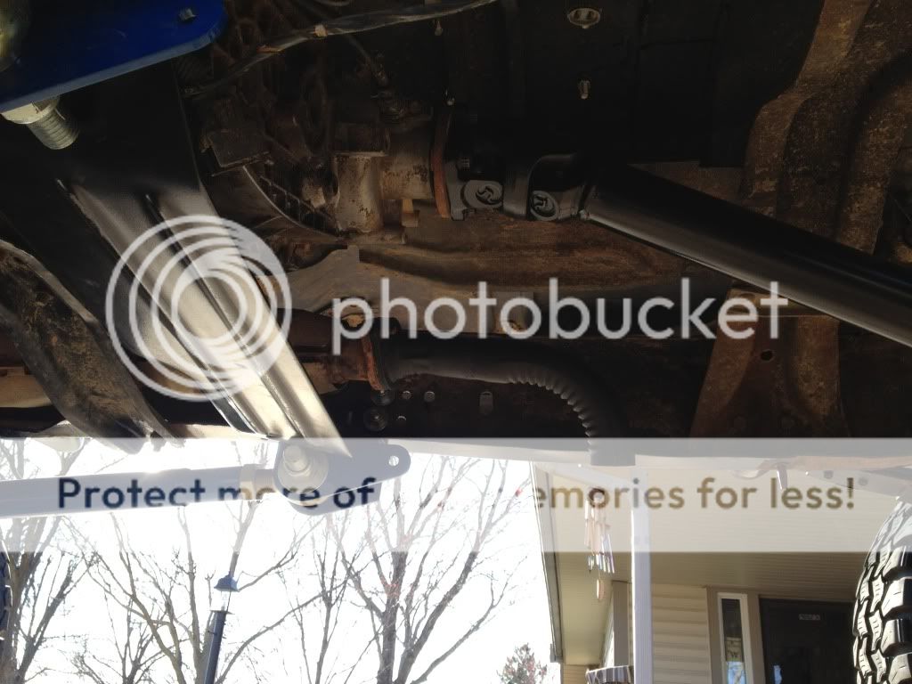

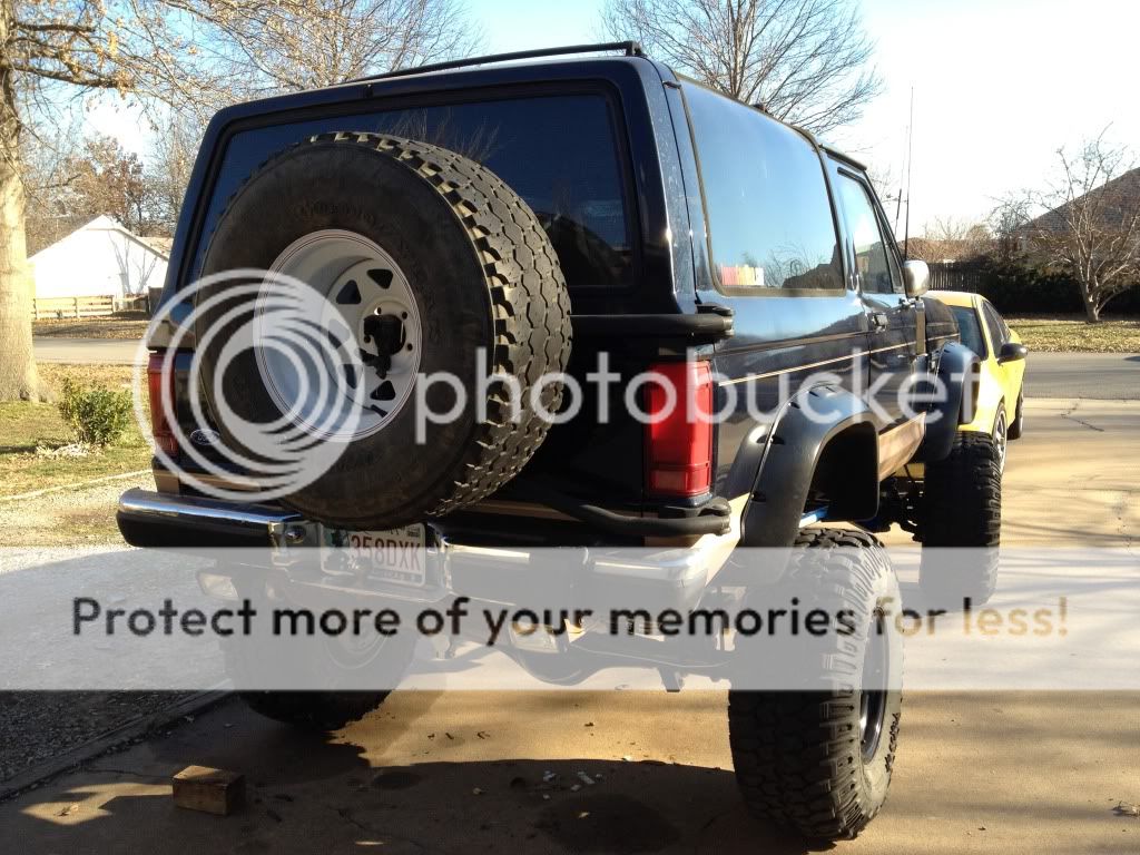

Turned down my exhaust. It's really not loud without the muffler. Figured out how to mount my skid plate.

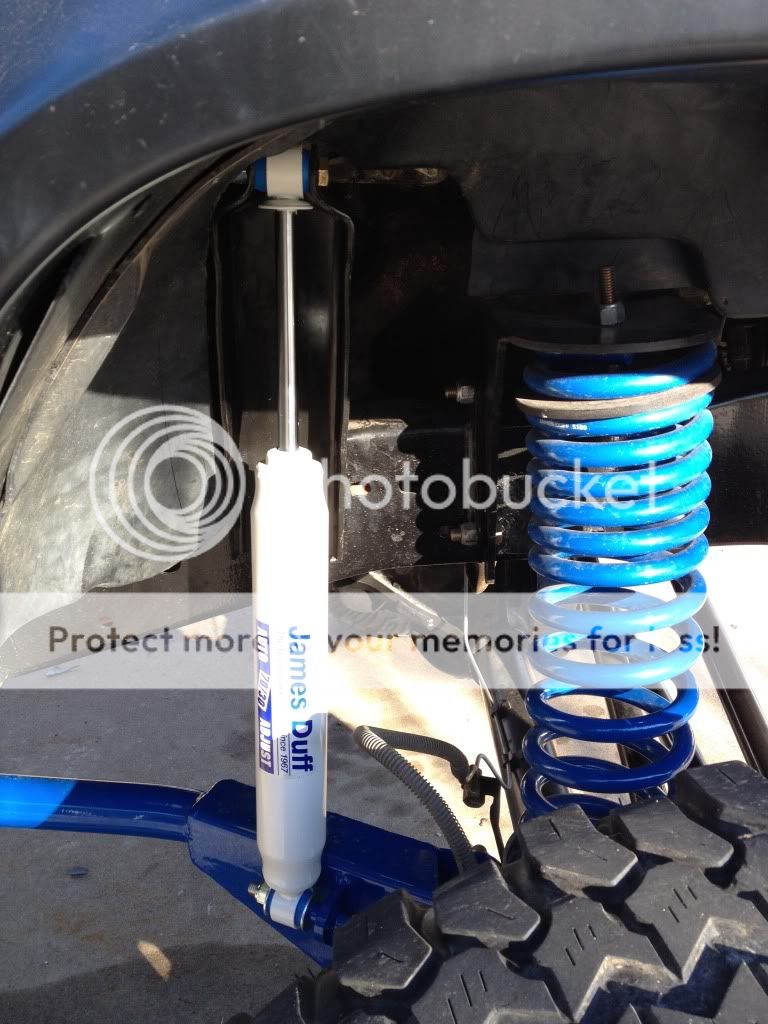

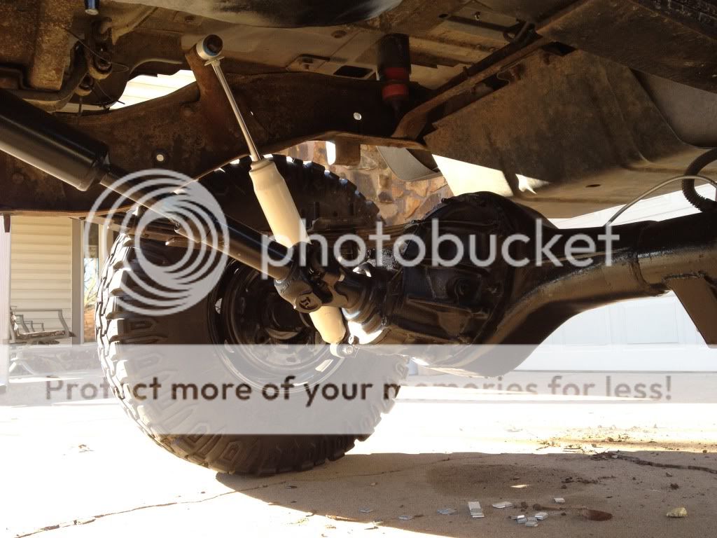

James Duff Shocks

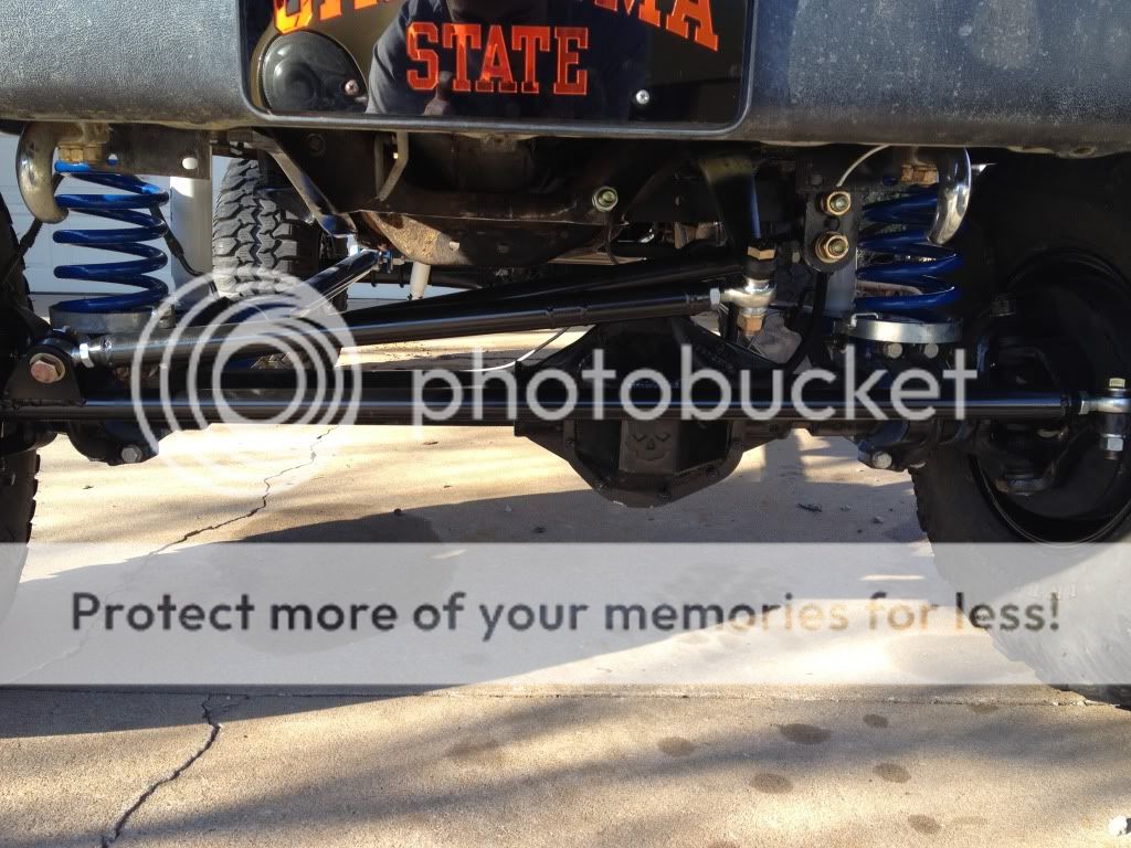

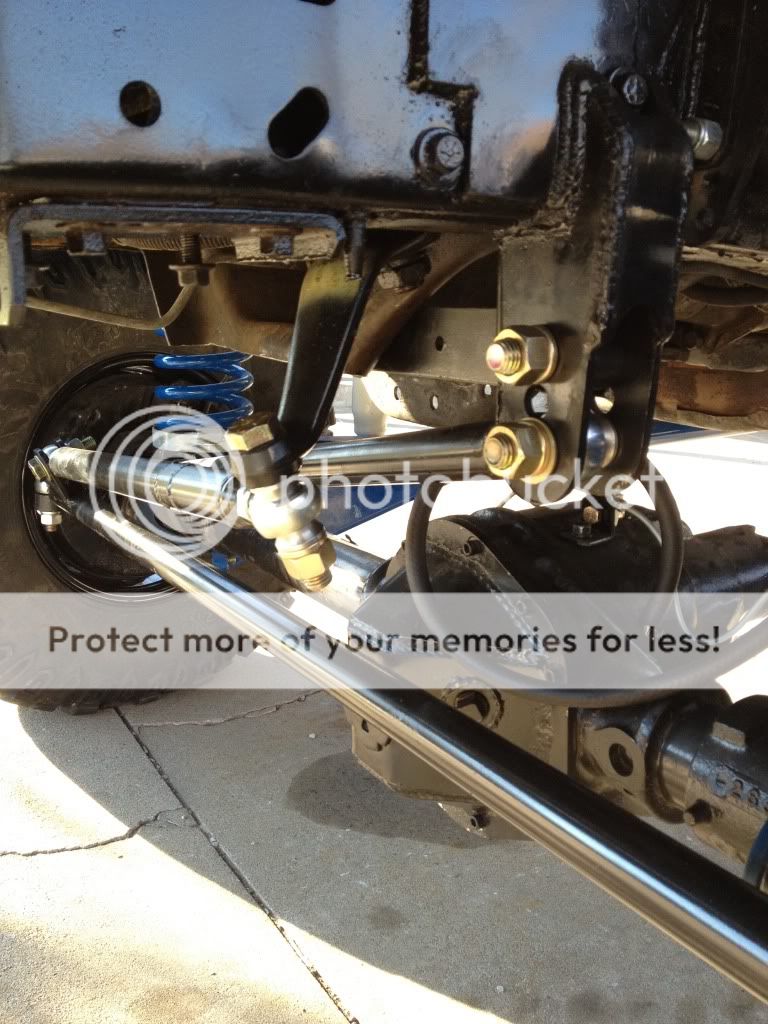

Steering Installed

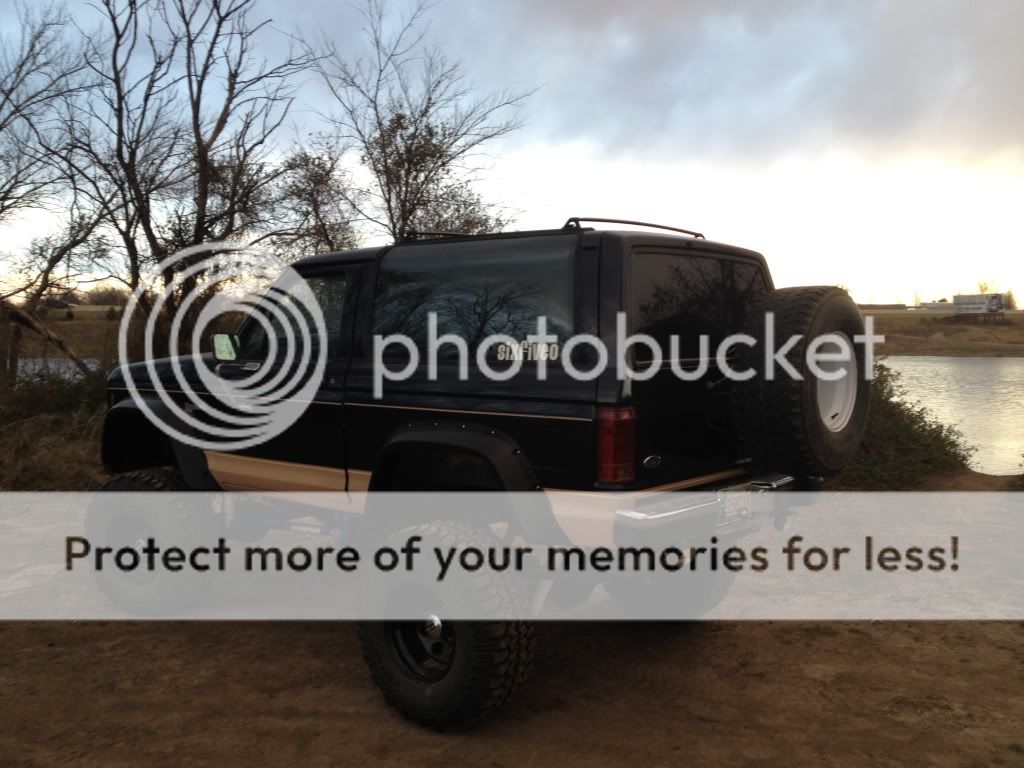

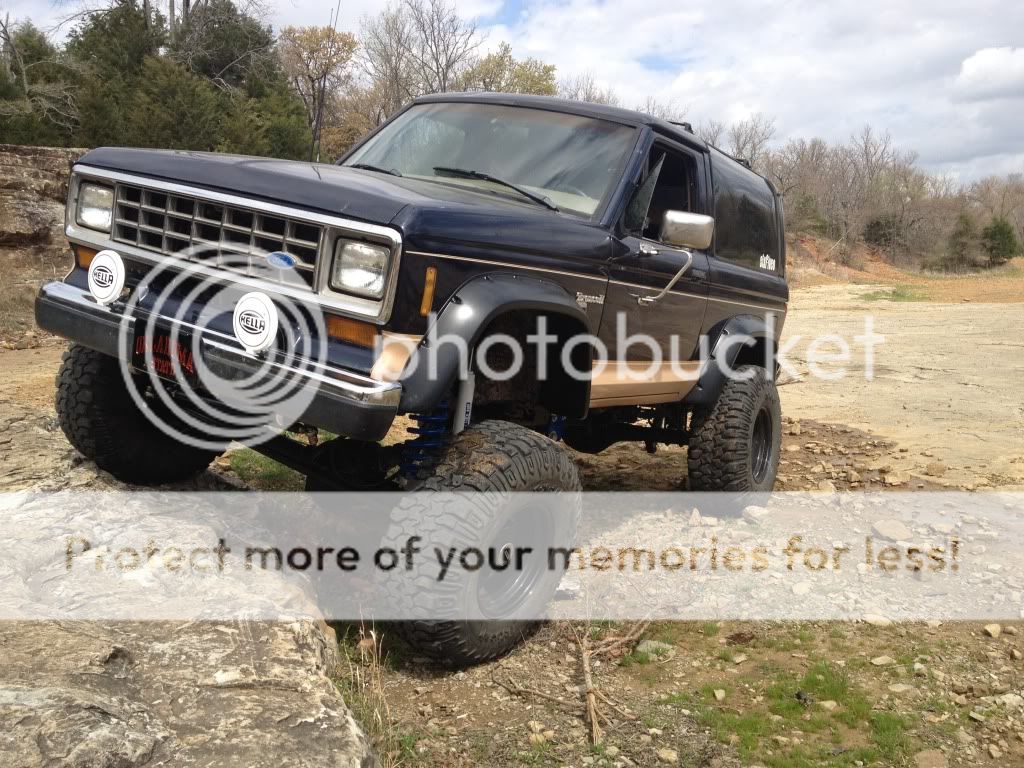

Even with the weak brakes, I was dying to drive it somewhere. About 100 yards from the neighborhood exit is a pasture with a pond in the back. Here are some pics.

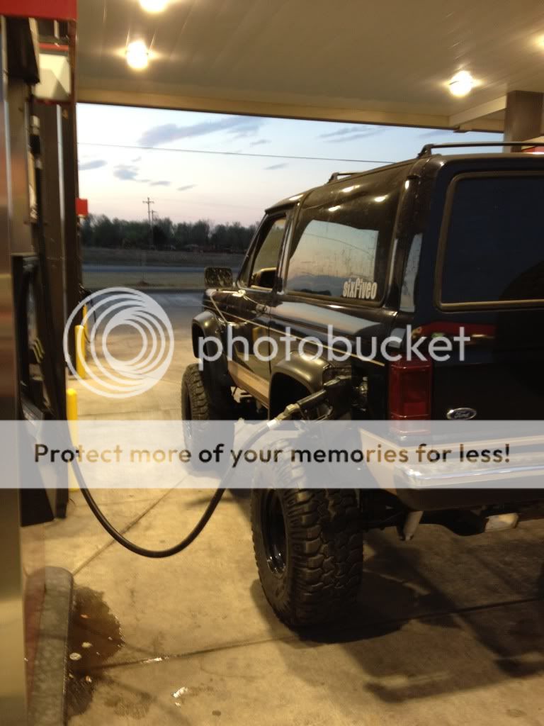

Filling up on gas for the first time in a year

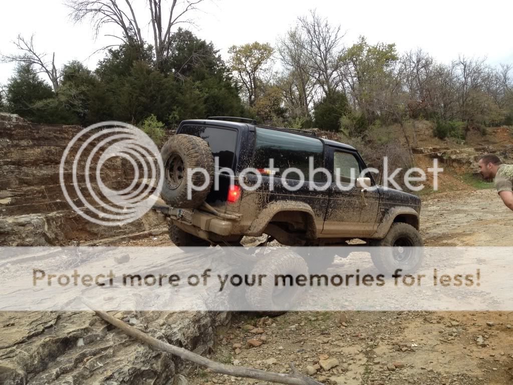

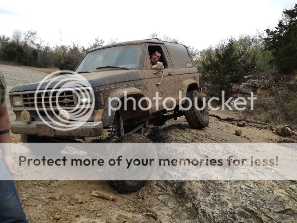

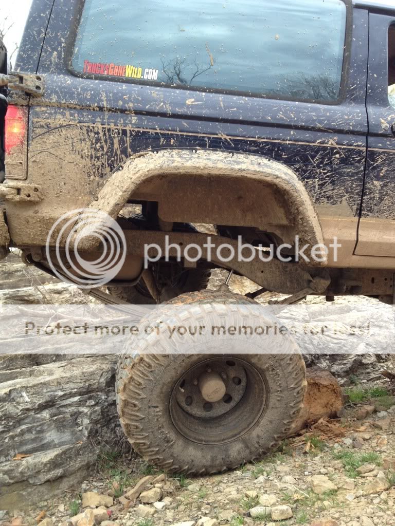

First rock ledge to climb over. Notice how stiff the springs are compared to the later pics.

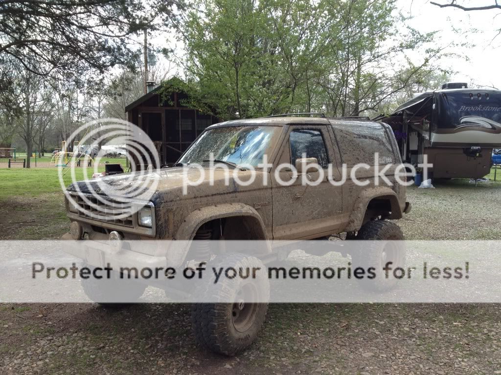

After the first day of wheeling, and back at the camp grounds.

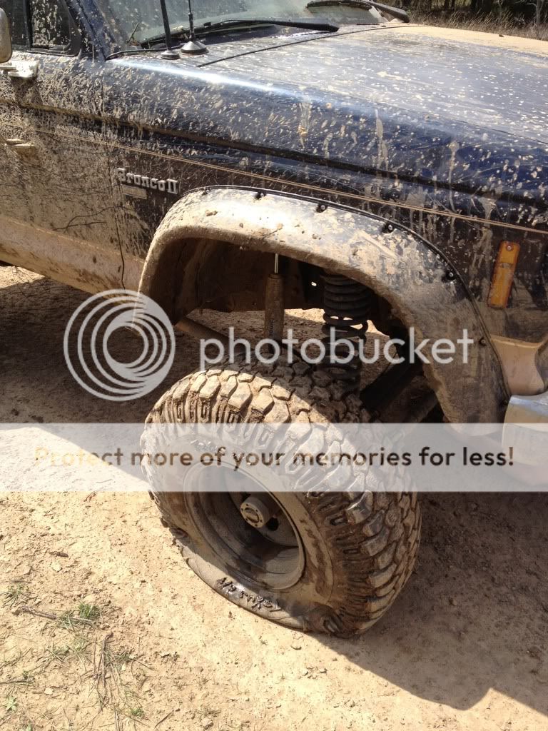

I blew both the front beads within five minutes after being there.

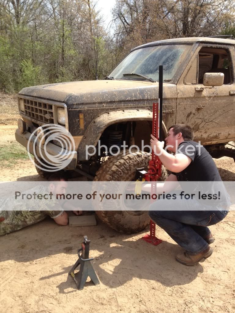

I had to use the high lift jack for the first time.

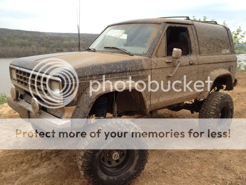

Made it to a cliff over looking the Arkansas River.

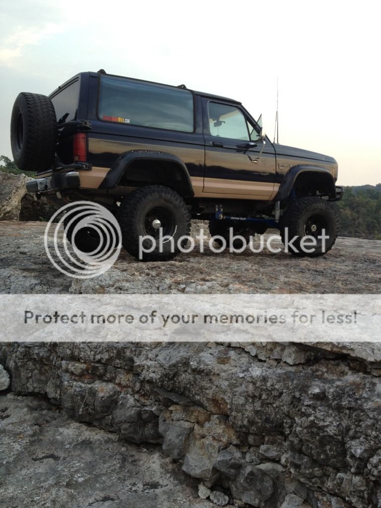

At the end of day 2 I flexed the suspension on that same rock ledge as the first day to compare flex after the springs were broken in.

I had my tires mounted at Walmart because of cost, but I think this is the reason the beads gave way so easily with full pressure (31 psi) still in the tires.
I'm just afraid that if I drop the cash on the dyna beads, I will be SOL if another bead gives way on the trail. I havent seen any bead locks for a decent price lately either.

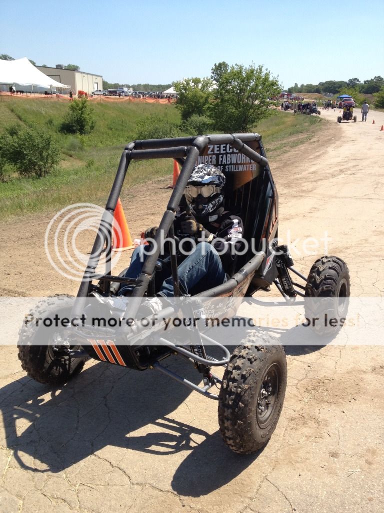

Here is on school project that has kept me very busy. It was the OSU mini baja car that competed in Burlington, WI, in early June.
It turned out better than anyone expected.

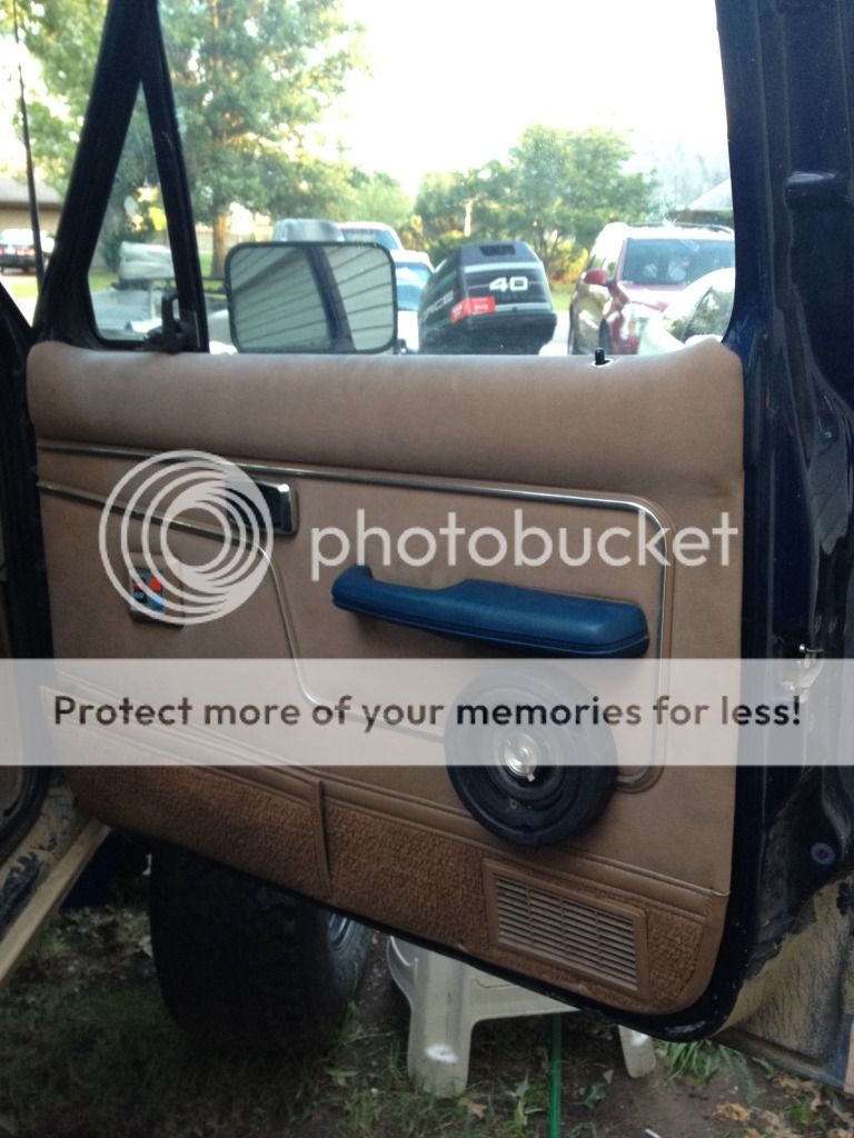

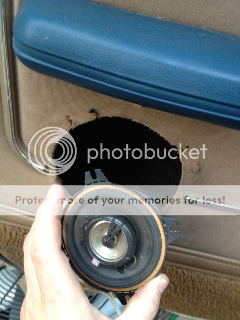

I also installed the stereo finally. In first gen explorer dashes you dont even have to buy a dash kit. I had to really scratch my head on the speakers in the doors though. The previous owner cut 6 inch holes in the door panels. You can see what me and my buddy came up with.
The speaker pods are bolted to the door panel, and are made out of mdf.

Sweet SAE Baja Car! I was on my schools team the 5 yrs i was there ('05-'09). Between that, school work and the formula team, there is no time for home projects. The car looks great. Hope you guys did well at competition!
Awesome thanks! I have learned a ton from this team. I was the president last year, but this year I will just be around to give advice.

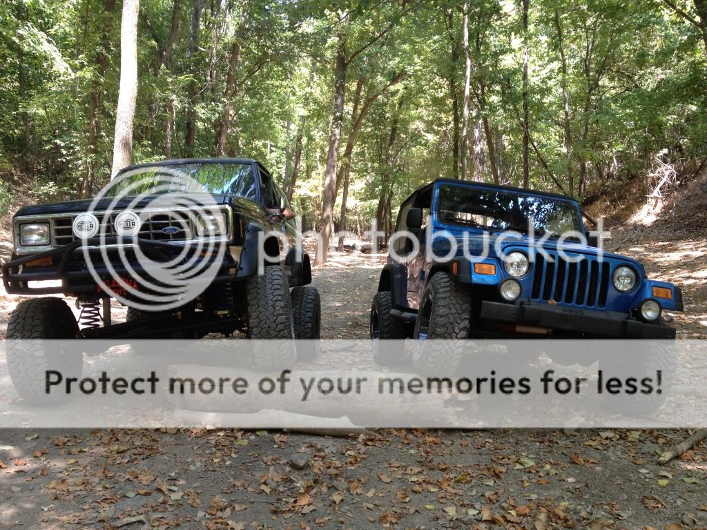

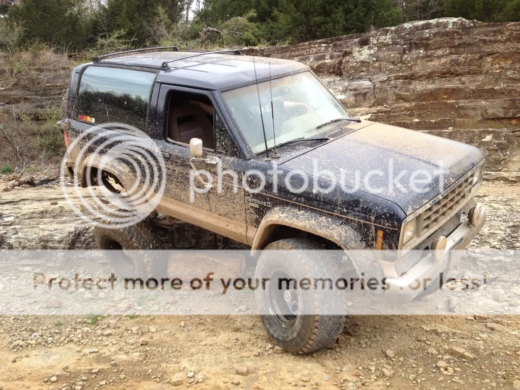

Its time to make an update. I made it out to Hogan's offroad park in Disney, Ok, this past weekend. If you ever have an opportunity to go you should take it. We had a blast! Here are some pictures of the rigs.
This is in a creek bed known as halfpipe prior to hitting the trails
We apparently got lost, but it made it more of an adventure.

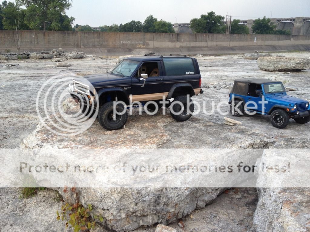

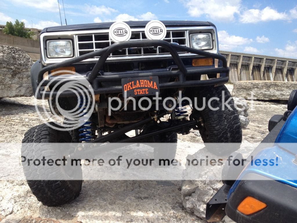

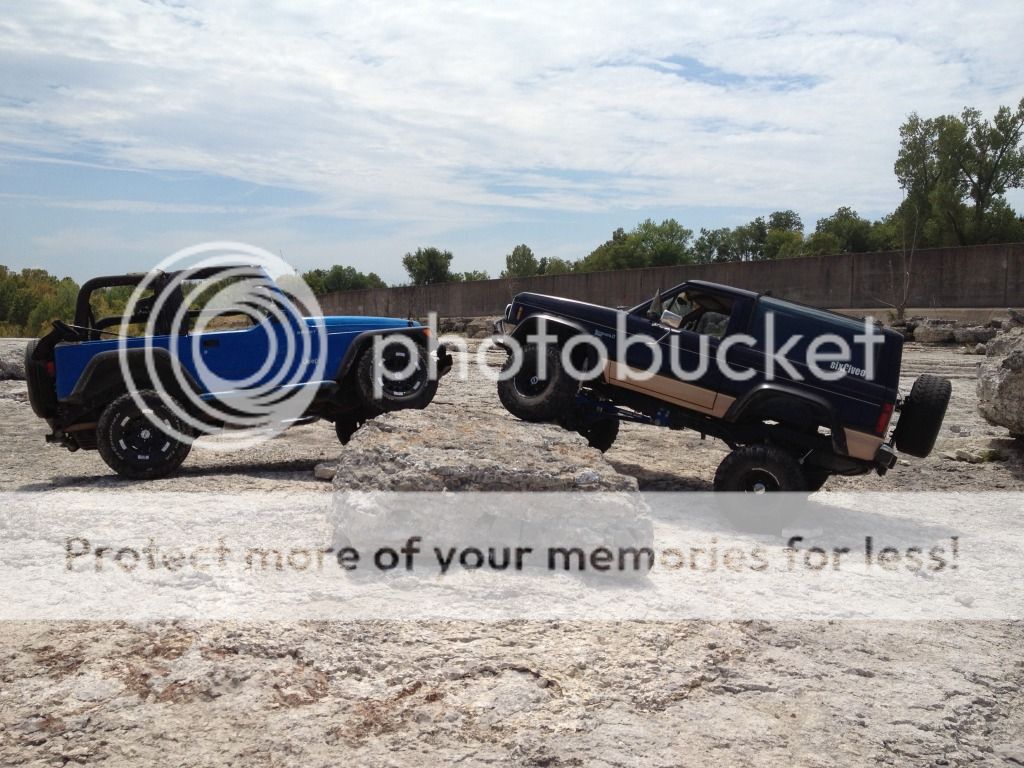

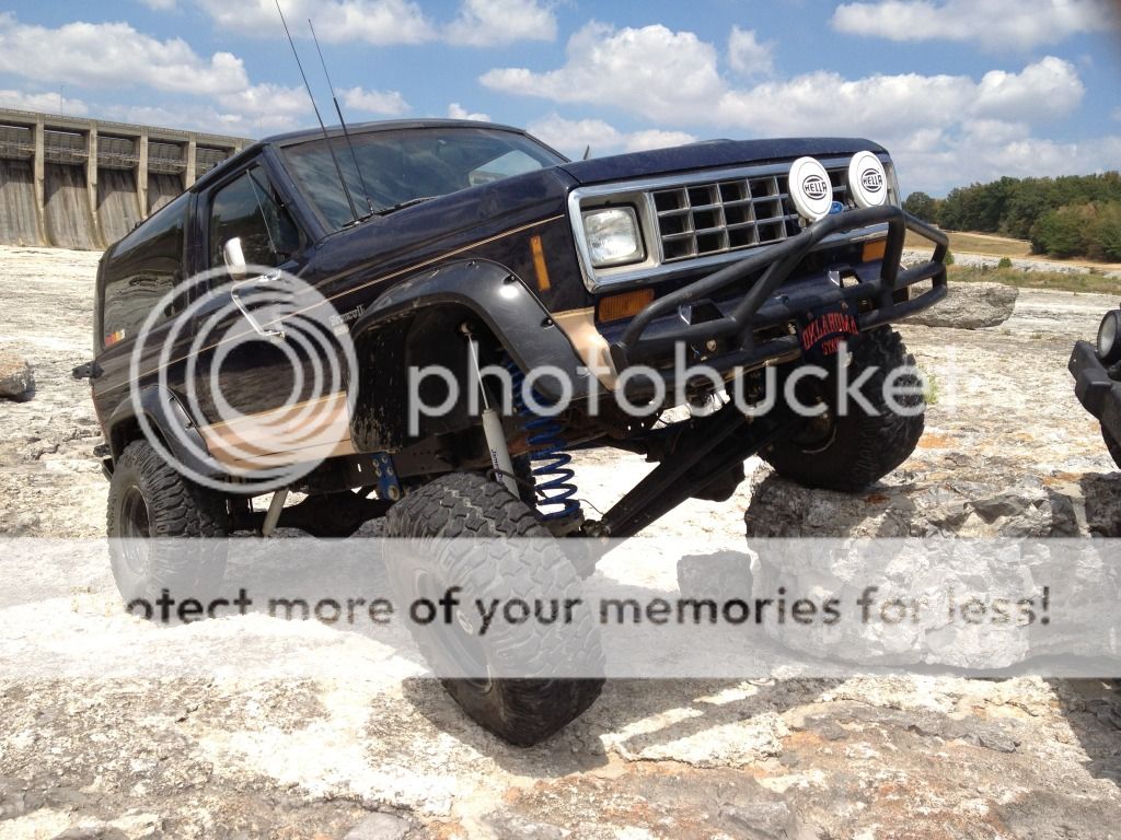

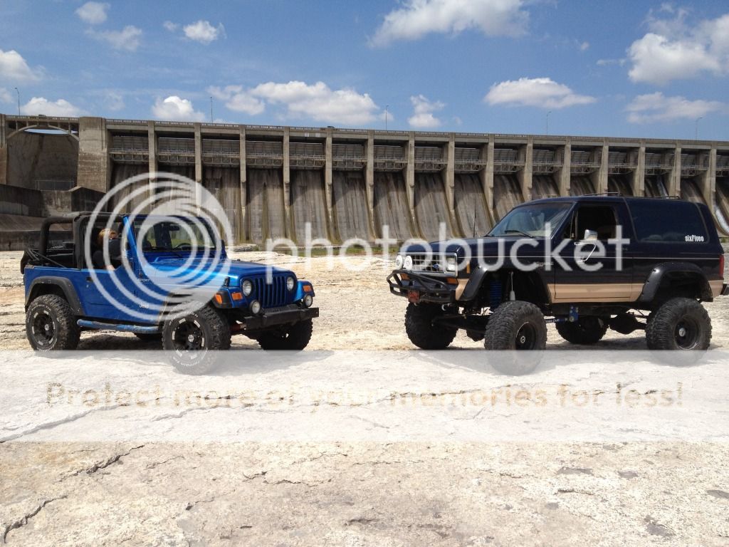

To end saturday we decided to hit the rocks below Grand Lake Dam.

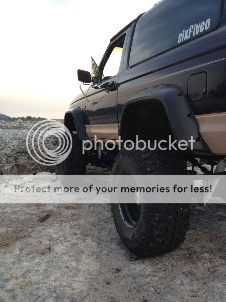

The bronco definately surprised me.

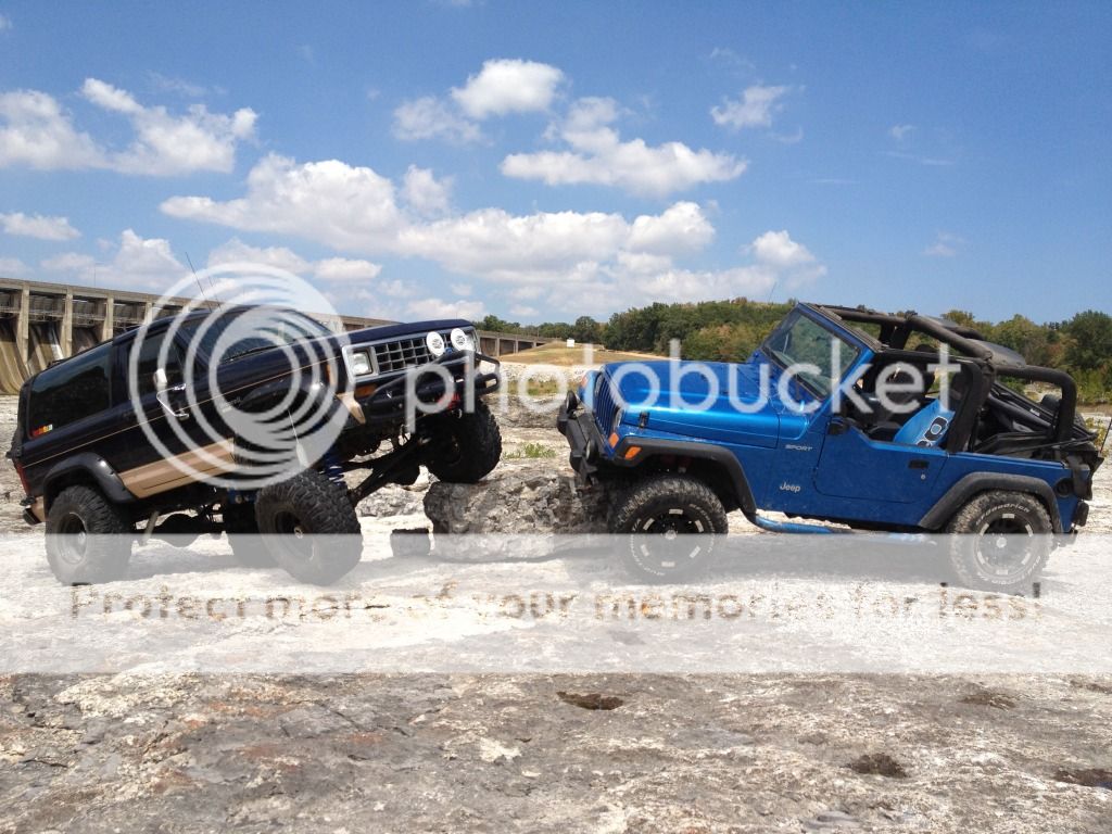

Then sunday we decided to make one more trail run, and the take somemore pictures at the rocks.

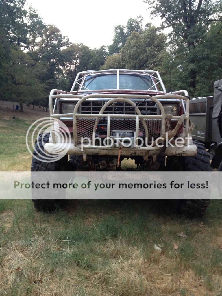

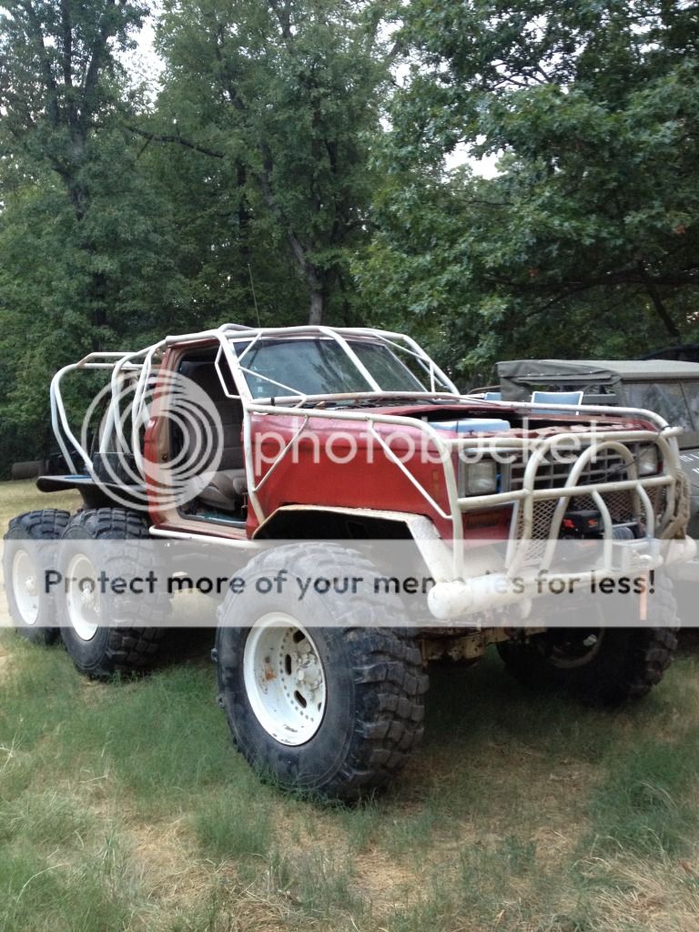

This is the owners tow rig incase you get in over your head. It is a deuce and a half chassis with a ranger cab and a 460 under the hood. It also has a pto winch in the rear.
We had so much fun on the trails, but we didn't get many pictures.
