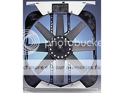

Just won this on an ebay auction for $100. Re-manufactured, with all hardware included.
Flex a lite 40. Reg. price is $217 at Jegs and Summit
Ready to see how it works!
