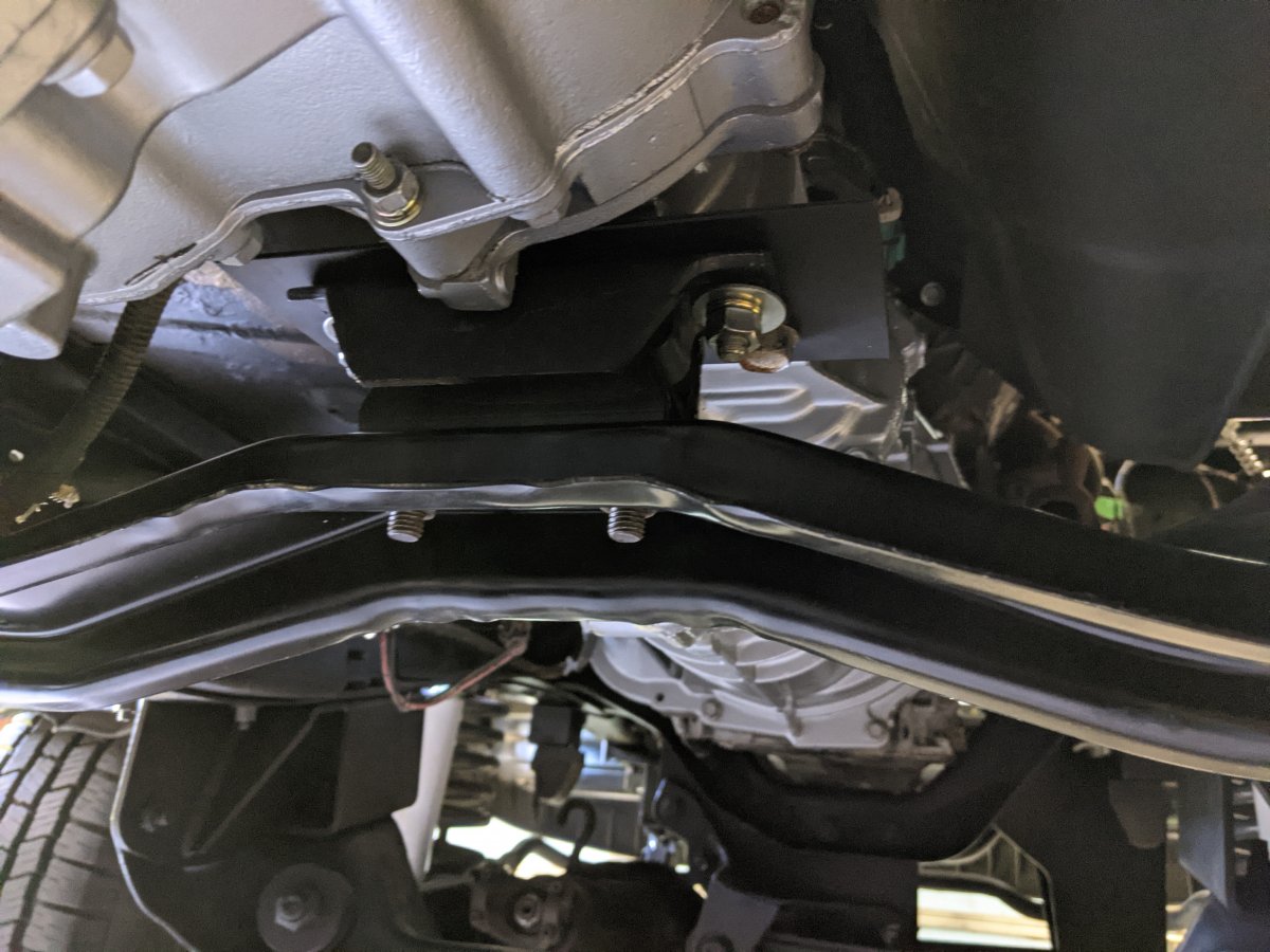

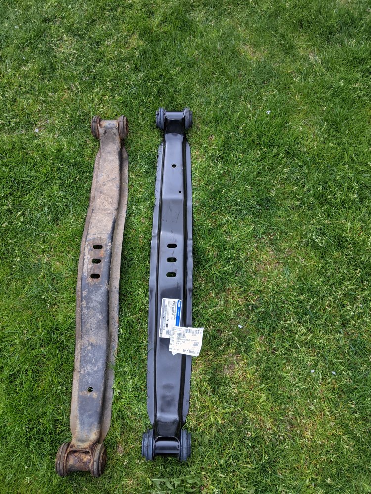

Hi All just thought I'd send an update on the 4.0 Sohc swap. Progress is slow but installed new clutch and reinstalled trany and transfer case . I had to make a plate for the transmission to cross member to install transmission mount. Back as far as I could go on the right side engine mount so ended up being 1/2 shy of it dropping in. Pick up a transmission cross member from Tasca parts fit was perfect . PXL_20210502_203958647.jpgPXL_20210423_225805741.jpgcheers everyone
