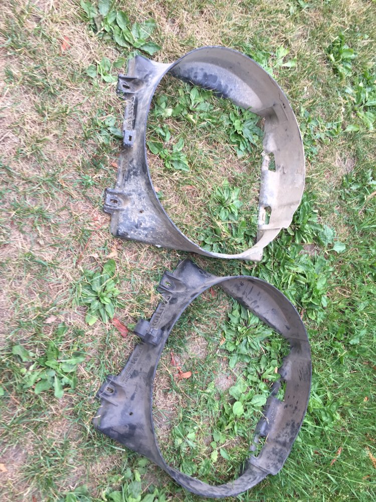

Those are closer to what you're looking for
I got two up here is southern Michigan.
