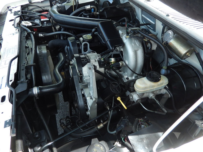

Where did you find the insulation? Mine was falling down when I was in high school 15+ years ago so I just finished it off and pitched it.
I got mine from Class-Tech-Cars. Here's a link: Ford Ranger '83-'92 Hood Insulation
They're also on eBay.
If I ever find a Ford manufactured or branded one I'll get it.
And the Ford part number for the clips is: N803613S
Not a bad price either.

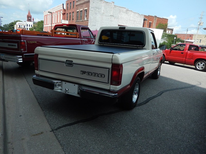

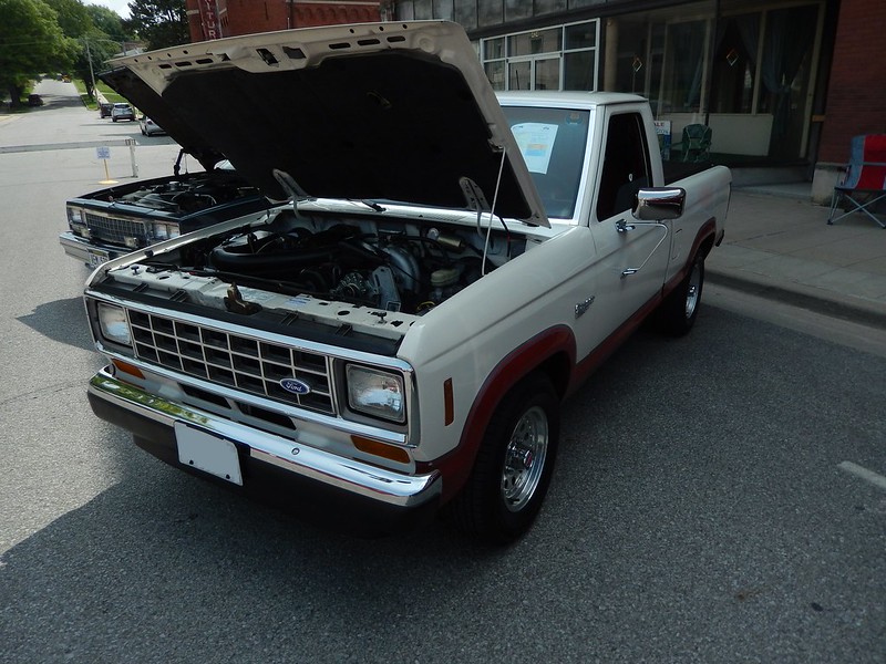

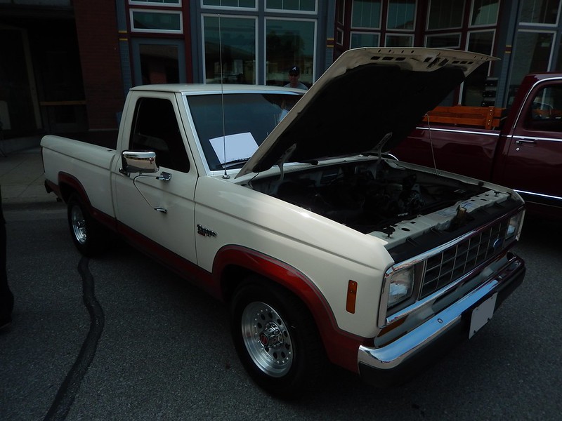

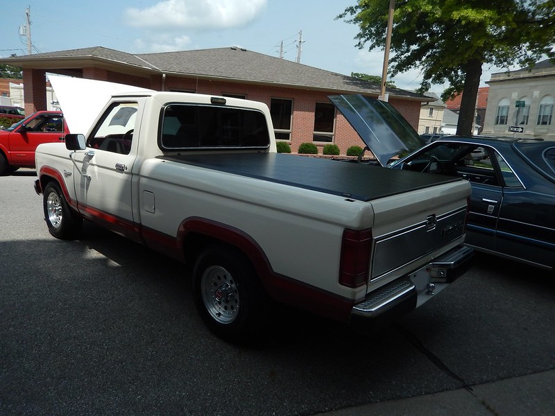

Attended 85_Ranger4x4's car club hosted car show today in rural Iowa. Very nice show in a great location. The country needs more town centers like it.
87 XLT - Factory Optioned Restoration
85_Ranger4x4 found his way to my Ranger.
And set up a Rangers 101 class. Everyone immediately associated him with Ford Rangers...he knows his stuff.
Mrs 85_Ranger4x4 was the trophy girl. Both good people. It was a good day.
Glad you had a good time. :icon_thumby:
BTW most of the people that I was talking to are customers, talked about a lot of things from a '56 Ford pickup to sump pumps.
It was very fun going over such a beautiful truck:

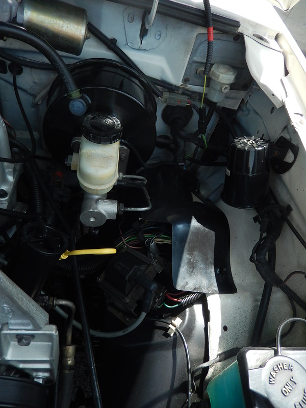

I had suspicions but the connector with two green wires is for the underhood light. I need to snag one sometime, does it time out or is it on full time? That could get me in trouble, my hood is almost up more than it is shut...
It stays on full time...hence, the negative battery terminal disconnected in pic above...thanks for sharing.
