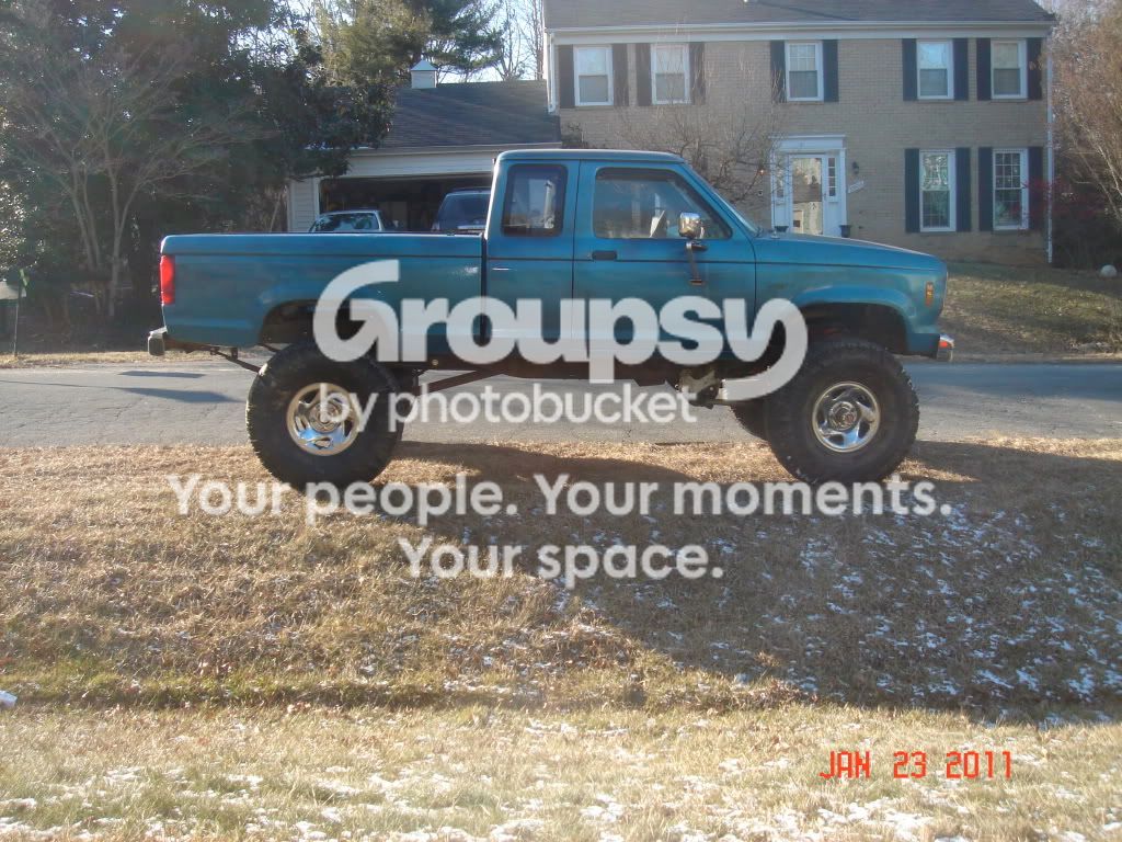

i was lookin through my old photos and found a picture of my daily driver like a couple weeks after i got it. haha
87 low budget sas
got further than i expected haha my buddies had tow straps so they talked me into it. haha

Looks bad ass!

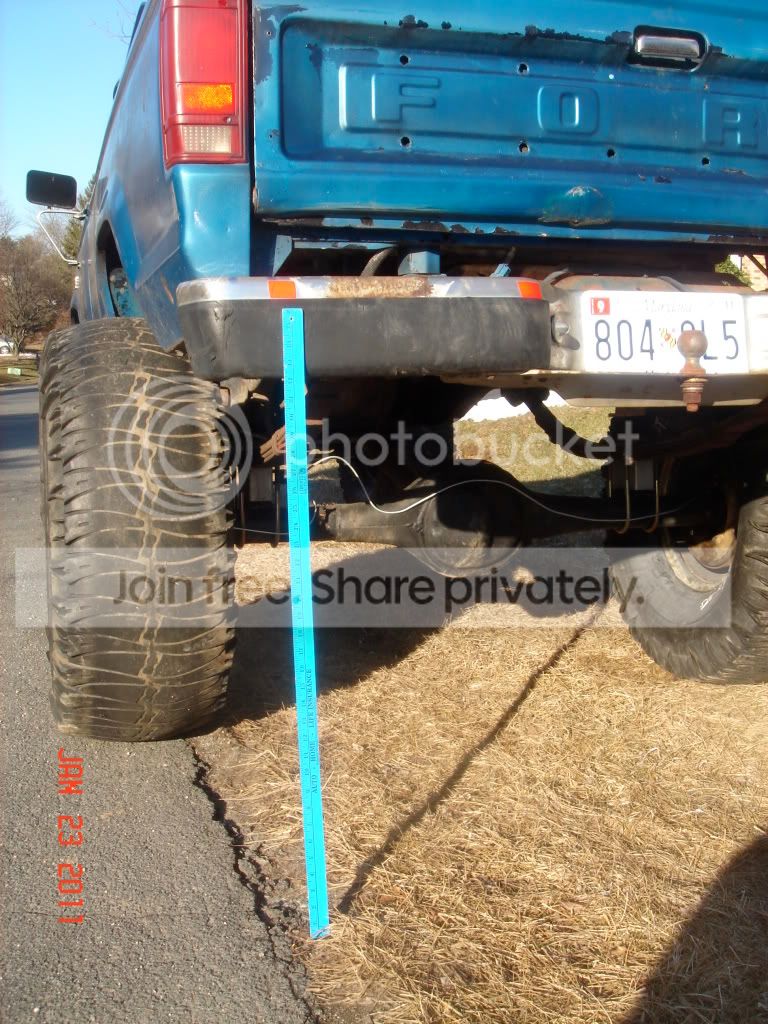

Couple things though....
That nasty rear brake line.... Please replace that. lol
The two that actually concern me both deal with the steering. You should really consider adding another tab on top of the steering, to help the bolts out.

Second thing with the steering, that track rod is in a prime spot for a nice stump or rock to dent it. (ask me how i know....) I am going to try and used 4130 Chromolly when i redo it, hopefully it will be stronger....
