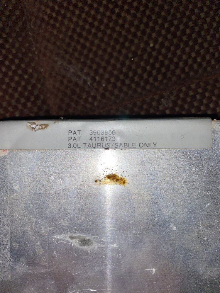

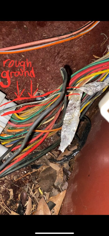

one of the grounds at the computer has no insulation and just looks fragile... i dont know if the previous owner did this but I attached a photo showing what it looks like. Also, one of the computers that these people left says 3.0L taurus/sable only? Is that an issue?

I don't know about the 87 model years, but when I look to replace my pcm, it is matched to the VIN. Anything else could result in issues.
Good luck with your fix. Others with more knowledge will be along to offer help.
follow and ohm the ecm grounds....the two near the battery often become disconnected or broken off.
iirc...pin 22 grounds the relay to turn the fuel pump on. make sure that ohms out as well.
