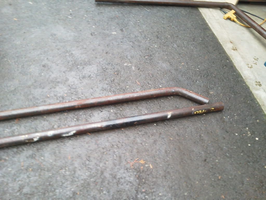

ya feel free to ask any questions and the stinger is off center a bit because the bender i used started to kink it on the left side. its more noticable in this picture but im not to worried about it.

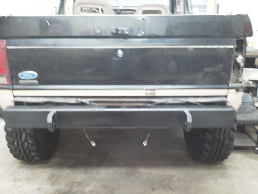

started on the rear bumper, still wana make a spare tire carrier

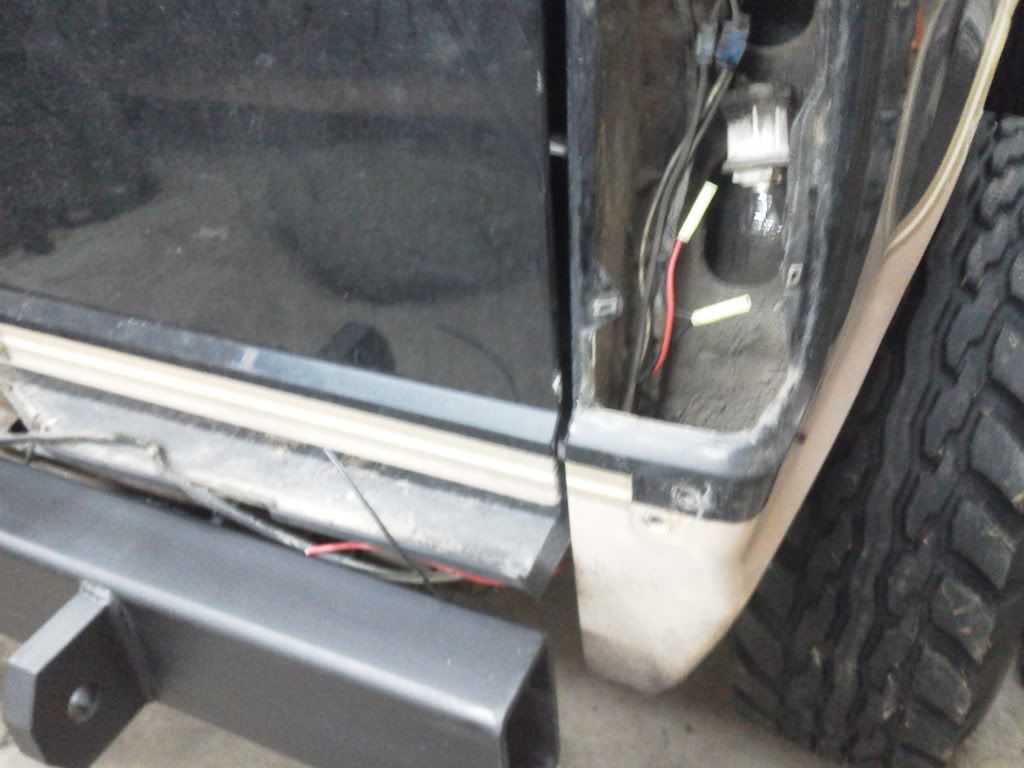

wired in the backup lights

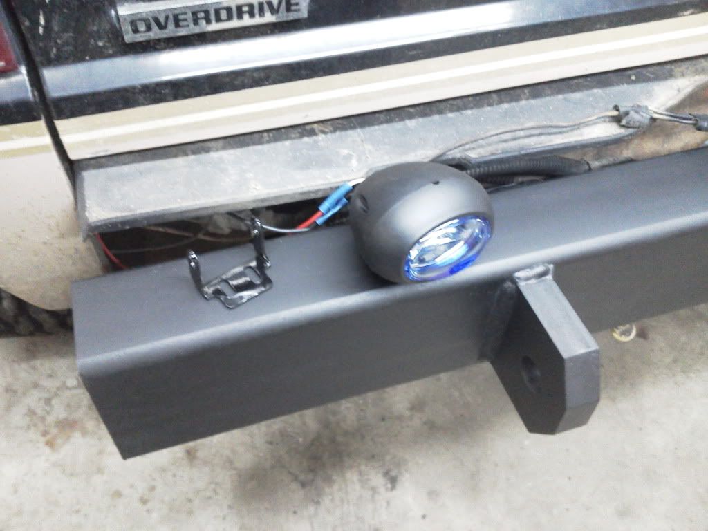

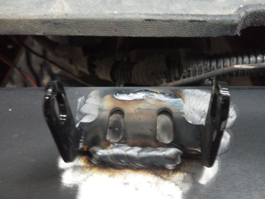

welded on light brackets

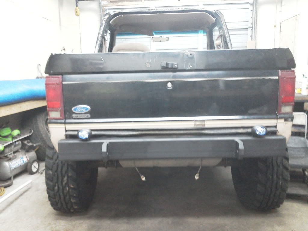

lights all mounted
87 b2 full width d44 and 9in
now on to spare tire mount

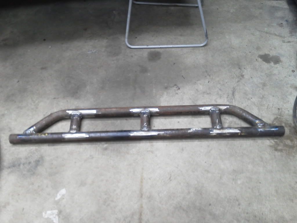

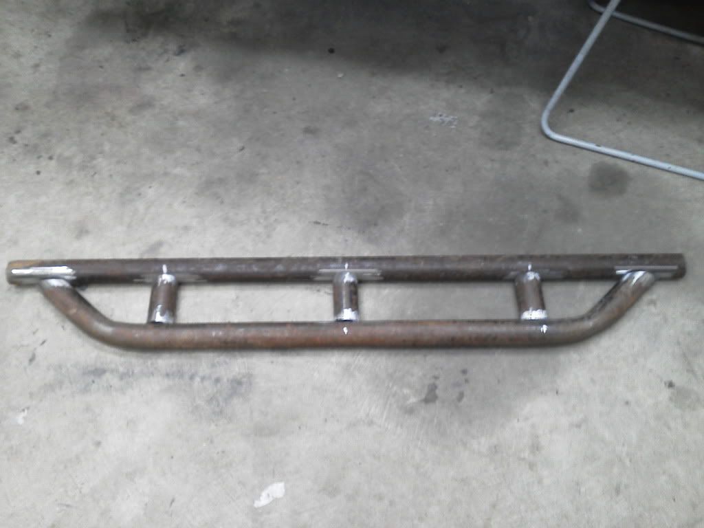

started making some rock sliders i almost have one side done
ready to be welded
all welded up now just need to make mounts to the frame
i think its 1 3/4 in .250 wall
