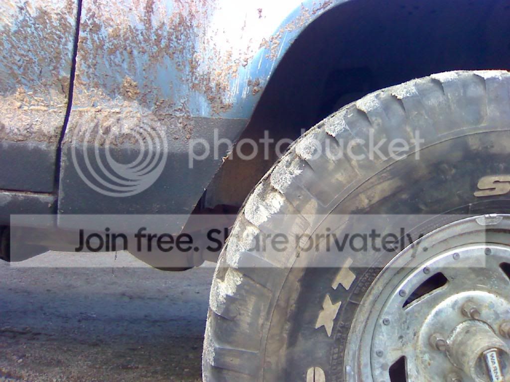

heres my 86 finally with 33's, using only explorer springs all the way around with a coil spacer and maxed cam bushings :headbang: :icon_hornsup: (i repeat no real lift, basicly stock truck)
there ya'll go
That looks great! I'm jealous. No lift at all? Good job man:headbang:
its lifted with heavier stock parts, and those particular 33's run small. wheel offset and actual tire size are huge variables
so after going to town and doing about 90 kph on the highway there and back with 3.73 gearing its not to bad deffinatly livable can still use 5th on the higway for cruising
