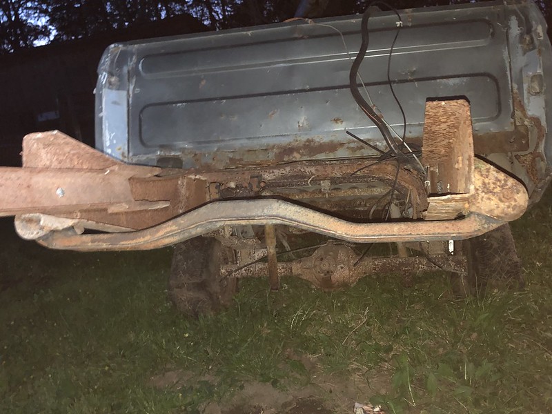

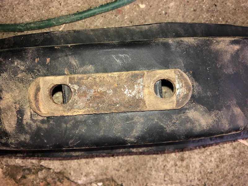

My '85 had the top one originally. Bottom one is out of a first gen Explorer.
My '86 parts truck (2.9 automatic 4wd)
All have different transmission heights too.
I had to do a little modification because my factory trans mount had different spacing than the Explorer mount. Explorer crossmember bolted into my '85 frame.

If those are 4 of 5. Then here is 5.
