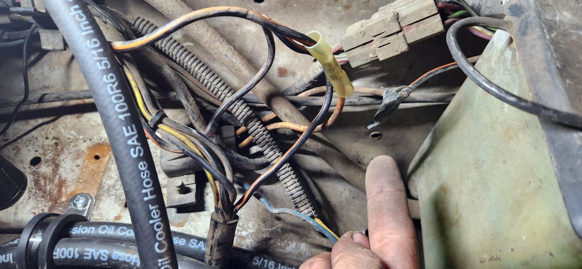

So the solid yellow wire that comes out of the firewall ties into the black and orange stripe wires at this junction, which is what comes from the B+ side of solenoid.
Along side it is a yellow wire with white stripe. That i dont see where it goes to immediately

You most likely have a AMP gauge on the dash, and that's the Shunt connection, the yellow/white wire also goes to alternator
Headlight switch also uses a black/orange wire with fusible link
Seems like Ford got a good buy on black/orange wire, lol
Plain yellow wire will be the one to ignition switch

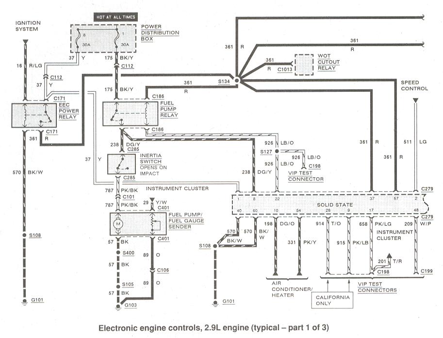

Should the red/lt gr wire in the, i believe, 8 pin connector be connected to B+ (through eca relay or not)?
Red/lt. Green wire comes from ignition switch and goes to the EEC(ECA) Relay's coil, it activates the relay with Key on
No connection to B+(alternator)
But there is another red/lt. green wire that may be on the starter relay's Battery post that runs to pin 5 on the Computer, memory full time 12volts
I have no idea of what connectors are what in a 1986
So the 2 yellow wires that come off the ECA relay.....where do they go and do they supply power to the body circuits possibly?
In the attached diagram, i cant tell how they end up in the power distribution box and dont know what/where the solid state deal is?
No, those 2 yellow wires in the diagram come FROM fuse 8, 30amp, in engine bay fuse box, they supply 12volt power full time to EEC relay and computer memory(not computer power)
When EEC relay is activated then that 12v power goes OUT on the Red wire(s) to power engine systems and computer
There are other yellow wires, one goes to ignition switch in the cab, its hooked to Starter Relays Battery positive post via fusible link, it power the cab electrics with key on
