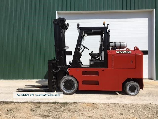

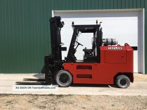

Thats badass lol.We had a 1993 Taylor TC250S that had a propane fed Ford 460. It kept overheating the old style ignition module so I swapped in a MSD 6al. The stamped valve covers had unstoppable leaks from years of over tightening, so I put a set of aluminum Ford Motorsport valve covers on it.
I don’t have any pics, because I haven’t worked there in 14 years, but here’s one I found on the Google.
