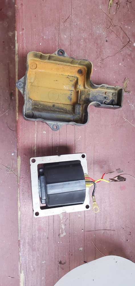

Got it running! Broke out the old multiple meter and had a buddy come over and show me how to use the damn thing (I hate electrical crap, witchcraft.. I tell ya) and we tracked it down to a bad ignition coil. The coil in the truck had no resistance? Infinite resistance? No continuity? I don't remember. Really.. I hate electrical stuff. I just don't get it. Life or death situation and I'd probably be a deadman. The bad coil looks brand new. No markings or numbers on it, probably the cheapest of chinesium.
Luckily I still had the distributor cap from my caprice sitting in the driveway.. full of water. Grabbed it, yanked it's rusty coil out, gave it a quick wire brush off and put it in the truck. Truck fired right over. Ran it through the gears real quick and parked it. Thing sounds wicked with open headers lol.. buuut definitely no more test drives until it has an exhaust. I really hate growing up.

I forgot to take a picture of the nasty rusty functioning coil... but as you can see from its cover.. bad lol. Also.. the no spark coil.

Yeah, open circuit on a coil is bad, hard to make a bunch of volts with that... it needs like 9-11k ohm resistance.
40k volts can't be produced if there is no connection in the coil.

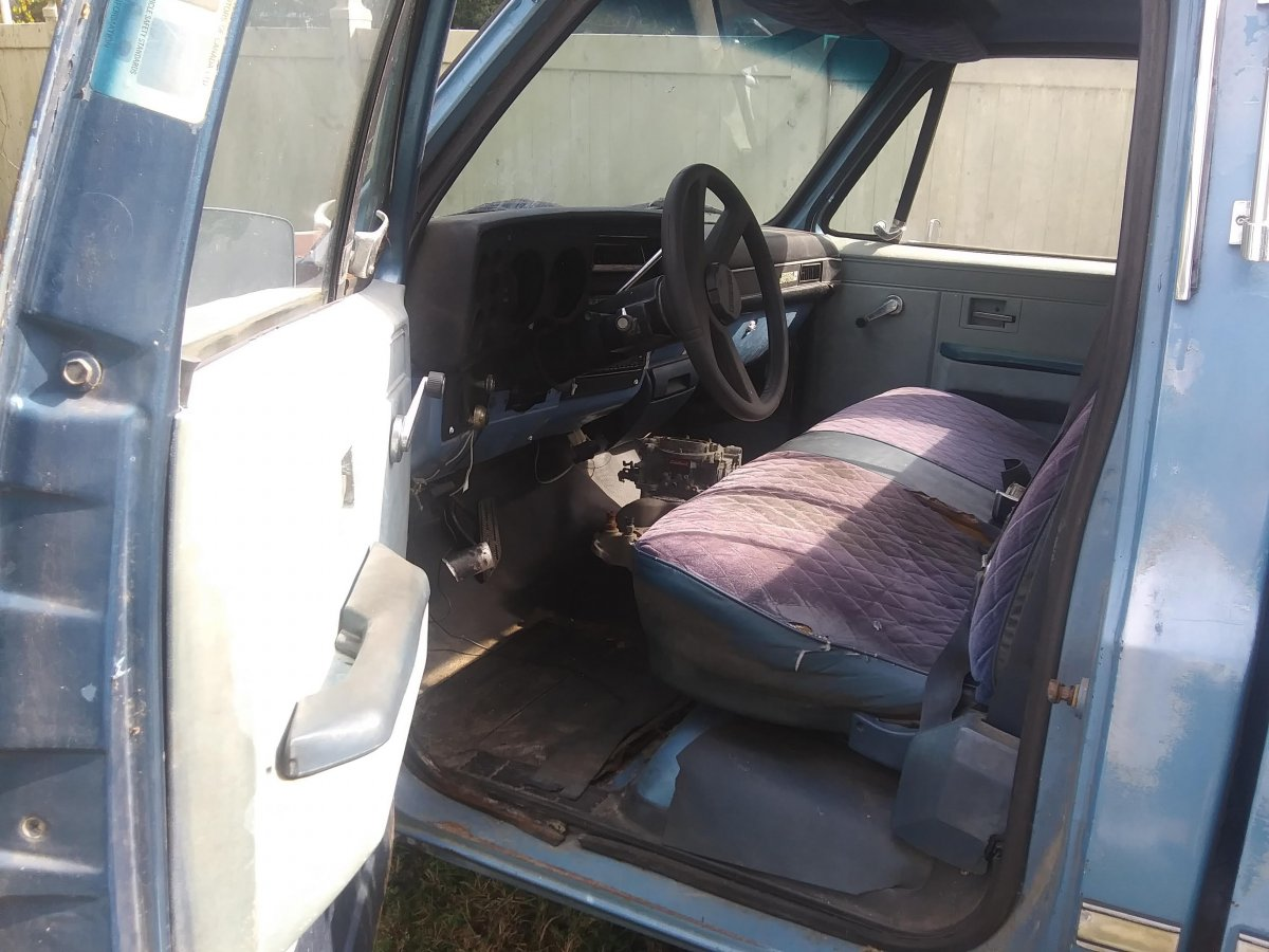

I didn't leave with just those though... while I was there, guy offered to sell me a pretty nice bench seat for 60$. Jumped all over that.. because all the other seats ive seen listed are complete crap and closer to 200$.
