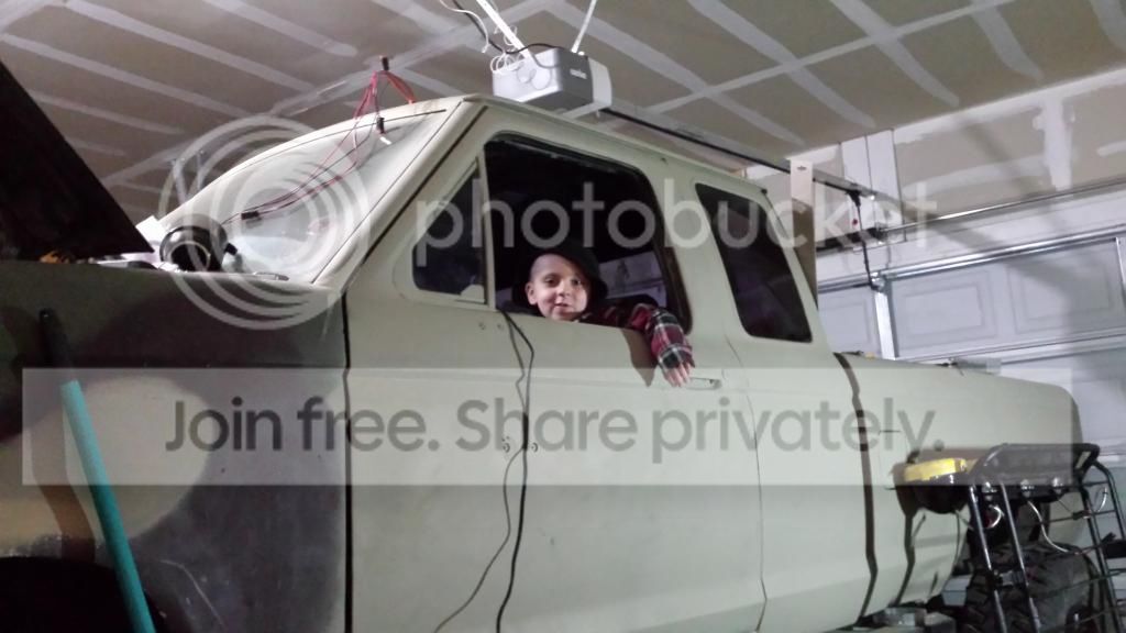

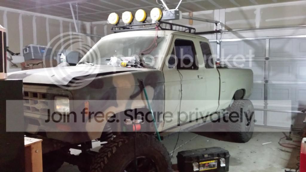

Got a ton done today. The boy wanted to play in the garage so I took advantage of it. Starter fixed, cb mounted, wires ran for the new lights, basket welded and lights mounted, 2/3rds painted the new color.....

looking good man!I like the new solid color, and the roof basket looks good!
Looking good! I like the solid color also.
