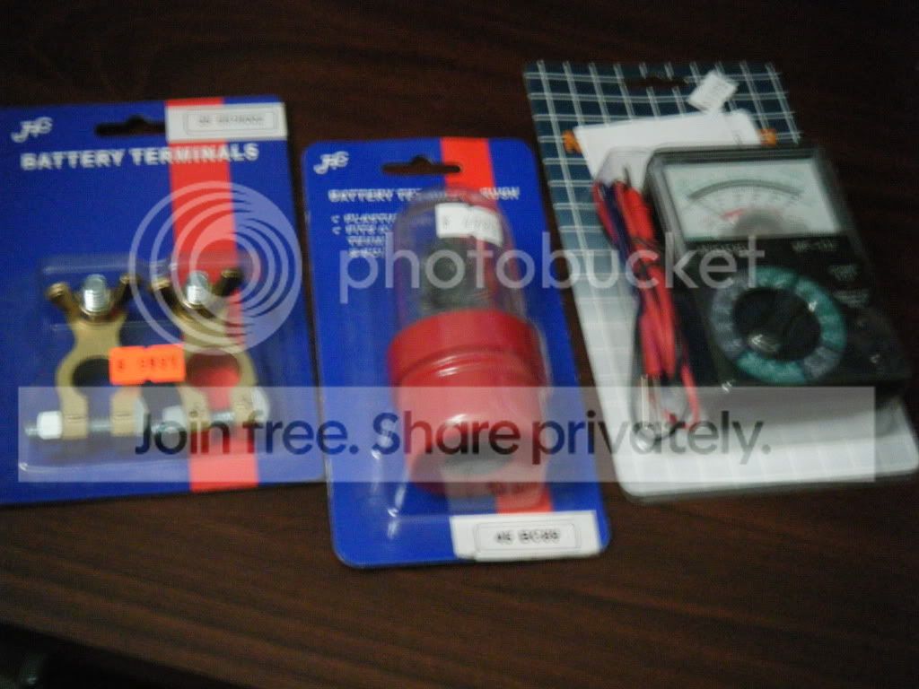

battery terminals, 2-n-1 battery terminal brush, voltage meter
total $30.04

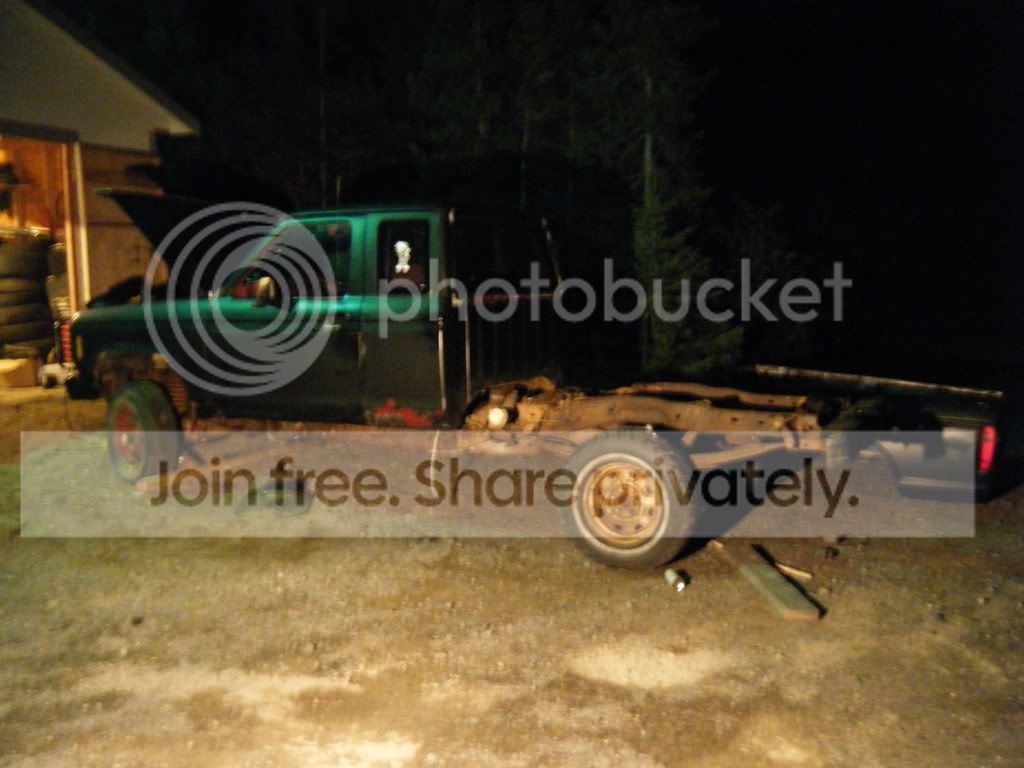

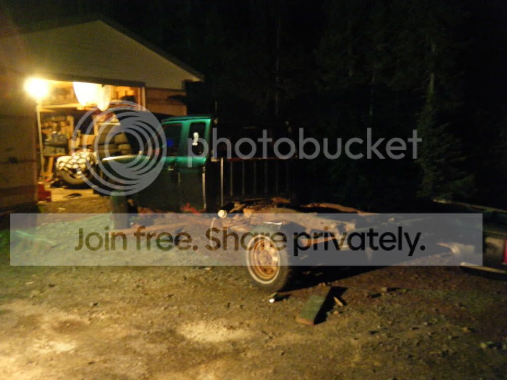

this is wat shes like now

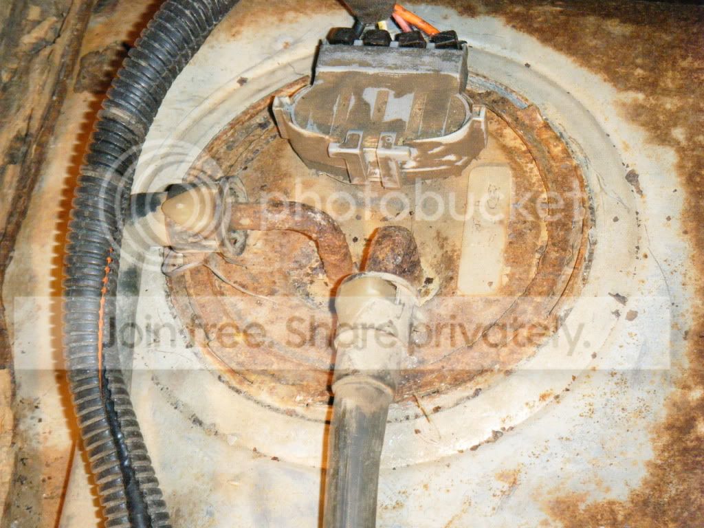

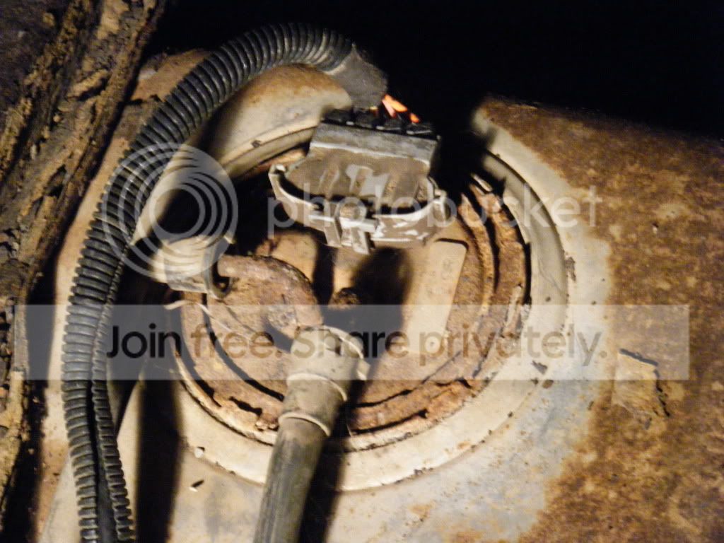

and jon heres ur pics
...real quick...dont ever hook up the battery charger to the starter solenoid like you said you did....ground for the charger always goes on the body....the neg post of the battery or somewere on the engine. if the starter just clicks when you try to jump it check the grounds going from the engine to the body/frame if there are none put some on. get the truck cranking under just battery power as in no battery charger. once it does that if you cannot hear the fuel pump run find out which wire is ground and which wire is power for the fuel pump. jump these wires with the charger or a spare battery and see if you get fuel. it sounds like the truck has no grounds and by the looks of it and the corrosion i can see them being gone.

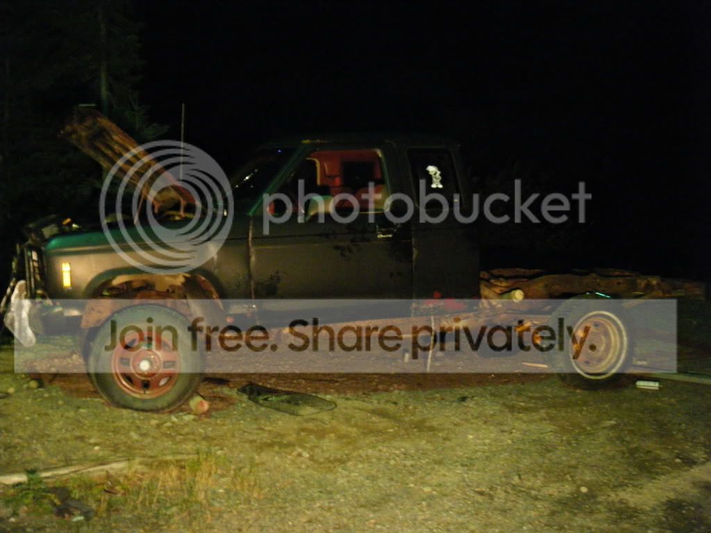

i went out today and lodged the cab back down on the frame and buttoned some of the wiring back together, i could wire it all back up becuse the manifold isnt on, and i had to look at the other ranger a couple times to see where the wires went but when the snow goes im bringing her bck up to the shed and we will see from there, for now i just wanna get the cab bolted back down
