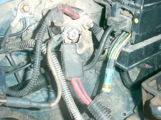

all the crank and pressure plate bolts are the same.use the block off plate from the tranny that u decide to run,but you might need to open up the starter hole a small amount.grab the jumper harness from the relay on the fender down to the MT 4.0l starter when you get one.the 4.0l clutch upgrade is well worth it and easy.the tech library has more info on it

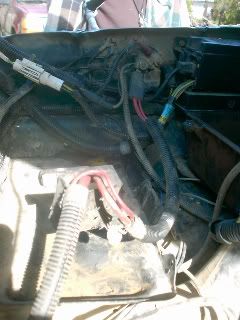

do you have a picture of the relay?

i wanted it to be factory but you can also move the starter hot lead to the left terminal(always hot) and run a smaller wire down to the solenoid from the right terminal(hot in start position) instead of replacing your positive battery cable.

so i need to get the jumper wire on the 4.0's starter solenoid? i don't really follow....

when i said i wanted it factory i was talking about the factory cable.
run constant hot to the starter and the little wire is the keyed power.i showed a pic of the factory cable but you can move the big cable on your truck and add a small one.if in doubt get wiring diagrams.
