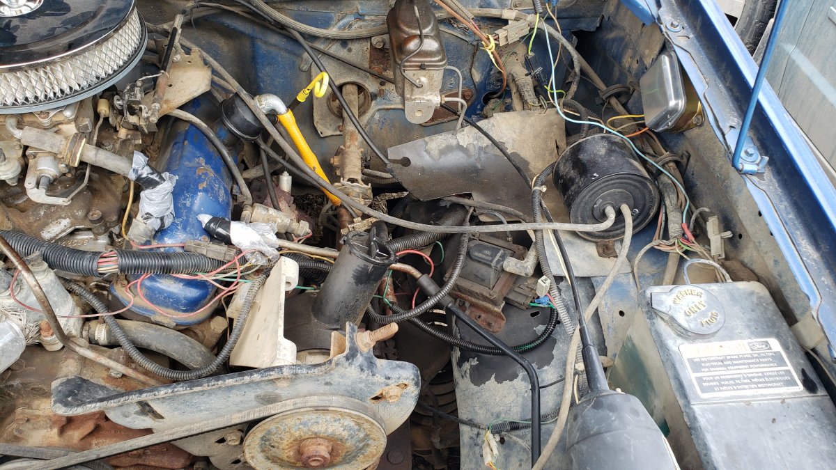

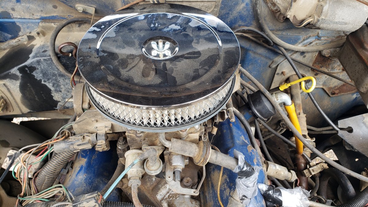

Hi Folks,
first time poster here with some questions about a 1985 ranger I recently bought. Under the hood is a real mess, vacuum lines missing or broken, various plugs / broken wires that arent connected into anything, stuff like that.
The truck is currently running (although not well).
-idle is very high.
-Ive got to pump the gas half a dozen times on a cold start, and even then sometimes it will stall out right away (even with manual choke on), and will stall moving into reverse or drive until it warms up. Sometimes upon touching the gas, it will stumble and almost stall before recovering and accelerating.
-truck seems gutless, even for a 35 year old 2.8l engine.
i want to switch to the duraspark ignition and non feedback carb as described in the tech section, but its such a mess under the hood, Im not even sure whats been done to it before and what would need to be done to work properly...
This was a farm truck for a long time and it seems like theres been a few farmer fixes over the years.
Here are some pictures to show you whats going on.View attachment 58378View attachment 58379View attachment 58380
Any help or tips would be greatly appreciated!
Kim
First you need to source the duraspark dizzy. Is there a three wire or a six wire harness going to the distributor? If the computer is still in control of the ignition it will never run good. It needs all the inputs working for advance to work properly. The distributor is getting much more difficult to find any late seventies pinto, Capri or mustang two with the 2.8 would have everything you need if it has not been stripped. Anything with a carb usually goes directly to the crusher unless you get real lucky with a barn find somewhere. If it has the three wire distributor your in luck you have two options duraspark or HEI module.

Yeah, the junkyards ive called or visited basically have nothing that old. Except for old f150s...a lot of those for some reason.
